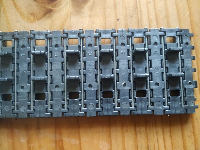

"Tracks are good quality." LOL Most of them poorly designed with open pins that breaks on the first run outside the salon. Also have you seen the price? For what they cost I can buy a full chain for my 1000cc racing honda motorbike. Is this quality? Notice the open air pins, and the tracks are joined together with like 2mm of thin plastic, that of course, breaks.
