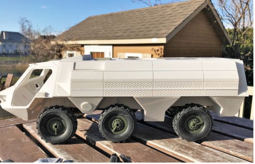

Continuing with the buildup of the main hull components, without the fine details that will be added only later because these details would be damaged during the heavy building phase.

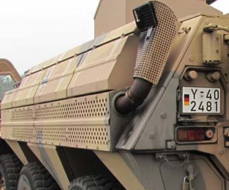

As seen in these great detailed pictures from http://www.panzer-modell.de, the TPz-1 A8 is equipped with add-on armor all around and side bins that makes it a very sleek, modern and interesting vehicle.
RC 1/16 TPz-1 A8 Fuchs 6x6 Transportpanzer build
As the add-of armor covers much of the vehicle sides, the area that will be visible from the top under the bins is given plasticard sections to simulates the armor plates, there is no point covering the whole area under the bins.

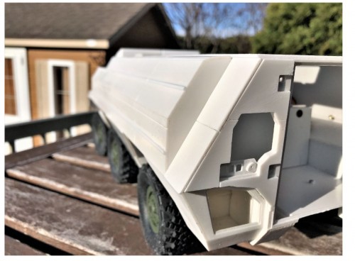

Thankfully, Ludwigs Modellbau provides parts for the A8 side bins and most add on armor plates that would be quite difficult to replicate from scratch. They are a lot of work and good references are needed to make them accurate. Notice the add-on armor on the lower hull sides in the front and middle section between the road wheels.
They have a lot of details and are not easy to assemble. The left side has the whole lower area covered with ventilation holes for the exhaust pipe that runs under it from behind the cabin all the way to the back.

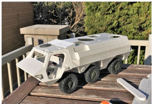

Re: TPz-1 A8 Fuchs 6x6 Transportpanzer - Bundeswehr - Build
Posted: Wed Apr 29, 2020 11:55 pm
by lmcq11
Hi, continuing the build
In the planning stage, i noticed these WPL C-34 Jeep tires that seem to be a close match to the required Michelin 14.00 R 20 XL18 seen on the fuchs. I purchased a lot of 12 of these tires and wheels for the ridiculous low price of $15 on ebay, shipping included... They arrived today.
There are 4 types of tires seen on Fuchs. My idea was to match the Michelin seen on the top right. .
I was happily surprised that the WPL Jeep tires are a perfect size match, exactly the extra 5mm in diameter that i was looking for. The tread style is also quite close to the Michelin.
The issue is that these tires fit a different wheel, the Jeep tires do not fit the B36 wheels. I therefore had to use the Jeep wheels and remount them with the previous extensions that were on the B36 wheels. I followed Painlesswolf's suggestion to cut the rims and create a streamlined drum like extension. I also took the opportunity to add a 4mm thick plasticard ring that brings the extension to 19mm on each wheel. It will fit better the axle width i have seen on the Fuchs. Now it is the wheel itself that does not match the Fuchs pattern. I will try to find a proper overlay to apply on top.

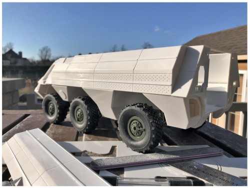

This is the right side of the Fuchs. Be aware that the Ludwig module needed a rework of the frontal bin area to match reference pictures.
The Fuchs with its new tires and right side bins.
Close up of the front bin. It's not perfect but it closely match.
The width of the axle are wider and looks better now.
View of the bins from the top. The mounts for the bins that connects to the hull had to be reduced in size in order to avoid too much gaps between the top cover and the hull.
The vehicle as it stands today.
Regards, Louis
The guards on the AFV-Model plate are not reproduced correctly. When trying to gently reposition them by folding the metal, they just broke. They had to be replaced with brass rods. They were annoying and it took longer to use these purchased parts than scratch build them.
The headlight area is finished with additional details.
Notice the extra small armor plates behind the head light, it need to be scratch built through eyeball.
This is the AFV_Model blinker seen on most German vehicles. I liked this one, finally.
Continuing on following post.

The blinker is installed on its small pedestal behind the front door. A small guard need to be reproduced on top, in brass.
This is the model today. The LEDs are getting their last testing before moving on to something else.
Next step, the front doors.
Regards, Louis
