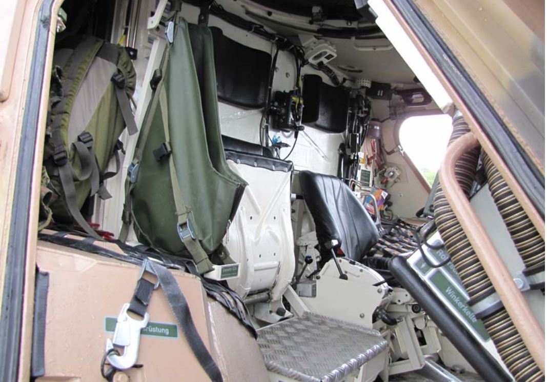

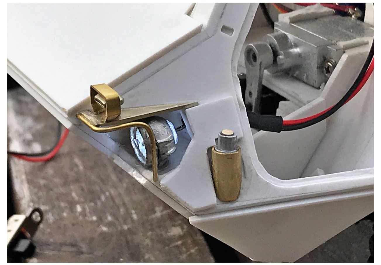

The interior of the cabin is equally complex. But my TPz-1 will have windows so I will probably at least try to build something interesting to look at when the doors are opened and interior lights are on.
RC 1/16 TPz-1 A8 Fuchs 6x6 Transportpanzer build
I do have the clear parts for the windows.

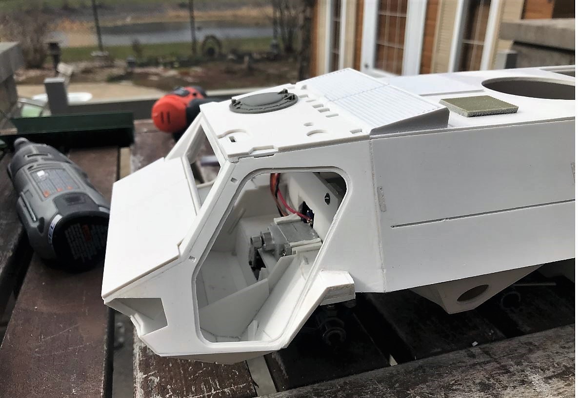

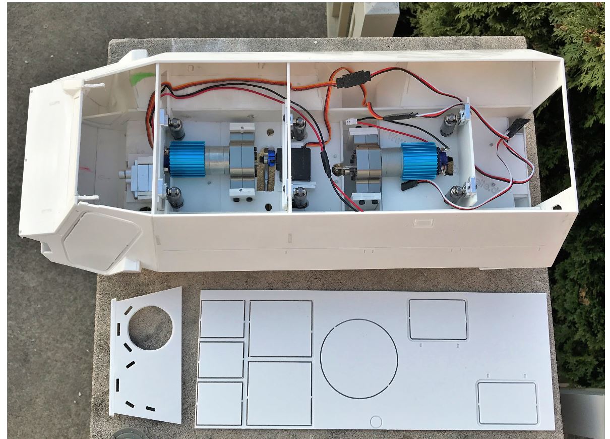

Excellent access to the interior electronics and the FLW-200 station are provided by removable front cabin and hull top sections.

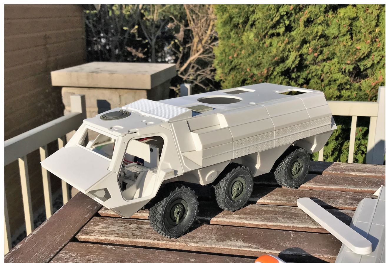

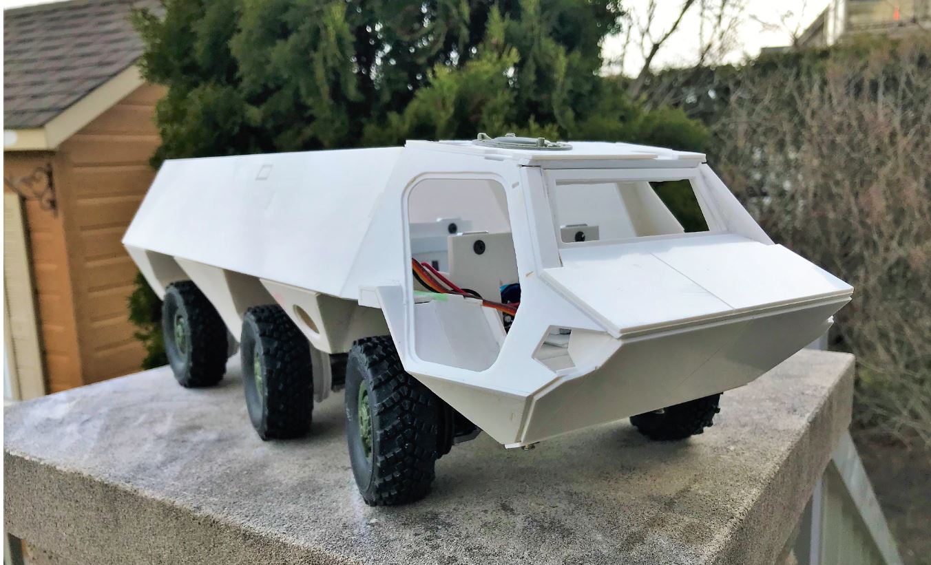

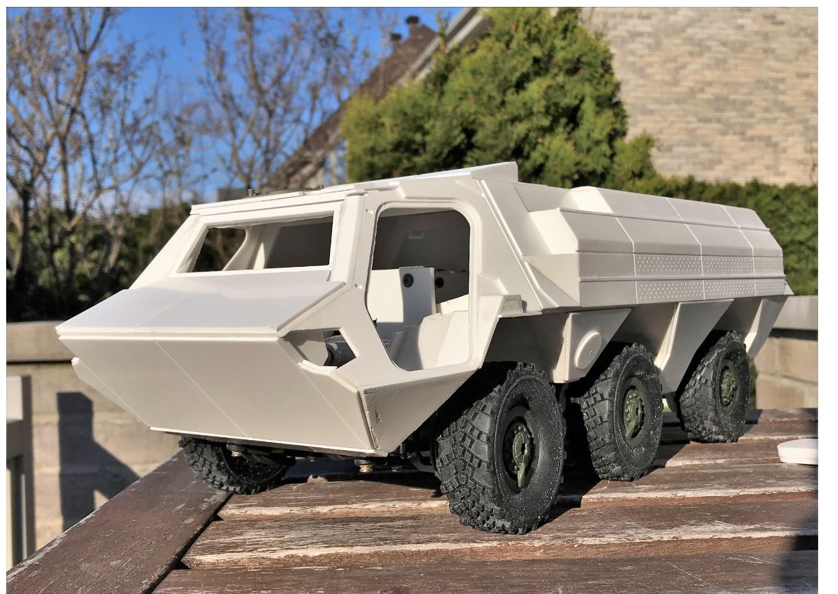

The model as it stands today
Next step is to continue to building of the main hull and the add-on armor plates.
Regards, Louis

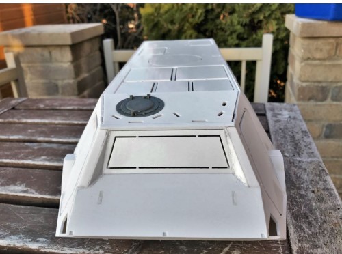

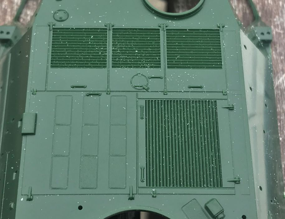

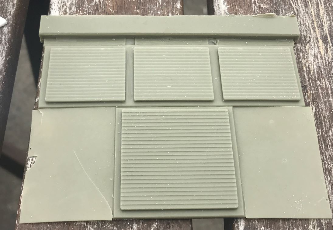

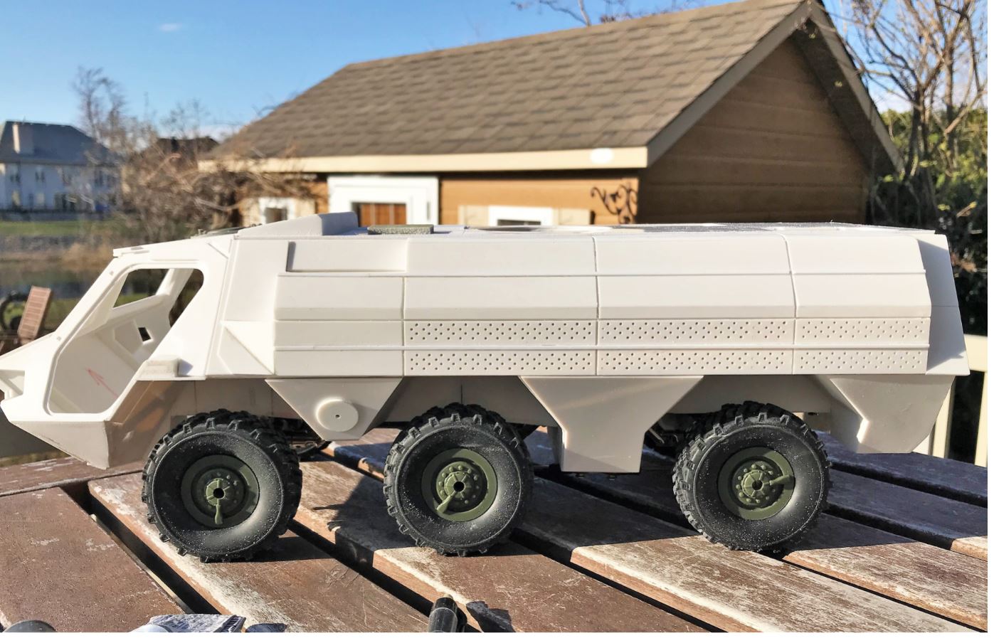

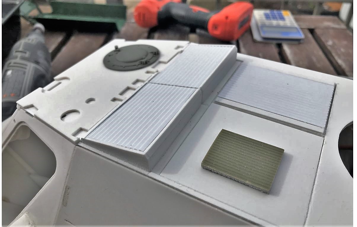

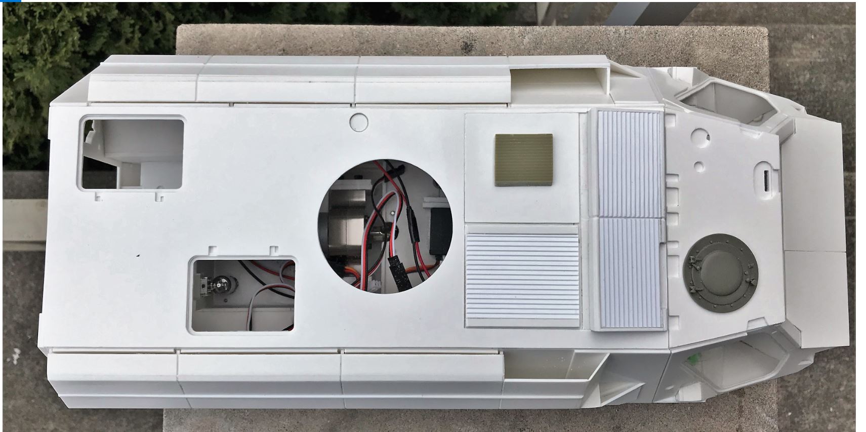

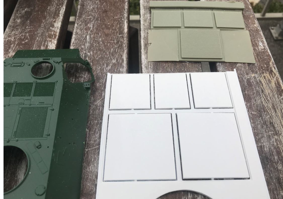

Continuing the hull buildup, the engine grills
The engine grills have never been a strong area of a Ludwig base kit. They are usually of the wrong dimension and extremely basic. Although an earlier Fuchs version, i thought the 1/35 Revell Fuchs would provide me with accurate dimensions and placement.
I purchased AFV-Model resin Fuchs grills thinking they would provide a good replacement for the Ludwig parts.
It did not take me long to notice that the whole thing is wrong. None of the three compares to each others. And the AFV-Model grills do not fit the Ludwig slots and the larger grill dimensions are not right.

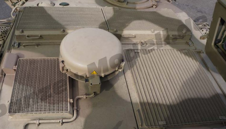

Then after some research on http://www.panzer-modell.de, it became apparent that the A8 version has new air filters setup on top, a small planning error on my part. The Ludwig Fuchs A8 version kit sprue do not have any parts for them.
I still glued the provided Ludwig parts in place, mainly to fill the wholes and provide a base for the new air filters.

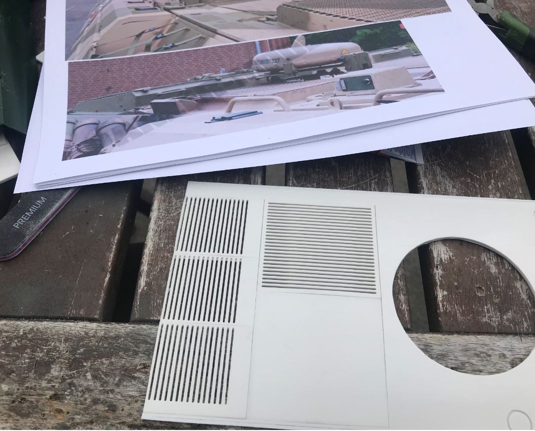

Few good pictures exists of the Fuchs grills, all I could find are partial shots. I extrapolated and created a base for the air filters.

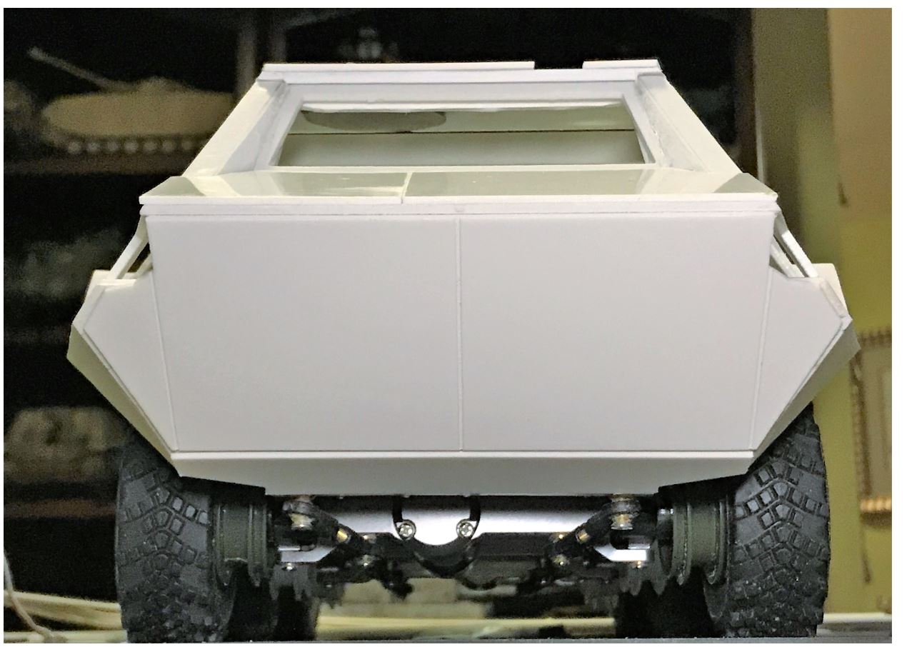

The Fuchs A8 version has extra armour around the vehicle, some parts are provided, some are not. The add-on armoured plate for the roof of the cabin need to be scratch built. Many dents need to be made to make room for the air filter hinges.

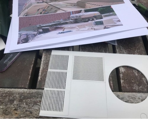

The main grills and air filter parts are made and put in place. JTT 97413 Clapboard Siding plasticard is used to simulate the angled grills, a leftover from the Centurion build. Notice the extra armored plate on the hood. The resin hatch is from AFV_model and is a good placement for the Ludwig parts. The A8 air filters are in two sections, not three.
The grill are still work in progress, requiring handles, hinges and mesh.

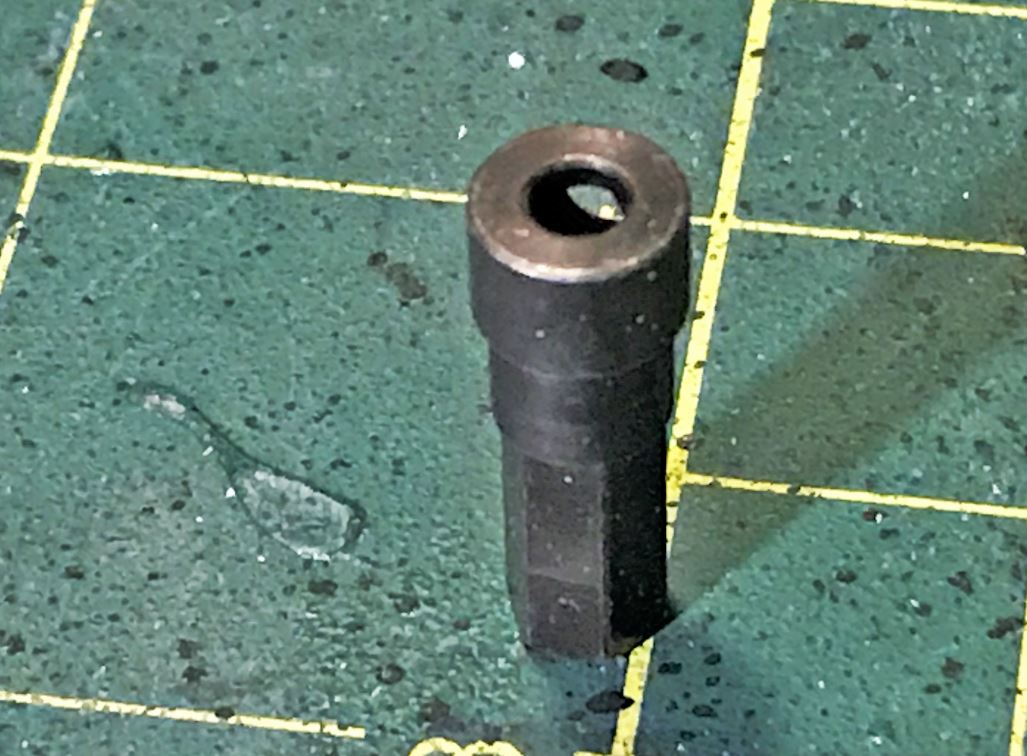

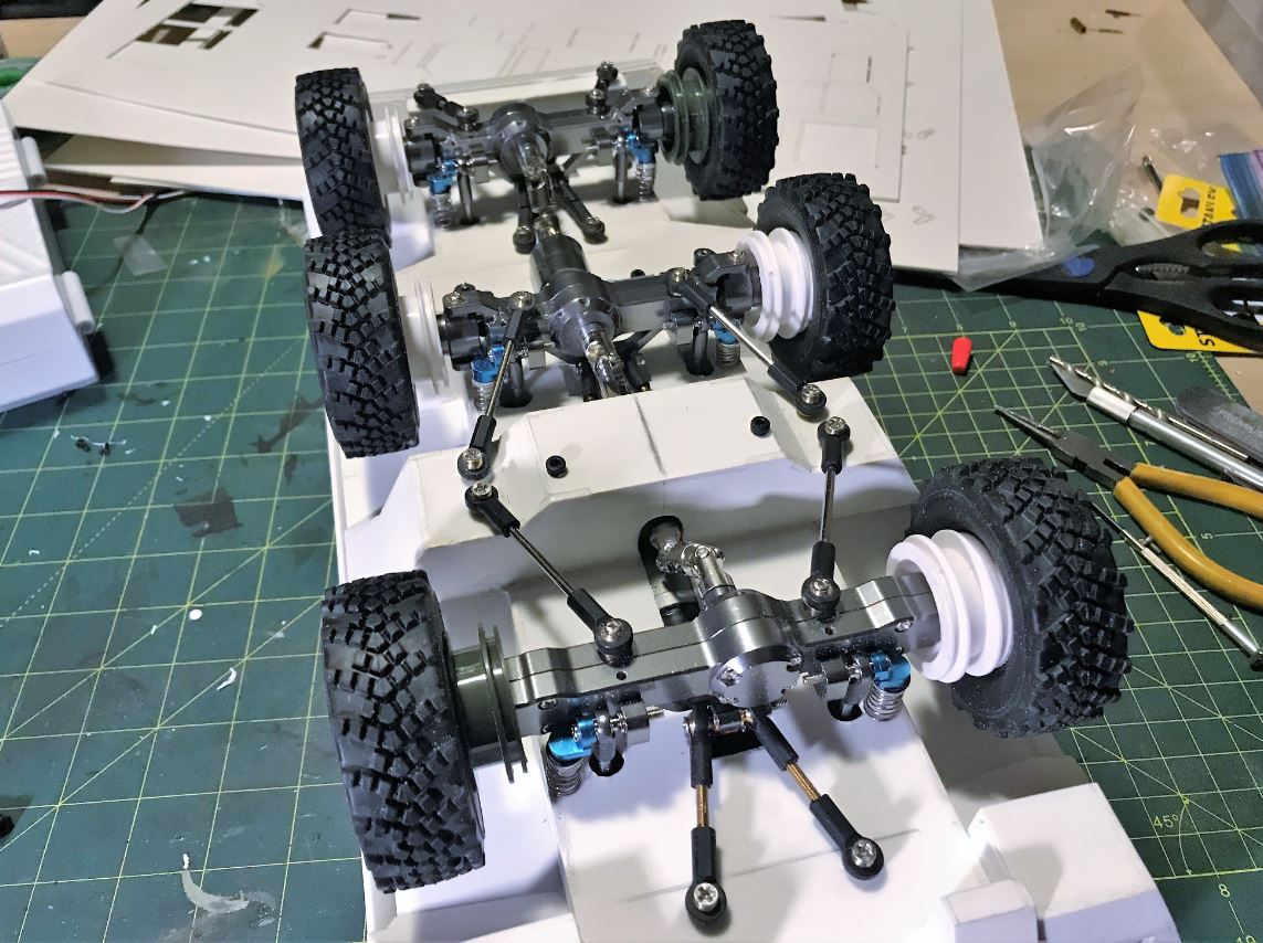

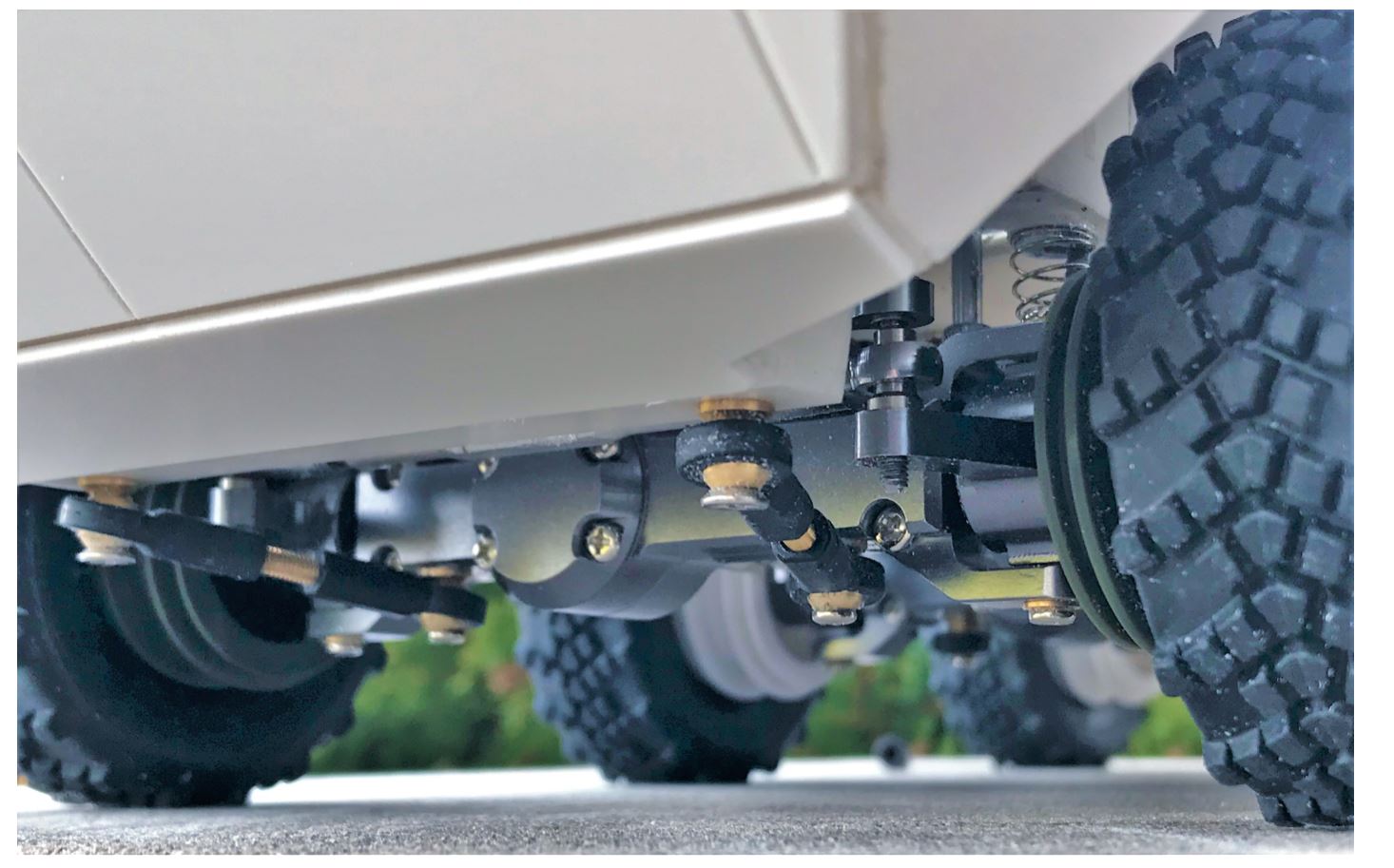

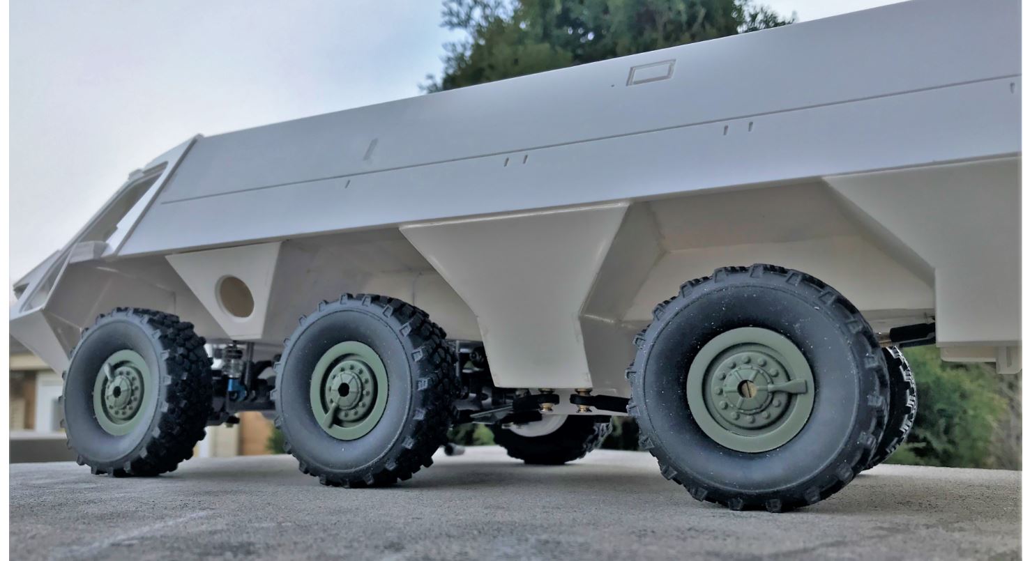

Time to put wheels and tires on the Fuchs.

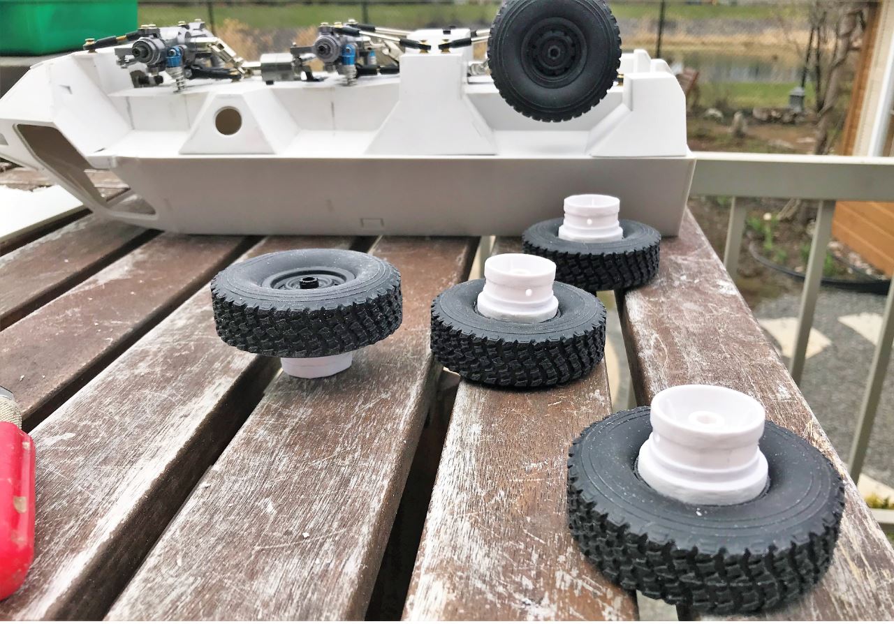

After receiving the shaft extensions that i had ordered, i determined they cannot be used in any arrangement. These are made to fit into a 3mm round shaft. They will be of use in some future build where i will need to connect WPL wheels to a DIY axle arrangement but not here. After further study, I also determine the extension required to the WPL axles need to be between 15 and 20mm on each side. That's a lot.
Time to execute Plan B.

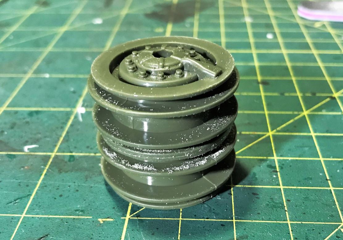

Plan B is a simple and cheap plan to glue two regular WPL wheels together for a 15mm extension on each side.
Six wheels are prepared using residual WPL wheels I had in storage.

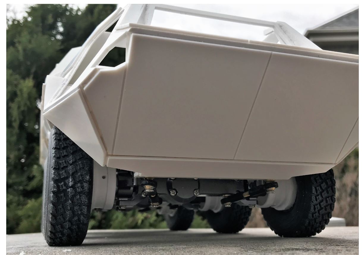

Quickly installed on the Fuchs.
Looks could be improved but clearance is good, including steering.
Notice Fuchs A8 add-on armor on the front hull.
I think my objectives of creating an affordable and effective drive train for the Fuchs build are met. In all, the cost of the whole drive train is less than 200$, shipping included, for all the items; Axles, motors, gearbox, drive shafts, pull rods, dampers, shock absorbers, mounts, wheels and tires. Alternatives to use German made specialized items I saw on the web would have been prohibitive, adding up way above 1000$ for similar metal components, and probably a lot more complex and risky.

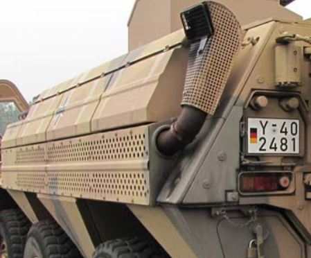

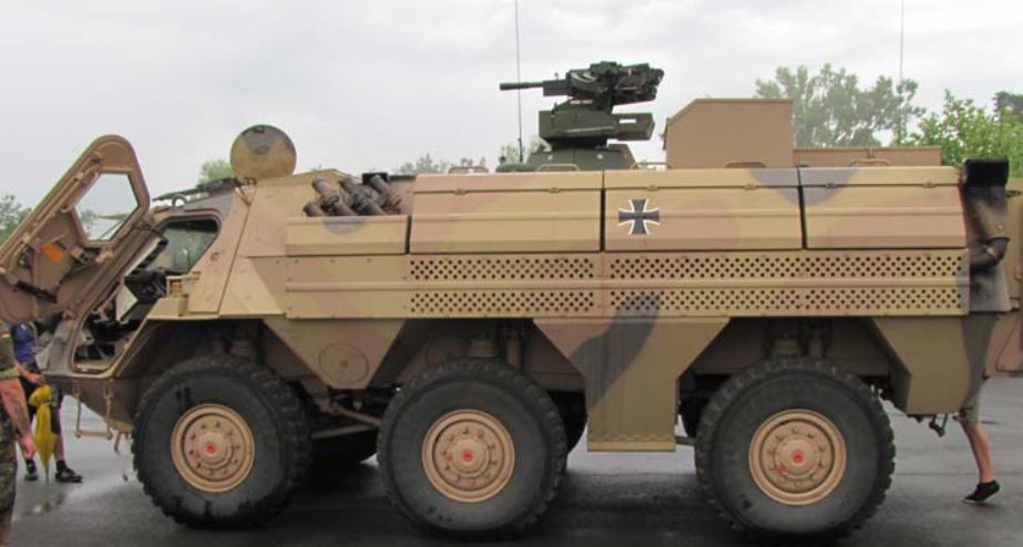

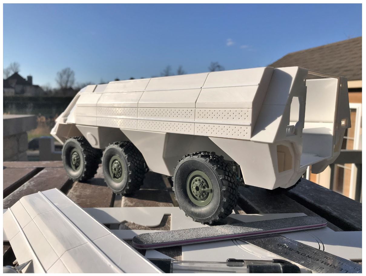

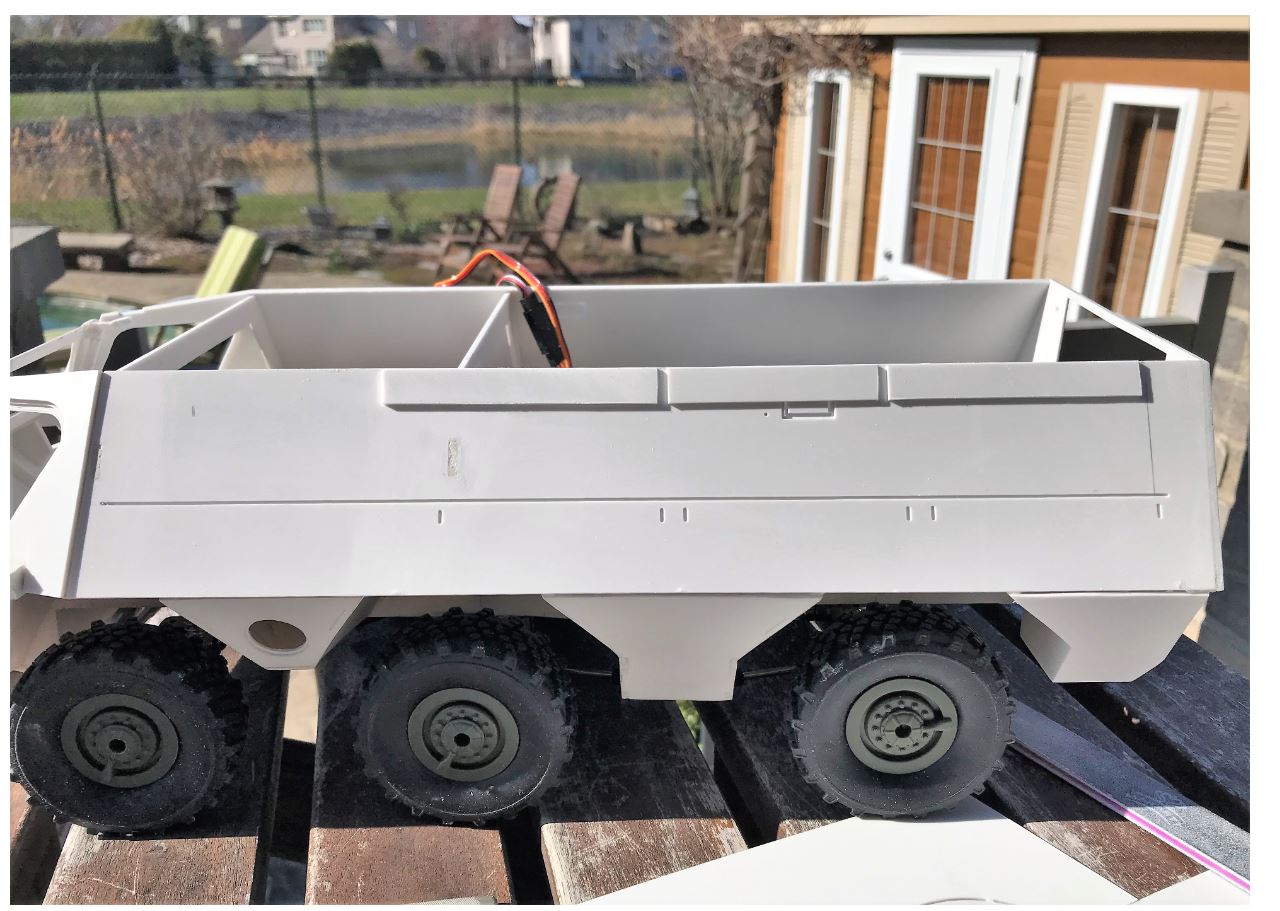

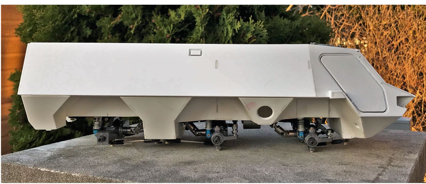

Continuing with the buildup of the main hull components, without the fine details that will be added only later because these details would be damaged during the heavy building phase.

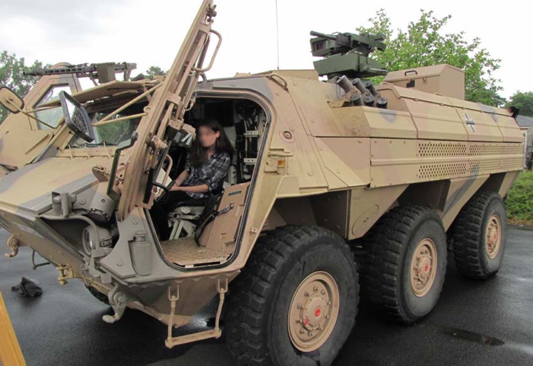

As seen in these great detailed pictures from http://www.panzer-modell.de, the TPz-1 A8 is equipped with add-on armor all around and side bins that makes it a very sleek, modern and interesting vehicle.

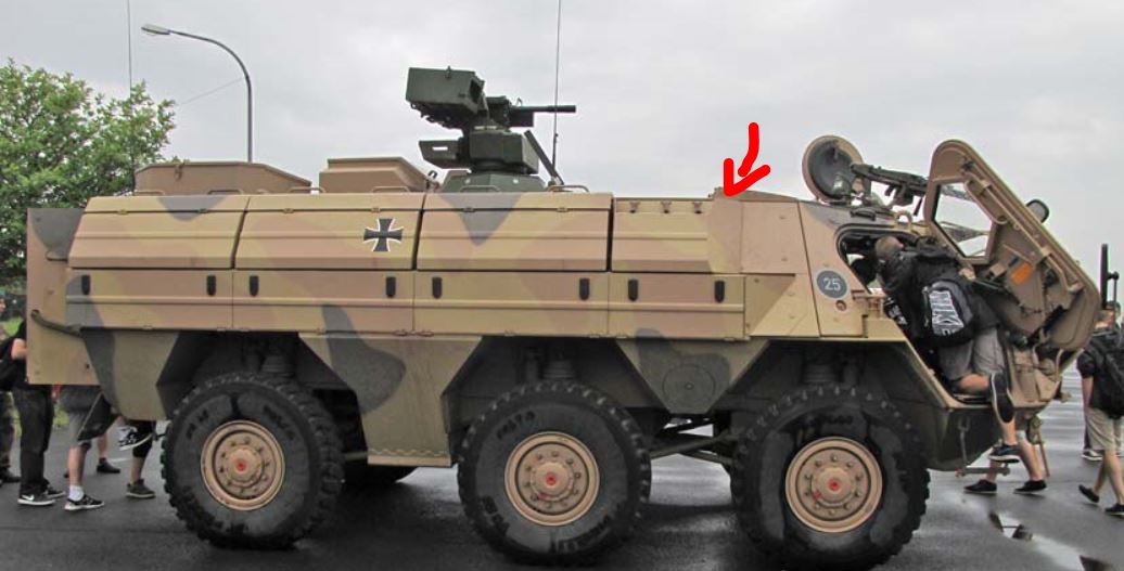

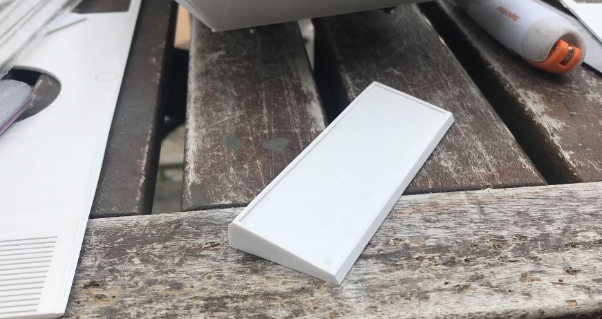

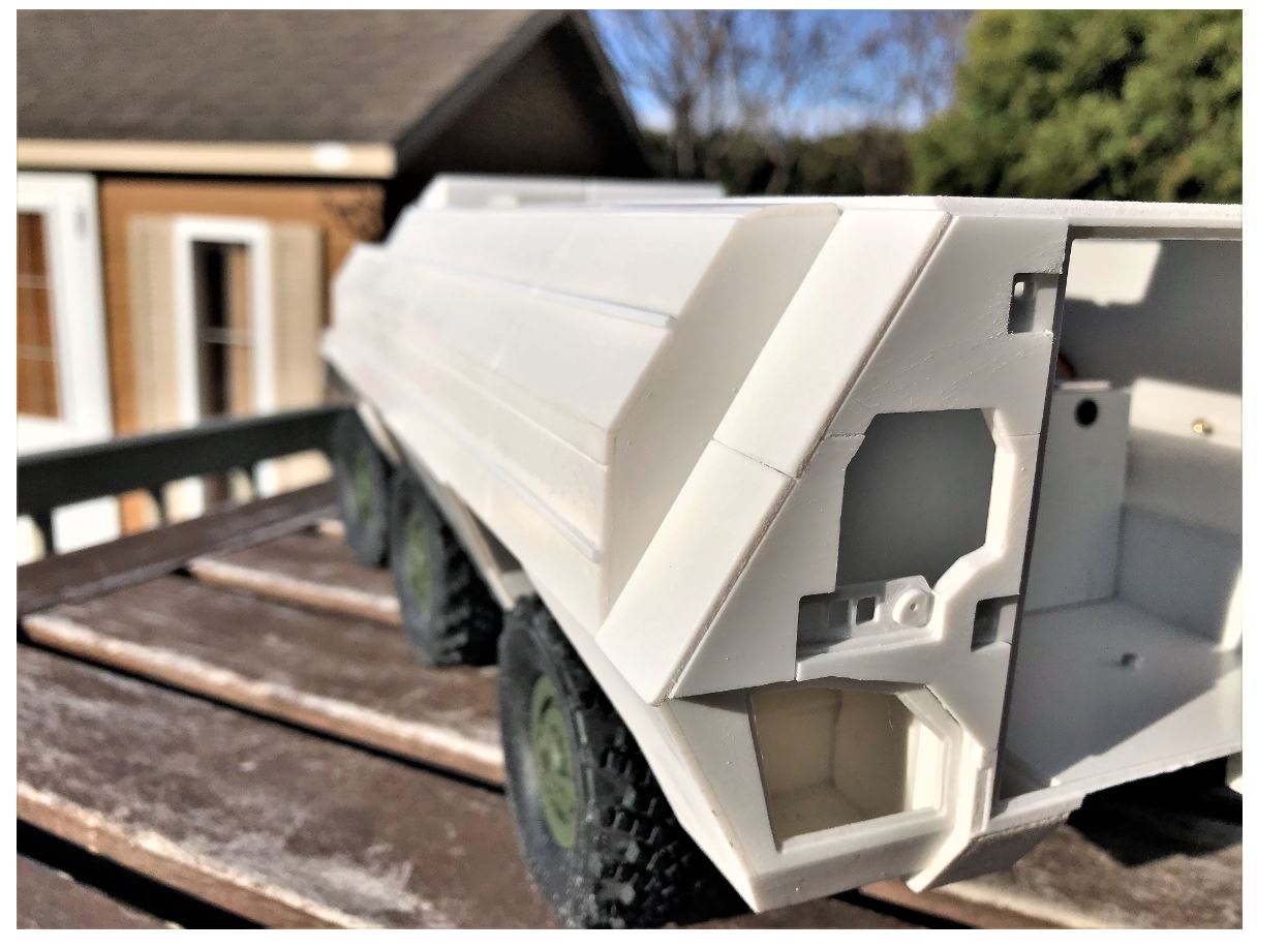

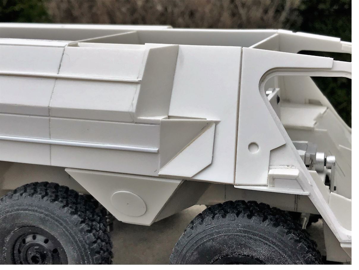

As the add-of armor covers much of the vehicle sides, the area that will be visible from the top under the bins is given plasticard sections to simulates the armor plates, there is no point covering the whole area under the bins.
Thankfully, Ludwigs Modellbau provides parts for the A8 side bins and most add on armor plates that would be quite difficult to replicate from scratch. They are a lot of work and good references are needed to make them accurate. Notice the add-on armor on the lower hull sides in the front and middle section between the road wheels.
They have a lot of details and are not easy to assemble. The left side has the whole lower area covered with ventilation holes for the exhaust pipe that runs under it from behind the cabin all the way to the back.
Here, you can see where this is going. I find the Fuchs A8 to be a very beautiful vehicle.

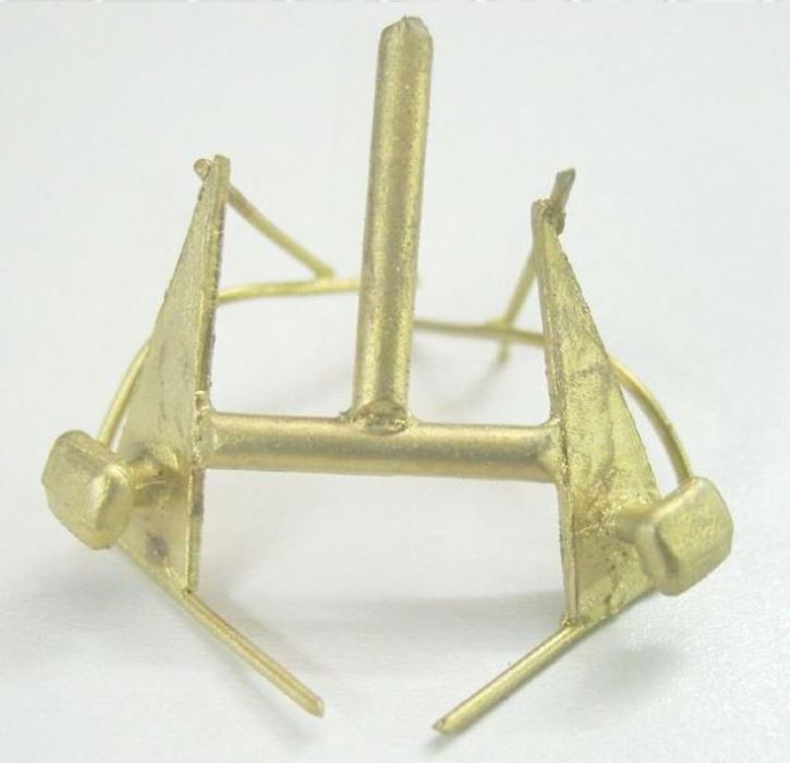

Thankfully, AFV_Model sells a resin and photo-etched model of the Fuchs exhaust stack and it will add a lot of value to the model and will be interesting to make. Noticed the overlapping armored plates at the back and the mounting screws.

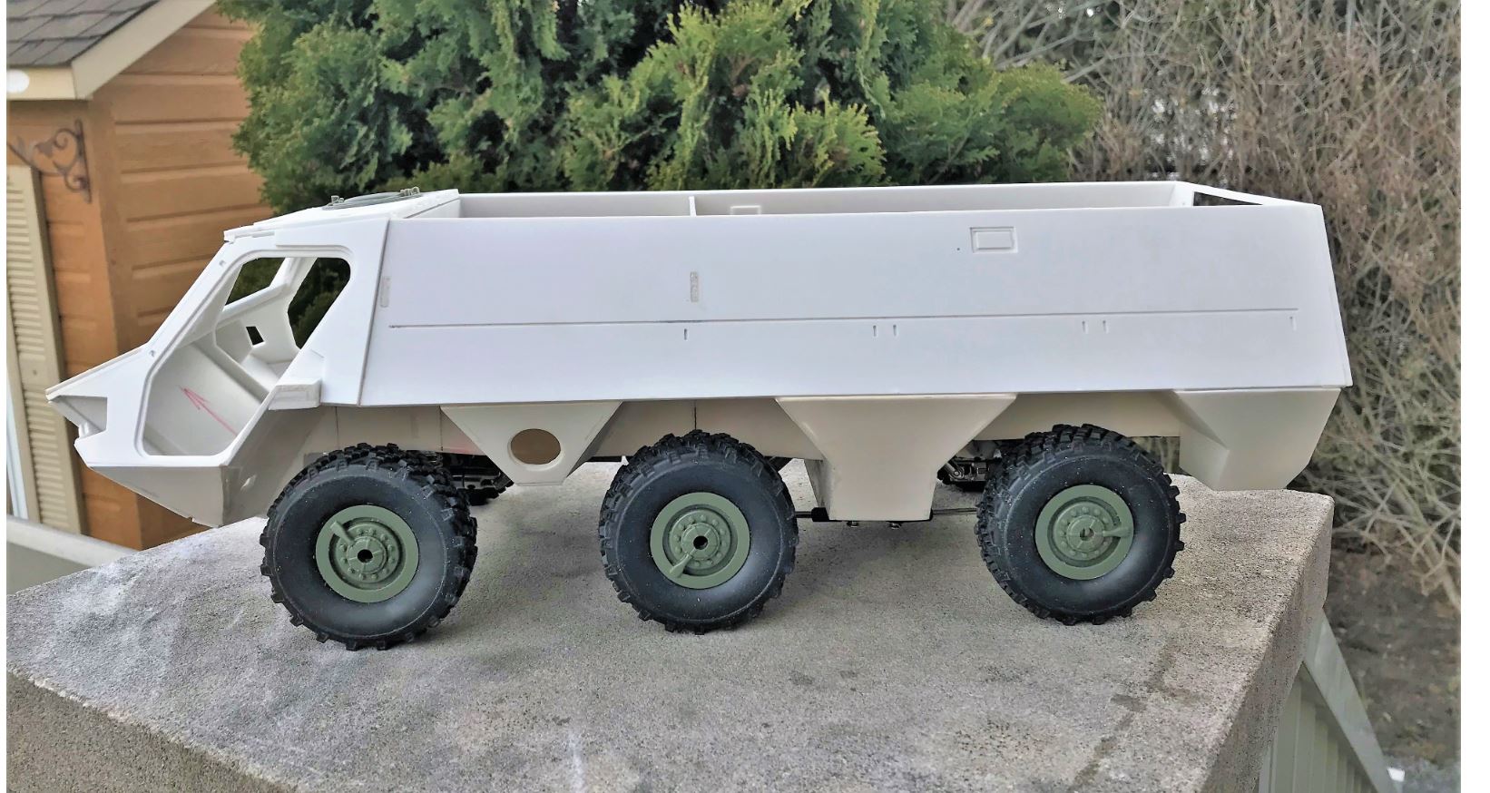

And how the Ludwig build compares so far. It should be a good looking Fuchs. I ordered some other tires from the web, i will determine if they are a better fit when i get them.

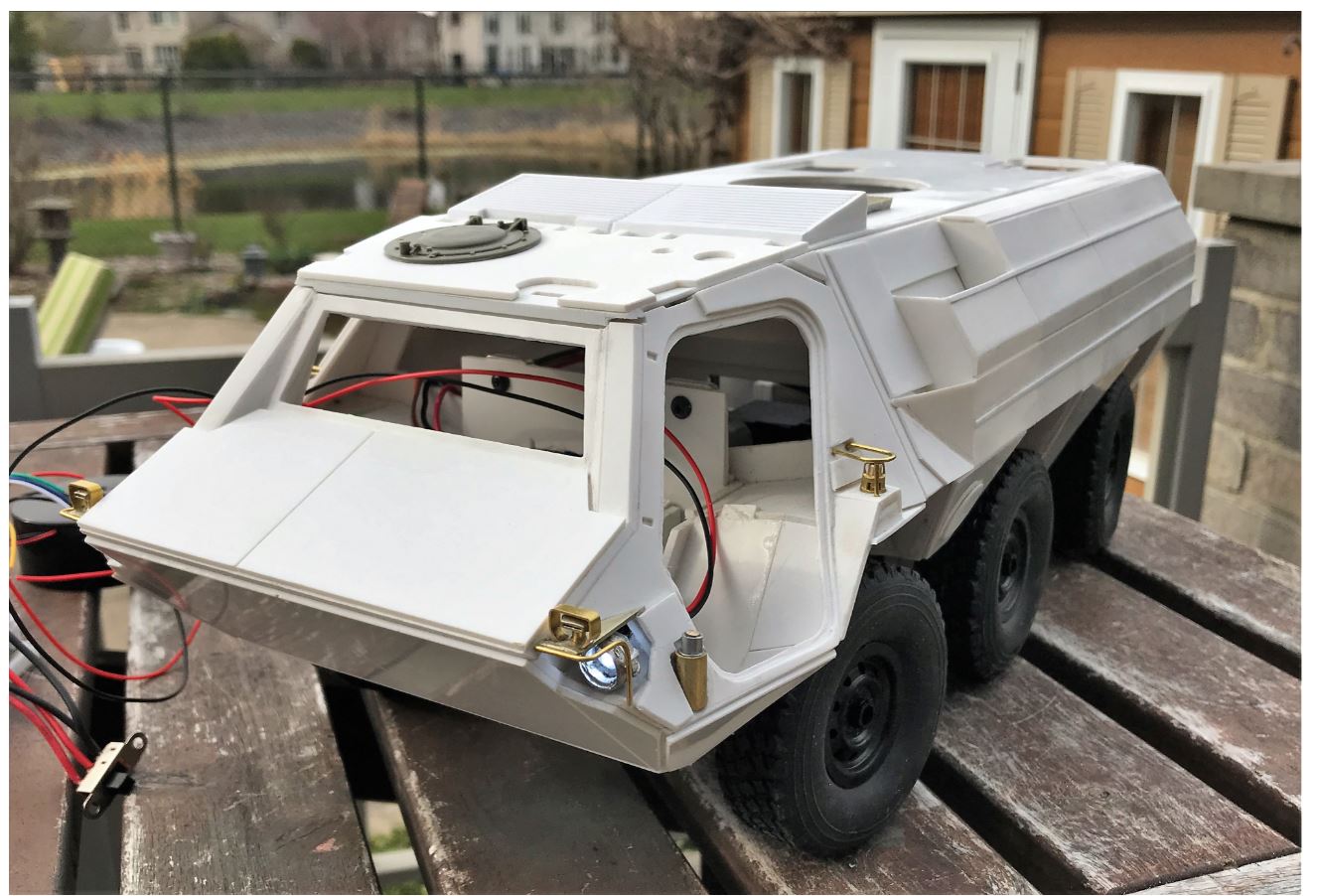

Re: TPz-1 A8 Fuchs 6x6 Transportpanzer - Bundeswehr - Build

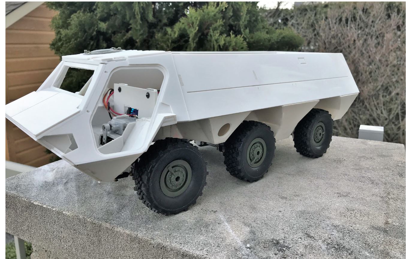

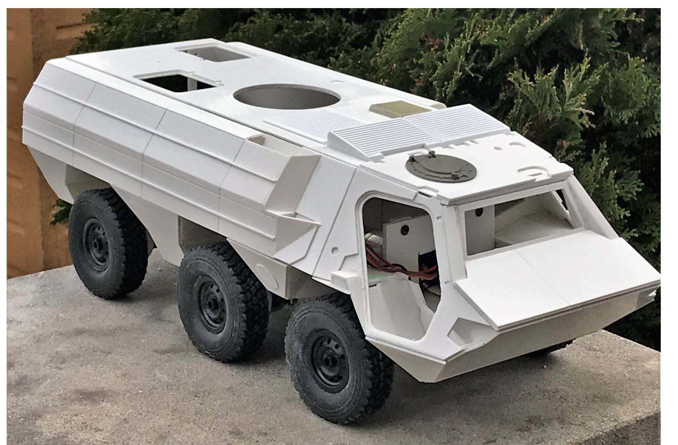

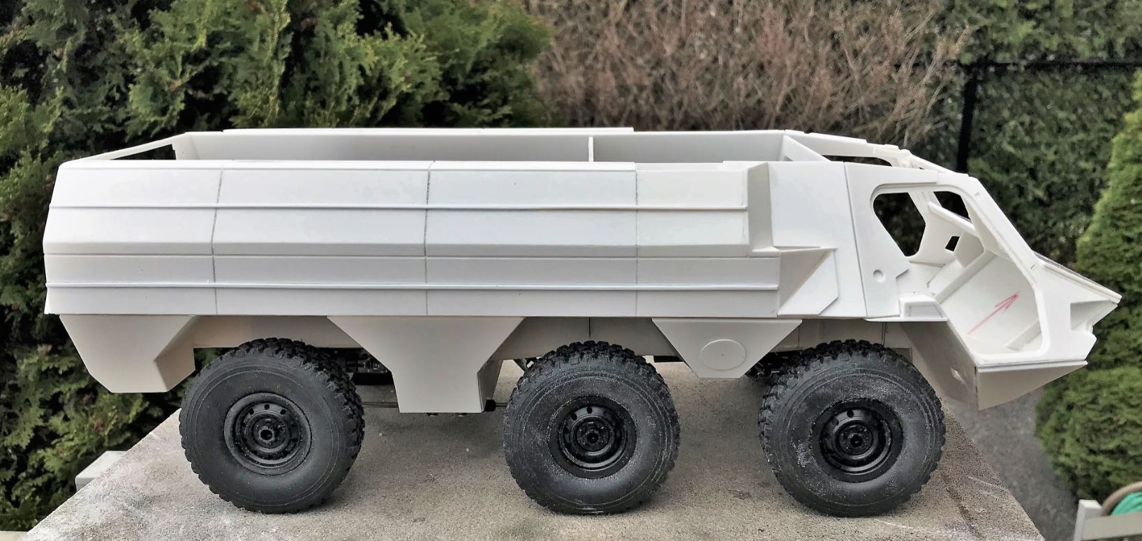

Hi, continuing the build

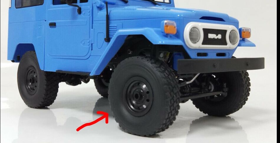

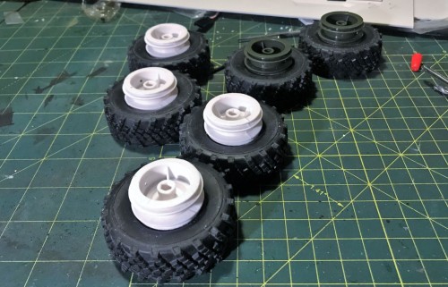

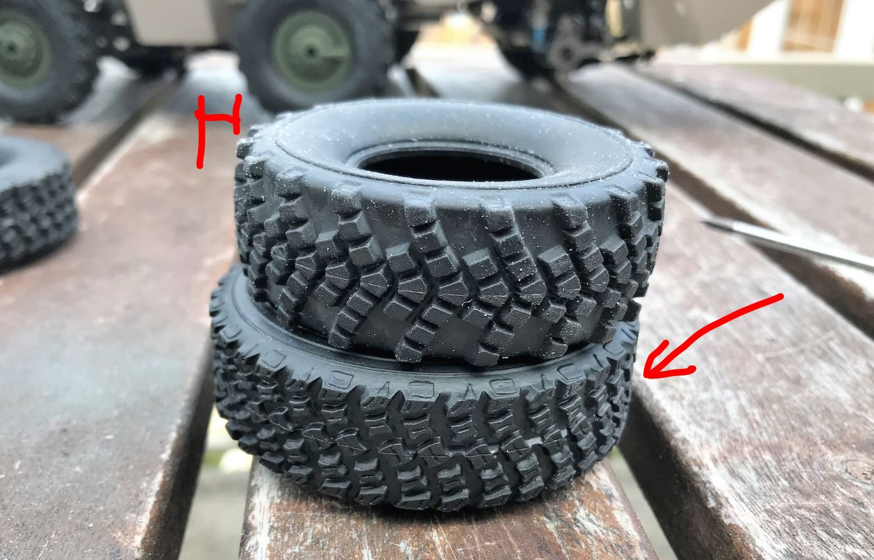

In the planning stage, i noticed these WPL C-34 Jeep tires that seem to be a close match to the required Michelin 14.00 R 20 XL18 seen on the fuchs. I purchased a lot of 12 of these tires and wheels for the ridiculous low price of $15 on ebay, shipping included... They arrived today.
There are 4 types of tires seen on Fuchs. My idea was to match the Michelin seen on the top right. .
I was happily surprised that the WPL Jeep tires are a perfect size match, exactly the extra 5mm in diameter that i was looking for. The tread style is also quite close to the Michelin.
The issue is that these tires fit a different wheel, the Jeep tires do not fit the B36 wheels. I therefore had to use the Jeep wheels and remount them with the previous extensions that were on the B36 wheels. I followed Painlesswolf's suggestion to cut the rims and create a streamlined drum like extension. I also took the opportunity to add a 4mm thick plasticard ring that brings the extension to 19mm on each wheel. It will fit better the axle width i have seen on the Fuchs. Now it is the wheel itself that does not match the Fuchs pattern. I will try to find a proper overlay to apply on top.

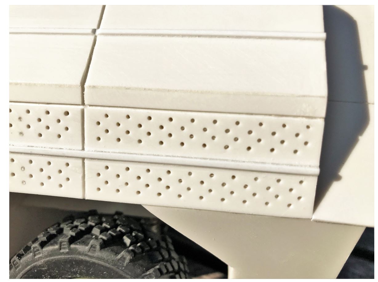

This is the right side of the Fuchs. Be aware that the Ludwig module needed a rework of the frontal bin area to match reference pictures.
The Fuchs with its new tires and right side bins.
Close up of the front bin. It's not perfect but it closely match.
The width of the axle are wider and looks better now.
View of the bins from the top. The mounts for the bins that connects to the hull had to be reduced in size in order to avoid too much gaps between the top cover and the hull.
The vehicle as it stands today.
Regards, Louis

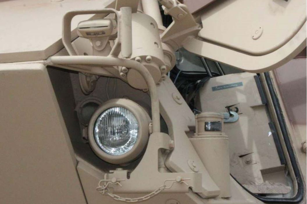

This post are for the front lights.
The Tpz-1 front light arrangements are complicated. That little bracket at the bottom is something i could not reproduce, not matter what or how i tried. I determined that If it cannot be made to look good, then it is better to leave it off.

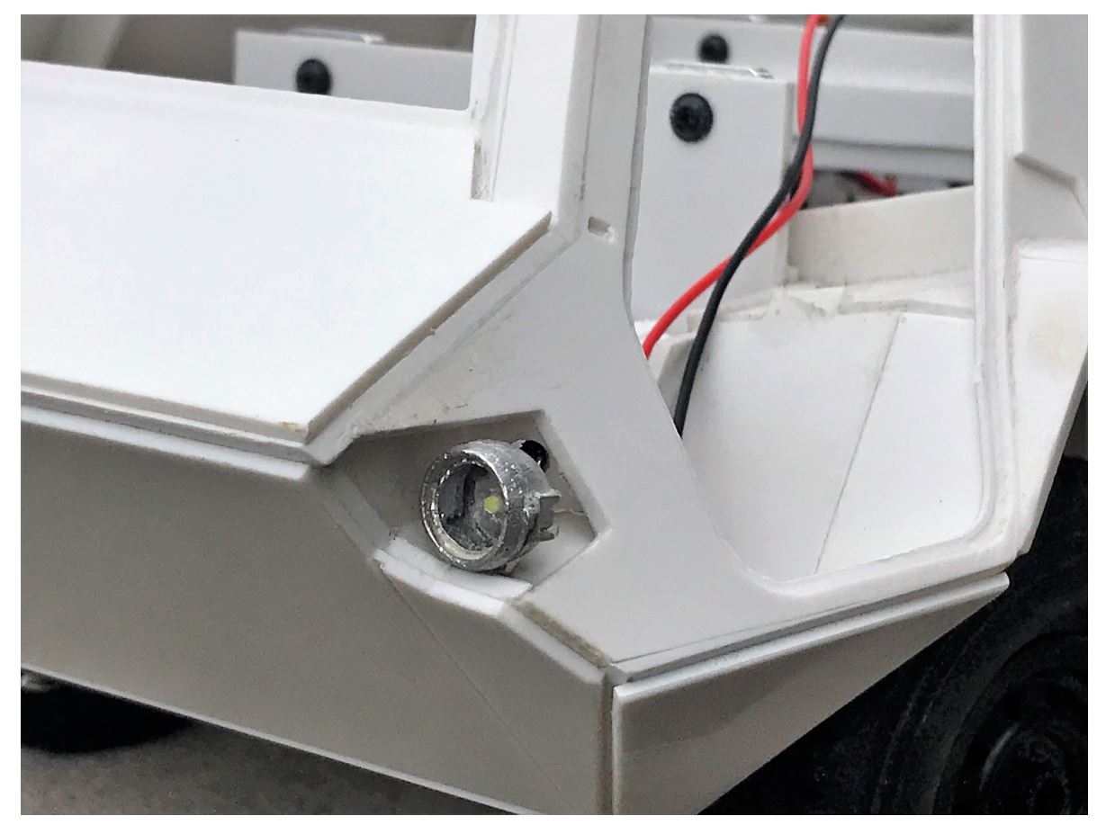

The first step is to fill the gapping hole inside the headlight area. No parts are provided by Ludwig for this. It is harder than it looks, many angles and it needs to be done twice.

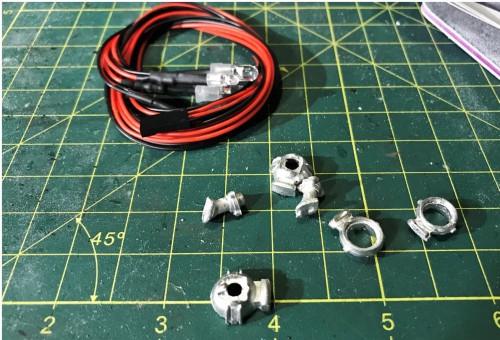

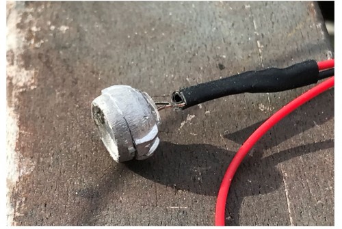

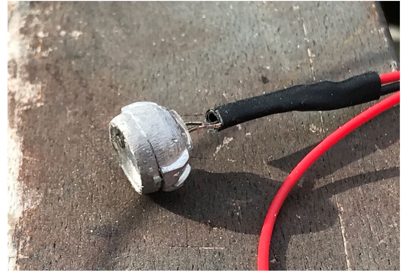

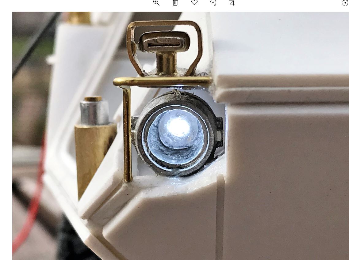

This is the Leopard 1 style front light sold by Christian. It is a bit too big and the shape needs to be reworked. The night light need to be removed. As usual, an inexpensive Led light set bought on eBay from China is used.
The head light is stripped out of most features to resemble reference pictures.
The light is mounted in its front hole area. Its too big but it will have to do. The clear lens will be installed after painting.

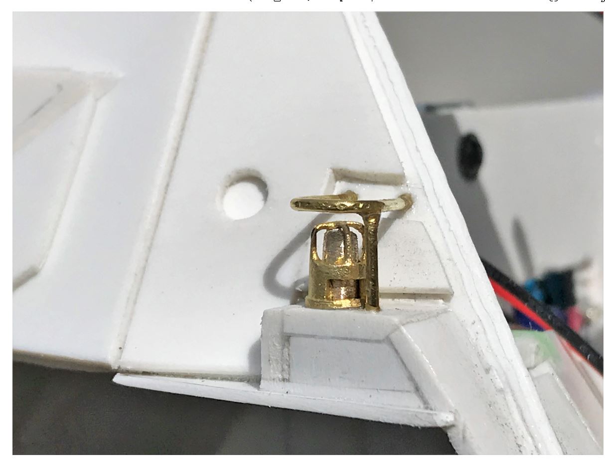

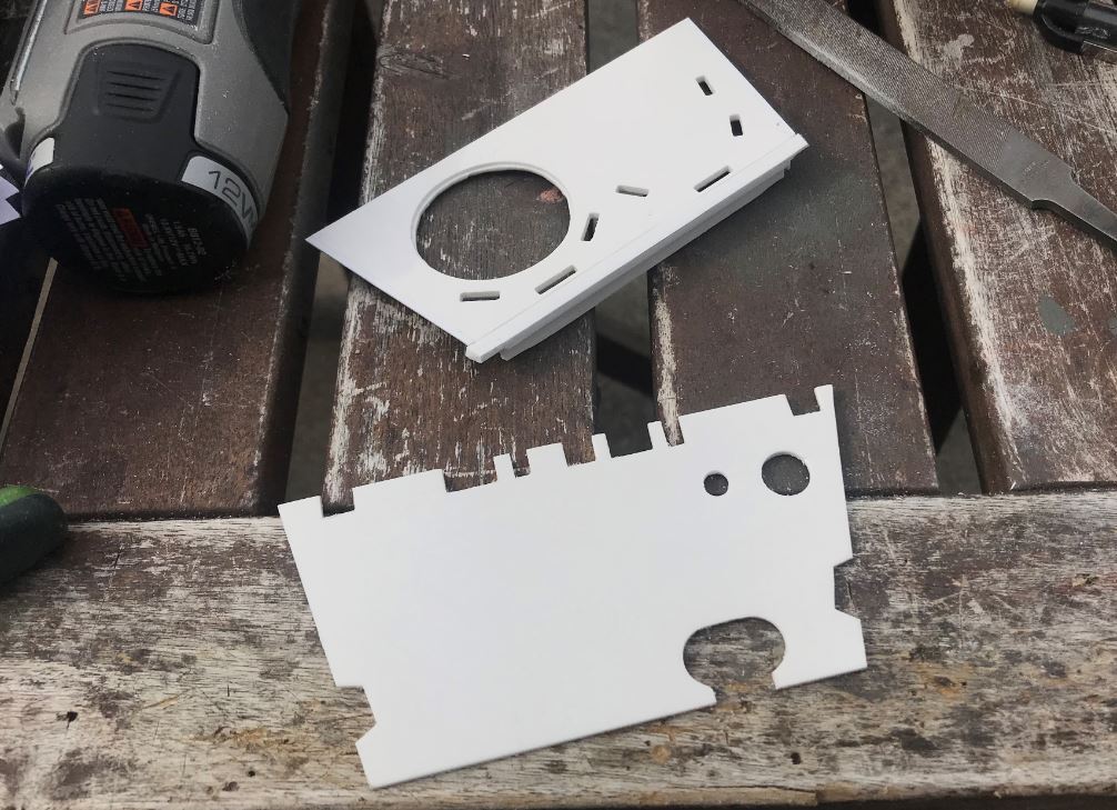

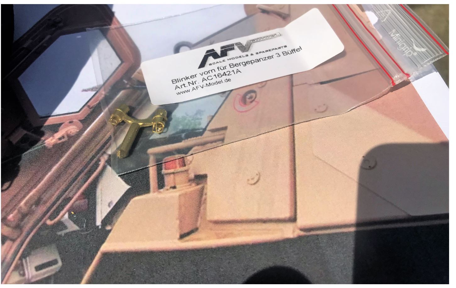

AFV_Model sells a Fuchs (non working) night light mounted on a plate for installation on top of the headlight hole at the front. It is of questionable quality. The hard metal is also difficult to work with.

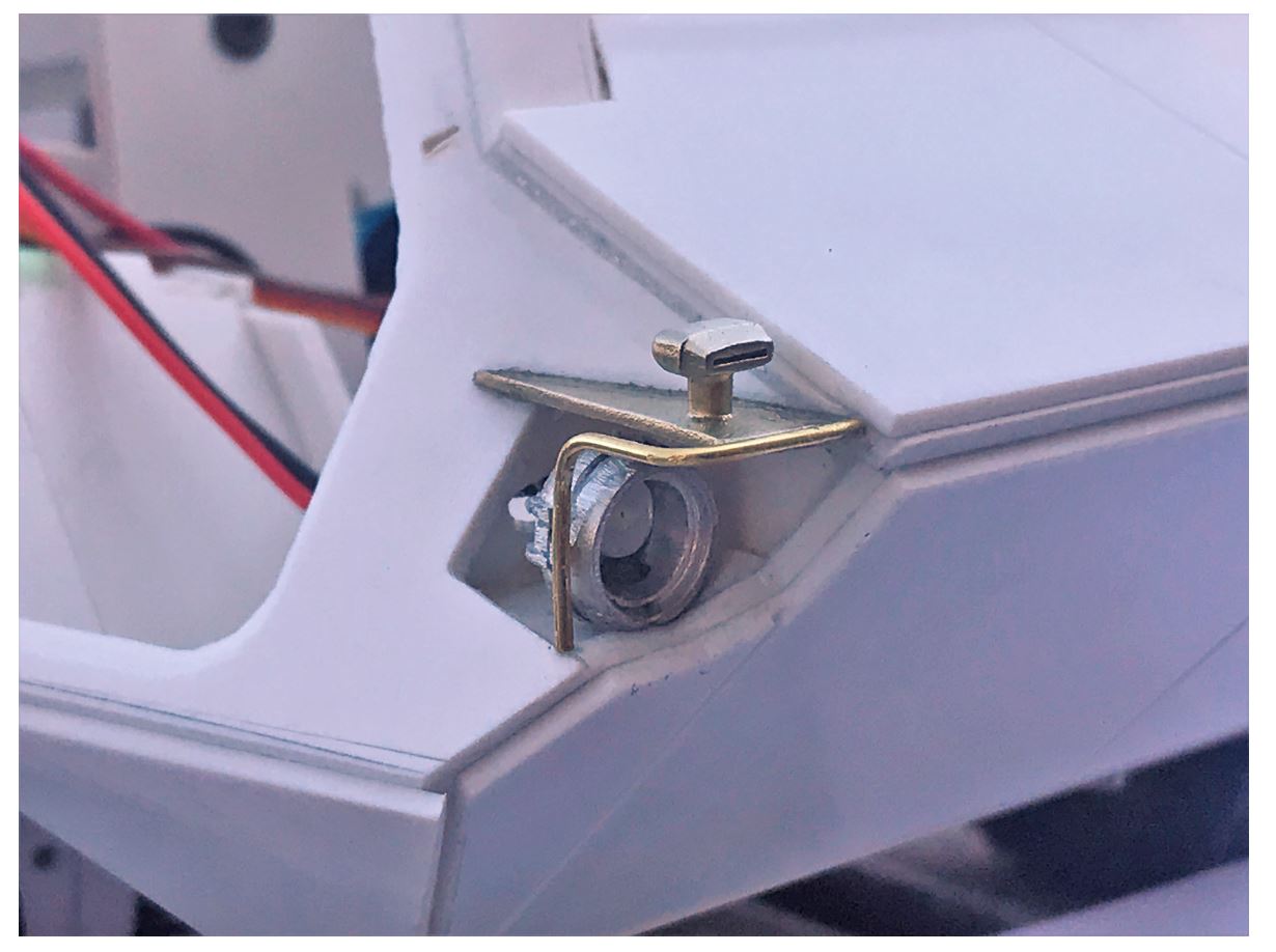

The guards on the AFV-Model plate are not reproduced correctly. When trying to gently reposition them by folding the metal, they just broke. They had to be replaced with brass rods. They were annoying and it took longer to use these purchased parts than scratch build them.
The headlight area is finished with additional details.
Notice the extra small armor plates behind the head light, it need to be scratch built through eyeball.
This is the AFV_Model blinker seen on most German vehicles. I liked this one, finally.
Continuing on following post.
The blinker is installed on its small pedestal behind the front door. A small guard need to be reproduced on top, in brass.
This is the model today. The LEDs are getting their last testing before moving on to something else.
Next step, the front doors.
Regards, Louis
