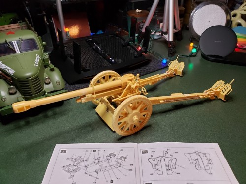

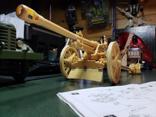

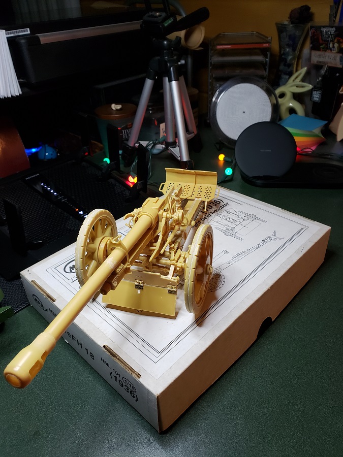

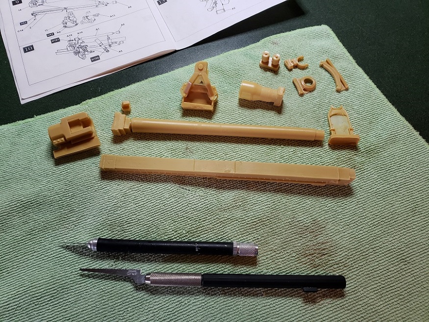

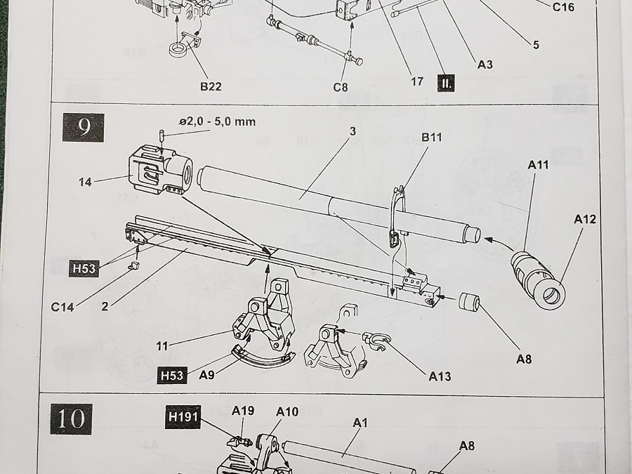

Everything that came before was as nothing to the work required to assembled the basic gun and cradle. Everything hollow and that required a tight fit for the gun to sit straight on the recoil rails and to elevate for that matter was a solid block of resin. I'm going to need some new blades for the Tamiya saw. The rails were crooked but some hot water straightened them out. Once the resin blocks were removed from the rails tho, the rails broke at a couple of thin spots in the center. Some brass stiffener cut out and glued into place took care of that repair.
) Normally, I would drill and pin but the rails really were too thin for even that. In the end, I got everything cobbled together for Step 9. Just a few more (hopefully ) simpler steps to go and I can primer. Sass, you have always challenged me to be a better modeler. Keep it up, My Friend. ;o) Pics: ( Click to Enlarge )
