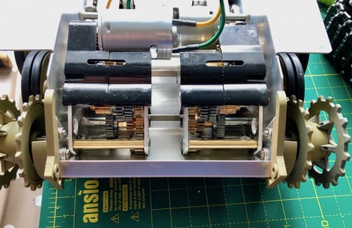

Given the global economic crisis, on top of the microbial menace, I've decided to use my Tamiya Panther as a donor for my Jagdpather-static model to Jagdpanther, full-option project.
The big stumbling block, so far, has been my inability to find Panther/Jagdpanther gearboxes for the project. It's not even possible to order them currently. Also, given that the Jagdpanther full-option model was discontinued last year, Tamiya have a reduced incentive to provide spares for it.
Even if they were available, they're more expensive than any other boxes. That's well over £200 for a pair.
I could go down the ETO gearbox route, but again, they're not cheap. Ultimately, I will buy them and fit them to the Panther. Not for some time, though.
If only Tamiya did spare driveshafts. Boxes for other models are cheaper, and all it takes is to swap the driveshafts out. In all respects, these two boxes, one for the Tiger 1, and the other for the Panther/Jagdpanther, are identical- except that the Panther shaft is roughly 4mm longer than the Tiger's. That's measuring from the edge of the gearbox frame to the end of the shaft. The Panther/Jagdpanther projects by 29mm, and the Tiger by 25mm. The Sherman protrudes by around 24 mm.
Tiger 1 25mm protrusion
Sherman 24mm protrusion
The point is, these could be donor boxes if the driveshafts were swapped out. Annoyingly, it only takes a minute or two to remove and replace them. All the shafts have a diameter of around 7.96mm-8.00mm. call 'em 8mm. Anyone with a lathe could machine some collets or spacers to bring these up to the 29mm needed for the Panther. With machined flats, and longer retaining screws the sprockets should still be locked to the drive units. Just a thought...
I thought I'd include a pic of the Standoffs used on the Tiger and Panther. The height of the standoff does vary slightly from model to model, but this can be overcome quite easily. The Tiger 1 standoffs are black. They're around 9mm high, but the washer makes them almost 10mm.
Here's the Jagdpanther with the donor boxes in place. It's a good idea to apply any grease to the shafts before fitting the boxes.

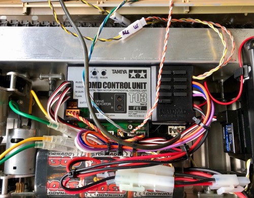

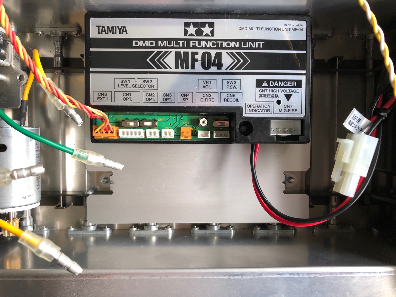

Now it's time for the DMD units. I was lucky to get the MF-04 unit (Jagdpanther only) as a special offer from Axel's Modellbau.
Cheap Tamiya products are as rare as rocking horse 'sh*t!
This should govern the features unique to a turretless tank-destroyer.
Then, the drive ESC (T-03, also fitted to several other models), sits atop the Multifunction unit (MF-04), and is fixed in place- like the MF-04, by double-sided tape, along with the Futuba receiver.

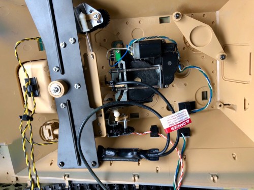

One unusual feature of this model, is that it uses two standard elevation units to manage elevation and (limited) traverse, instead of the usual elevation and rotation units. . Fitting these units can be surprisingly tricky, and demands great expletive control, as well as ultra nimble fingers
The return spring for the elevation unit is a nightmare. It's easy to see, sometimes, why Tamiya want other people to assemble these things (we, the masochistic model-makers), rather than have workers with uncontrolled fits of rage on the factory floor.

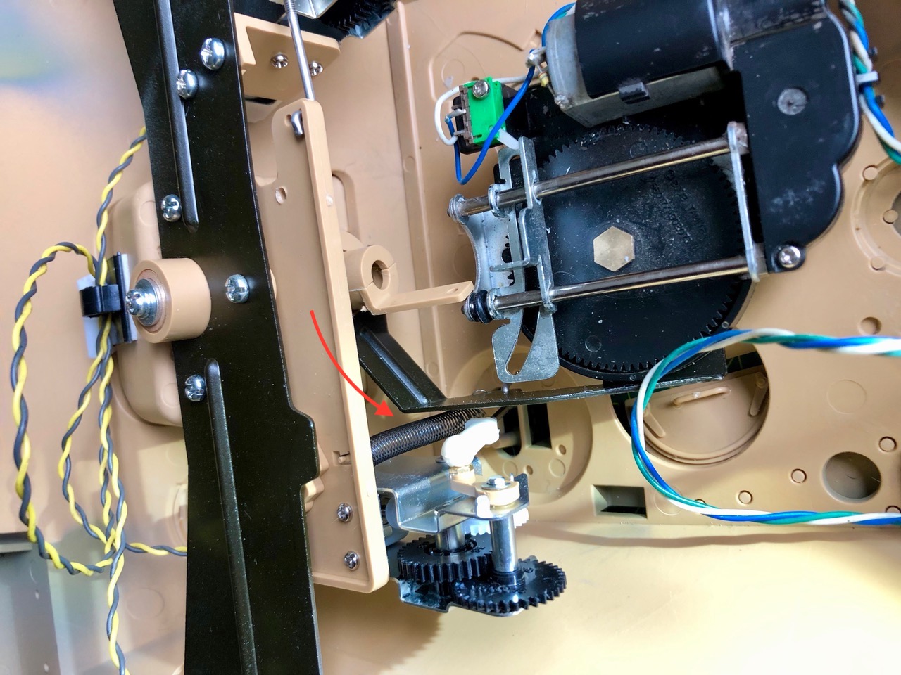

Here's a pc of the annoying elevation unit spring:
I still have to get a spring for the other unit, that manages the traverse return. For the moment, the linkage can cope with movement fairly well, without needing a damper.

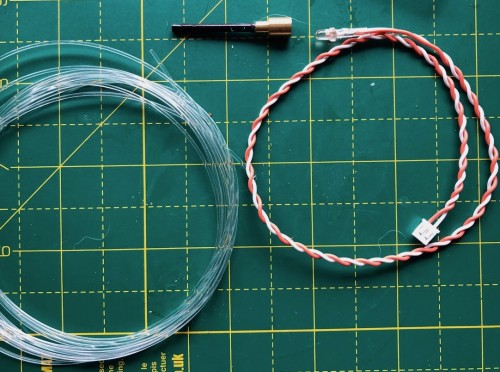

Next, I removed the Panther's flash unit, and fitted it in the JP. Nothing to have a nervous breakdown about there- unless it doesn't work. These units are very expensive.

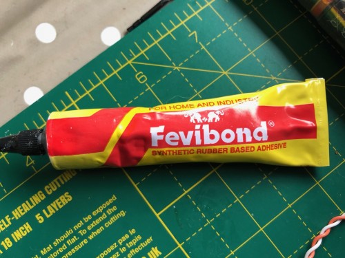

Then there's the hull machine gun. These are the main components: Tamiya recommends using synthetic rubber glue for parts like these, without actually recommending one. I've used other types before, but recently, I found this one to be excellent:

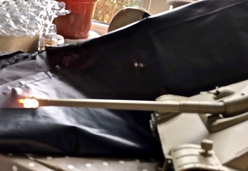

Putting it all together, I ran the motors, and checked all the functions. Then it was time to fire the cannon for the first time (not that easy to record- and- note to self, must create a video channel some day)
