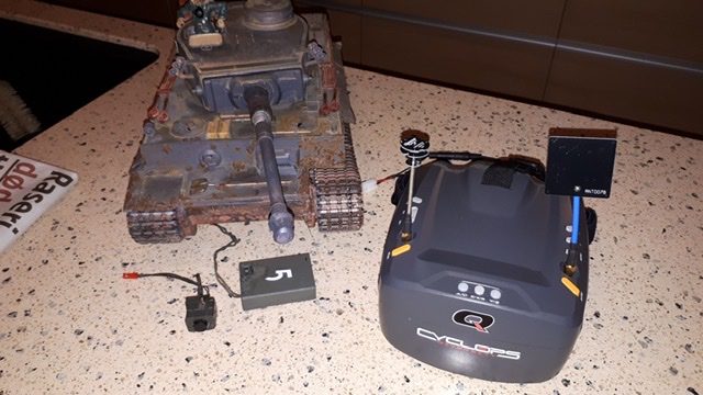

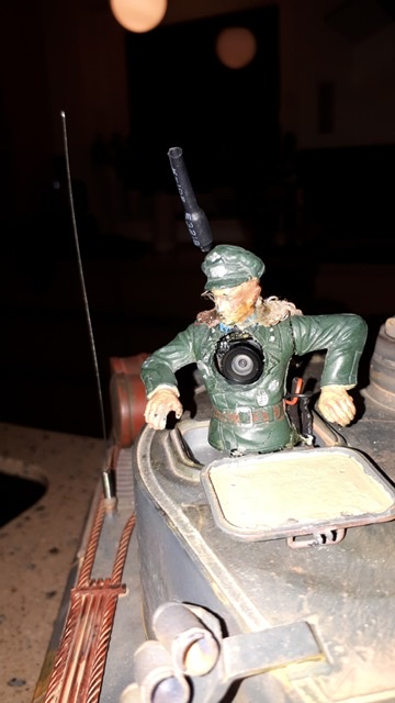

I have been playing a little with FPV to.
I bourght 2 cheap china cams ( less than 10 usd/piece) with integrated tx. 1 is mounted in the chest of the tiger crewman and powered from the tank accu, via an inline voltage regulator. The crewman is then mounted on top of a servo so the camera can look from side to side undependent of the turret. The other camera is mounted in 1/2 a gas tank from a wpl truck and have a seperate powersupply ( the other box).
The googles are the cheapest from HK.
