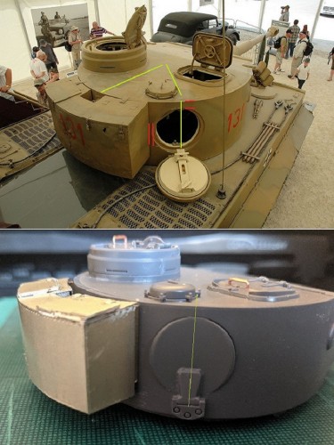

Hi Mr jimbo, I think you have the turret bin correct when central. I have spent the last few weeks tirelessly searching for good detailed close up views of Wegmann production rivetted turret bins with escape hatches in the same shot. What I have found in the few shots that exist, demonstrate that manufactures of all scale models of Tiger 1's do not seem to agree the correct angle/size of bin or position relative regarding the escape hatch. Tiger 131 is the only solid source we have as true reference. IMHO the angle of 45degree is correct, an imaginary line to the centre of the roof just kisses the lip of the turret vent. As you can see in the picture below the relative gap from edge of escape hatch to turret bin on 131 is smaller than your gap but appears to be central the rear lifting lug. IMHO you can only work with what you have, and what you have looks good.

Thank you Mr Boar, that's a cracking picture and bit of maths that explains it all!
Glad that superglued it in the right place
