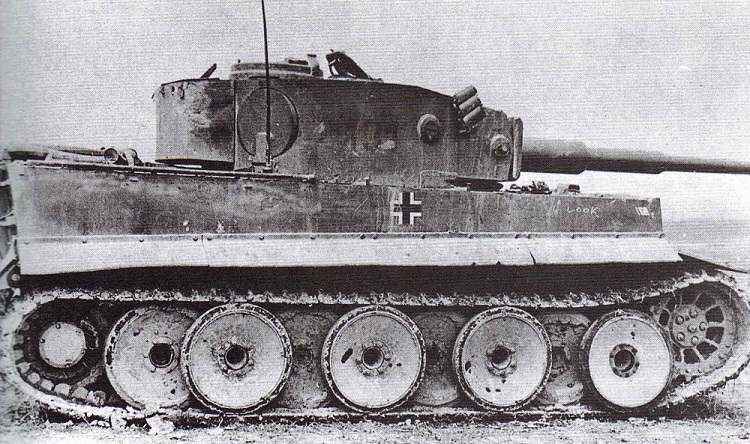

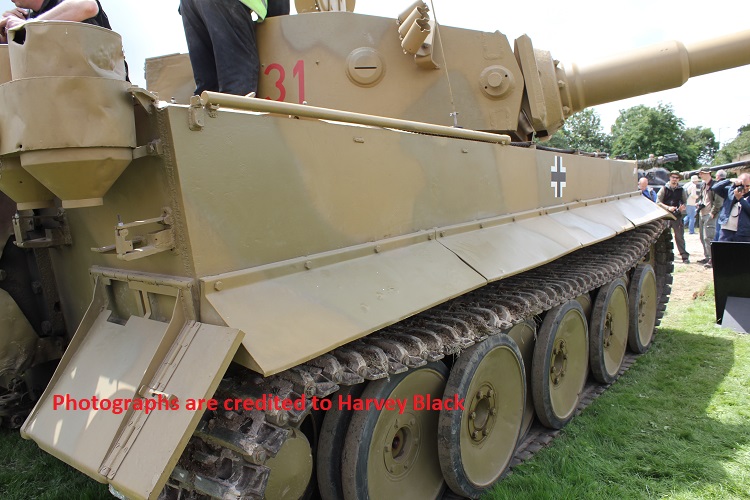

Best I can offer on the aerial tube from my files

Perfect thank you, that might be something I could actually work on and fix on my project.
