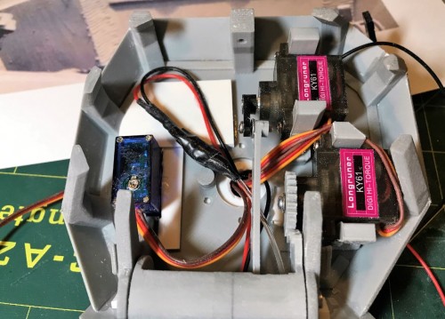

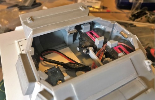

This is the turret electronics, with servo elevation, servo recoil, servo rotation, main gun and coax MG flash.
M-113 M113 M-113A1 MRV 1/16 RC Scorpion Turret Australian Army build

Another view of the turret electronics

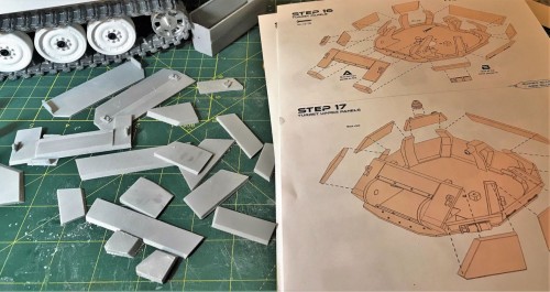

The next 2 posts are for the turret core, minus the more fragile details that will be added later as these could be damaged through manipulations as the build is far from over.

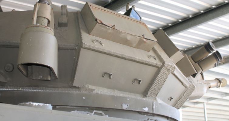

The Scorpion turret as seen on the web. Notice the overlaid armored plate, angles and reinforcement that must be studied for an accurate dressing up of the turret.

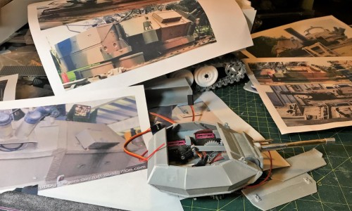

Sanding and polishing the 3D printed parts takes a good two hours, the process is creating fine dust requiring the mandatory wearing of a N95 mask and thorough cleanup of the work area. The plastic is soft so it helps getting to a flat, smooth and acceptable finish. The sanding of the parts, which requires most built-in details to be erased, is essential. Otherwise, the heavy 3D printed lines will make the finished model look like a freak, painting will only make the printed lines show even more. As for the built-in detail, it is ok to erase it all with the sanding because most of it is not accurate for the MRV anyway.

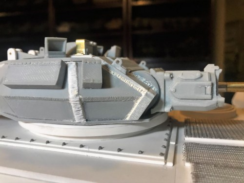

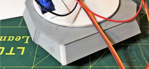

The installation of the armored plates went surprisingly well, starting with the lower sections. The parts dimensions are good. Only the back plate required an extension to fit.
The upper plates installation also went well. The whole thing only requires some adjustments here and there to fit, and almost no putty.

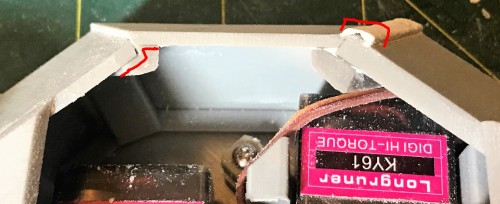

The main corrections are for the angled plates at the back, it cannot be glued flush with the middle plate. It must be recessed as per reference picture. Also, the weld reinforcements at the front sides need to be created with plasticard, with metal cutting and welding simulations.

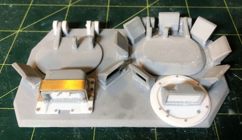

The sanding of the turret roof is difficult but doable. Again, most of the small built-in details were erased in the process and will need to be reproduced in plasticard.

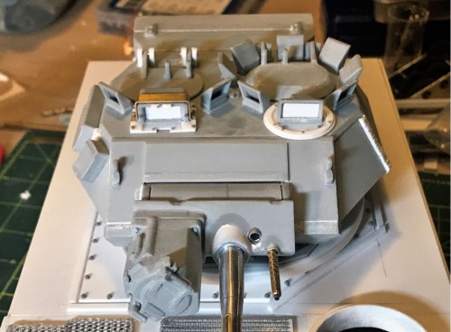

The turret core, minis its small detail that will be added later, such as the Infra red light on the right of the mantlet, smoke grenade launchers on both sides, brackets of all kinds, the two radio antennas, machine gun mounts, etc.
M-113 M113 M-113A1 MRV 1/16 RC Scorpion fire support Turret Australian Army build

Overview of the M-113A1 MRV and its Scorpion turret. You can see where this build is going.
The sanding and finishing of the complex optical apparatus is work in progress, its getting there.
