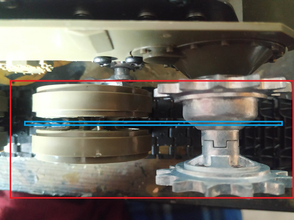

I never threw a track neither, because I have not run it yet, lol.Ad Lav wrote:Never threw a track on my T55 in six months of use... did you even look at the build?!
But take a look at the pic attacked. This is with the gearboxes in the mount plate, and that plate bolted in the hull. Sprocket bolted in too.
This is an horrible offset that needs to be corrected. Tom said he put extra washers, but I think it would be better to make the motor axle 2mm shorter.

Thanks for the warning - another surprise from the amazing designers at Hooben products...Rad_Schuhart wrote:Yep, before working on the turret I think you should focus on that first, lol. The sprockets are offset. I mean, are not aligned with the roadwheels, so it will cause throw track every 10 seconds, lol.Marc780 wrote:Sprocket offset? I haven't even gotten that far yet, right now I'm just happy all the motors respond to the transmitter! I guess that's something I'll deal with when I get to it? I'll probably search the forums to find out how others fixed the problem on similar tanks, although now that I know i have this problem to deal with I can't say I'm looking forward to it lolRad_Schuhart wrote:Hi Marc, please tell us how did you solve the horrible sprocket offset. As stock, it is almost like the king tiger!
I planned to shim the wheels, but one shim is not enough, and two makes the roadwheels to bee too out, and the grub screw wont have enough flat part to fit.
Anyway considering doing that puts the wheels outside the fenders (and it should NOT be like that) the only thing we can do, is to machine the motor axles and remove 1 or 2 milimeters...

We may have gotten different sprocket parts or different axles - but your sprocket looks to me that it is not pushed onto the axle far enough. That or perhaps the sprocket halves are reversed and that's why it did not fit all the way on. (I made the same mistake at least twice, also it is possible to misalign the teeth on the sprocket halves when you put them together and if you do that the track won't sit right, of course! - when I did this it took me a moment to realize the mistake, I'm just glad I didn't glue it together like that!) The flat spot on the axle is supposed to fit into the rectangular hole cast into the sprockets, at least on mine it did... I found the easy way to put on the sprocket was to lube the axle, align the slots and push on the inner sprocket. Then install the outer sprocket and the screw and it should be all the way on - it goes on so far it is almost touching the hull.Rad_Schuhart wrote:I never threw a track neither, because I have not run it yet, lol.Ad Lav wrote:Never threw a track on my T55 in six months of use... did you even look at the build?!

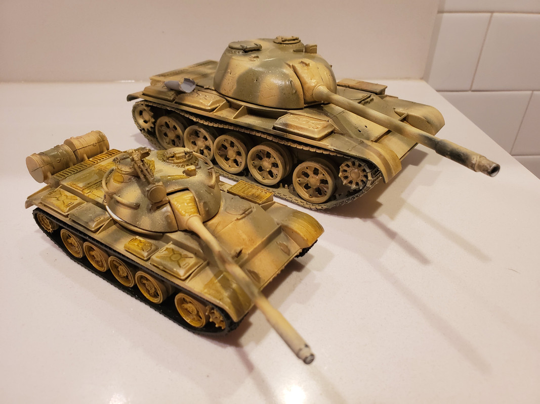

Many months ago I built a couple T55 models to use for testing purposes. There were some paints and coatings I wanted to try out first before doing it to the finished model. I got a 1/35 scale model from Lindberg and a 1/72 scale one too (not really for testing I just wanted to have it around lol).
There are so many shades of yellow paint available I didn't want to pick one that looked wrong; and some shades I eliminated right away, like US armor yellow (much too pale), and German dunkelgelb (too greenish, at least the ones I've used). After a lot of research looking at other folk's models, plus images of the real thing (T-55's in Syrian service) I settled on "oil ochre" from MIG. This shade most closely matches how most tanks in the middle east are painted.
I also used the Lindberg model to try out "Mr Surfacer". And if it's a rough cast iron surface you want to show, Mr Surfacer is the stuff (it's just thinned-out putty though). On the real T-55 the turret is made from several castings welded together. And on some photos of the real ones the roughness of the castings is very visible, while on others not nearly as much. Naturally I wanted to try it out on something expendable first BEFORE slathering it all over the turret permanently! But after applying it on the Lindberg model, then comparing it to my test images, I decided not to use the Mr Surfacer after all. The turret on the Hooben is made with a rough "cast metal" surface - even after priming, the real test - and I did not want to go too far the other direction and have the turret texture be TOO rough. This image is what led me to this conclusion:
Next I got some velcro to hold the battery. I attached it to the hull floor (that is, the aluminum hull reinforcement plate inside the lower hull) using two sheet metal screws, plus some flat washers. Care in sizing the sheet metal screws is demanded, to prevent making an unwanted hole in the plastic hull (the aluminum plate does not fit flush with the plastic hull since the latter is concave). When installed there is a gap between the hull plate and the plastic hull of about 1/4" to 1/2" when installed. I'm thinking about tucking the motor wires under there and then through a hole, just to eliminate some of the wiring clutter - the hole being lined with a rubber grommet, naturally.
The tank is primed now and even the wheels are masked, since they will be getting their rubber tires glued on soon.
On goes the ochre yellow base coat.
I'll let it dry for a day before I start the green camo. MIG "light green khaki" is what's on the test tanks because it is a better match for the Syrian scheme (c. Yom Kippur war of 1973 and even many tanks up to those of the present day)than good old Russian Armor green, since RAG would come out too dark anyway. I'm even going to edge the green with light grey. This pattern was used on some T-55's from the 1973 war...someone else's static model in 1/35 scale
And here's the real item with the same colors... (the odd gap between the road wheels indicates this is actually a T-62 - colors show the picture was possibly taken in the Yom Kippur war)

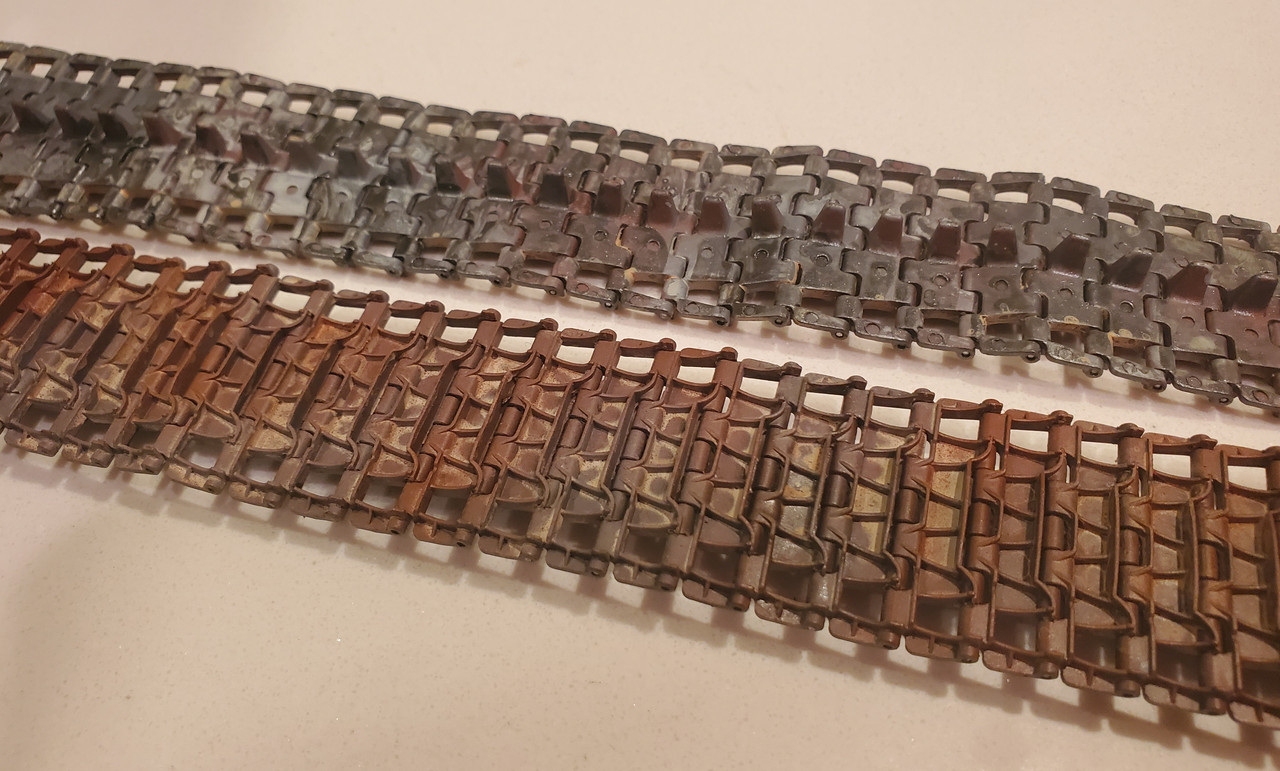

Next was weathering the tracks. I first sprayed them with plain red primer. Then I went over the high spots and inside of the tracks with gunmetal. After that, a wash of MIG "dust". Then I thinned some Testor's "Rust" and gave the tracks a light spray of same, but only on the outside surfaces (since I figured the road wheels and other running gear would leave behind mainly a gunmetal surface there).
