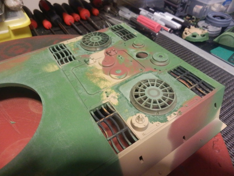

The rear deck is clear of the G trappings, like the intake hood and crew heater-again still putty to be added & sanded.
The vent grilles are swapped out with the wavy style grilles out of a Pantiger deck. Not perfect tailor made, but very good enough.

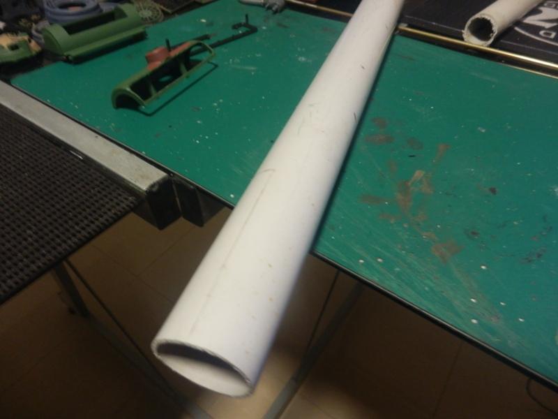

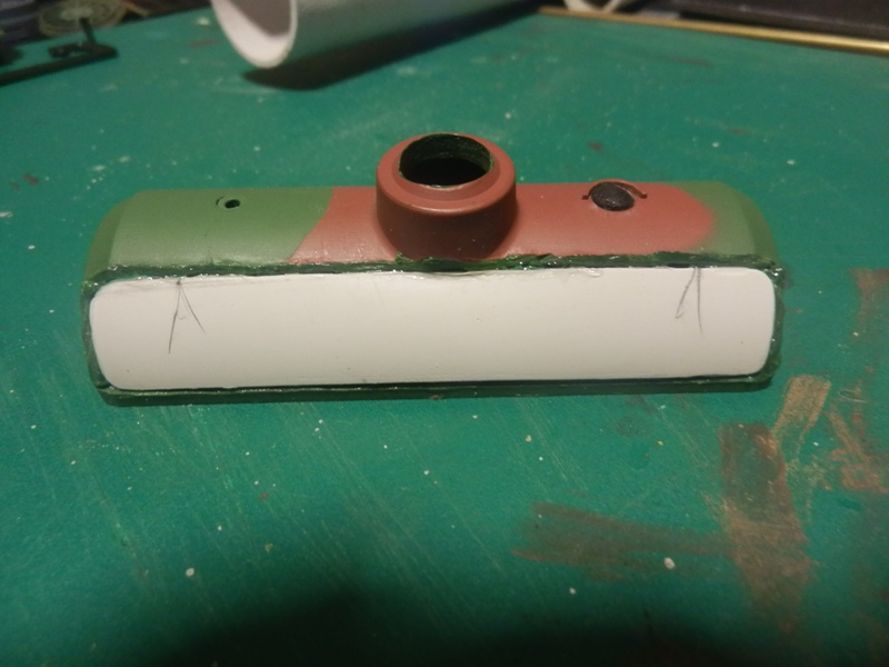

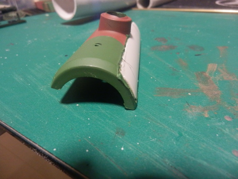

The chin on the mantlet is gone, replaced by a section of electrical conduit donated late last night by the Father -In-Law. Ole Barrie got the call at 2130hrs & was up for the challenge. Got the daughter to chauffeur my half cut ass around there to pick up the stuff. I set it in place while waiting for the motogp to begin (damn if THAT didnt near kill me
Inch & a Quarter conduit has exactly the right radius to match the Panther mantlet curve.........who'd of thunk it
So, I'm getting the shape & look required.

I've been looking at the curves of plumbing and conduit tubes for a while now. I wanted to experiment with their plastic and Heng Long plastic with various glues, like the plumbing variety for one. Therefore I must ask, what glue did you use to stick the mantlet together?

Slow cure Selley’s gel super glue.
It’s a high impact resistant version.

Recovered the intake grille ring from my donor Pantiger. Used a step drill to bore the centre hole out to accept a left over Taigen King Tiger engine deck mesh P.E. patch underneath it.
Its ok & will pass for the thing it needs to be.
