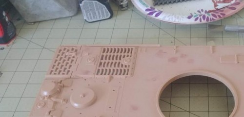

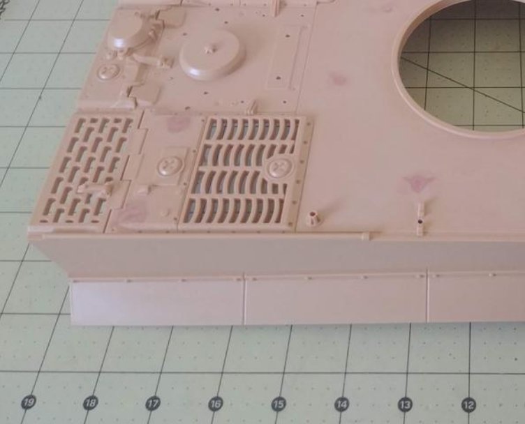

Yip that’s it, but being metal it won’t be easy. I’d recommend keeping it as is and ordering a plastic one.
Research your time slot against the Tiger features for that time . They are well documented.
Or, build it the way you want that makes you happy and that’s a good outcome too.

Yes, this storage tube stays.
This wrongly placed storage tube goes.

I used a dremel rotary tool with a sanding drum followed by a flat needle file to remove mine. You will have a jagged hole to fill after you file the face flat. I used Tamiya putty to fill it in. It was wasn’t as much of a chore as I thought but be careful to maintain the curved contour around the barrel area. The result is worth the unique and seldom modeled modification.

If I am seeing your picture correctly then you have already flattened the Gunners Binocular gunsight,
If you have then The Gun Mantlet that you are showing is good for an early Tiger 1 after that the only major changes to it was a reinforced mantlet in November 1942 with an enlarged protruding gunners binocular gunsight and in 1944 the gunners binocular gunsight was replaced by a monocular gunsight.
Your identification of the correct aerial stowage tube is right on the button.

Thanks all. Perhaps I will remove the hoop and foot hold. I know I can do what I want with my model, but making it inaccurate rubs me the wrong way.

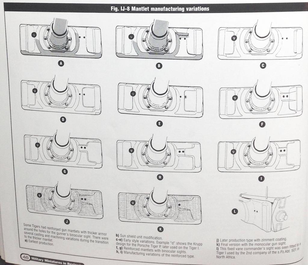

Did someone say Tiger 1 mantlet
Click on picture.

To all intents and purposes only "A" "F" "G" and "K" are relevant to the regular production "Henschel" Tiger 1 EarlyEarly /the Tiger 1 early / the Tiger 1 late/and very late.
The others are one offs or very limited edition Porsche turrets and a turret with Zimmerit.

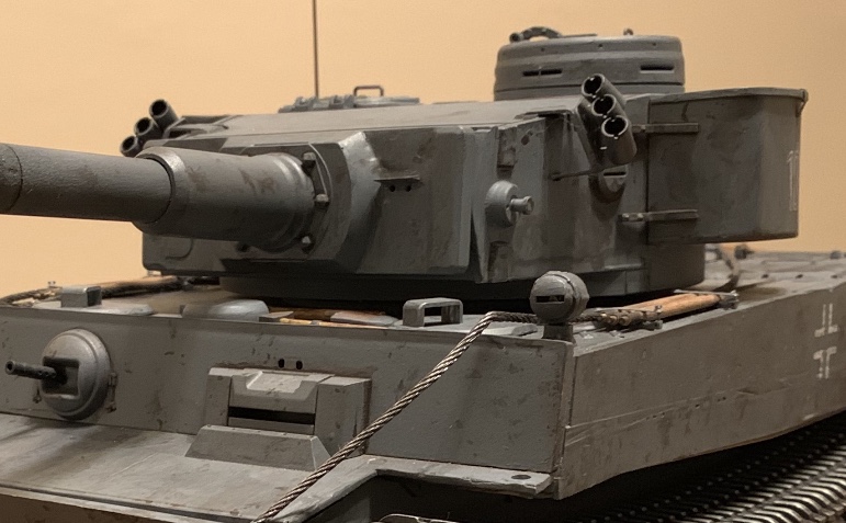

Here’s my initial production Tiger mantlet. Take your time and you can do a much neater job than I did.
