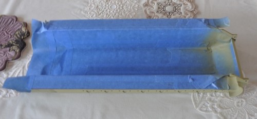

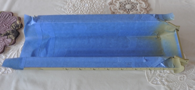

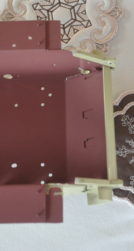

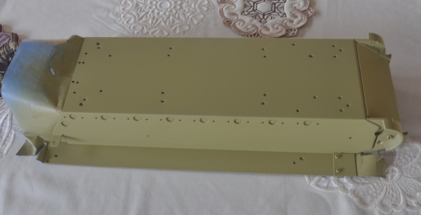

Things have finally calmed down enough that I can get back on the JP. I stripped everything out of him down to the bare hull, this takes surprisingly little time to accomplish, about an hour and a half and the hull is bare. The hull was sanded lightly inside and out with a 220 grit block before blowing on some red primer.
After drying for three days in our mid summer sun, I taped the inside to cover every hole in him before I blew on Tamiya TS 3.
Before the primer, I smoothed out the relief holes for the Eto transmission which involved removing the 0.50 plasticard from the lower front hull. I had attached it with Moment rubber adhesive, the same stuff I use on the zimmerit installation of the P4. With not too much careful worrying of the part, it will come off. Petroleum based solvent will remove whatever adhesive stayed on the hull and the plasticard. I put the same piece of plasticard back on the beast before doing the paint work.
The blue tape I use is Scotch 'Painter's Tape'. It is quite strong and comes off easily but it's not as sticky as masking tape.
The end result will be something I prefer to do. Not only will the outside be reasonably well detailed, painted and very mildly weathered, but the interior will be pleasing to the eye.
Before all the goodies go in, I'll seal any joints with a very fine sealer. Any left over holes in the hull will have pan head screws in them with nuts inside. There will be a bunch of them, my TU's attach with two standoffs outside each suspension rail, so that's four inside the rails at the front to be sealed. He will get a HennTec idler unit so that's two more, and some other things will also be changed. There will be a hull brace at front and back over the sponsons and the rear one will also have the standoff for the upper hull attachment. The hull floor will not flex with my transmissions installed since it's all one unit, the four attaching bolts pretty much stiffen the hull floor. The sprocket guides are Impact from some old stock I have here.
He's also going to get the Wecohe suspension but the two front road wheels will have Tamiya torsion bars. My TU's are a little heavier than stock, two Tamiya transmissions weigh 470 grams, my units all up weigh 650 grams. That's not really a lot of difference, but toss in the fact that this beast may well be run by VCO, who takes no prisoners and has been known to run through some pretty rough country in her quest to ventilate the opposition, and methinks it's a prudent measure.
