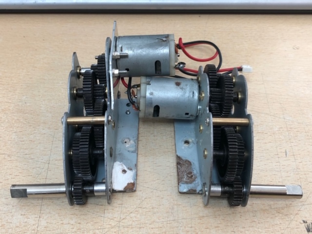

971wright wrote:Great bargain those gearboxes cost £20 then you have other parts which add up a good battery.plus the rest.
regards pete
Actually, those gearboxes look like the Taigen pro 4:1, although they are an earlier version than what's on offer now, possibly 35 quid at the time, over 40 now for a newer set.
So yeah, gearboxes alone, very much a bargain.
And yes, they look like they are Panther ones. Which should be ok in the jagd panther, although, for the jagd panther, they usually need a conversion like these ones.
regards pete
Taigen 4:1 Pro Steel Gearbox Jagdpanther 380 Motors 18.000T + Conversion Kit
https://www.forgebeartanks.com/store/p5 ... __Kit.html
Oh brilliant, thanks for this info. I was going to shelve them and put original OEM gearboxes in. If they need a conversion that could possibly explain the bodge fitment/hacking of the hull.

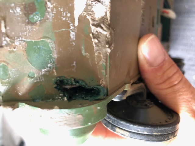

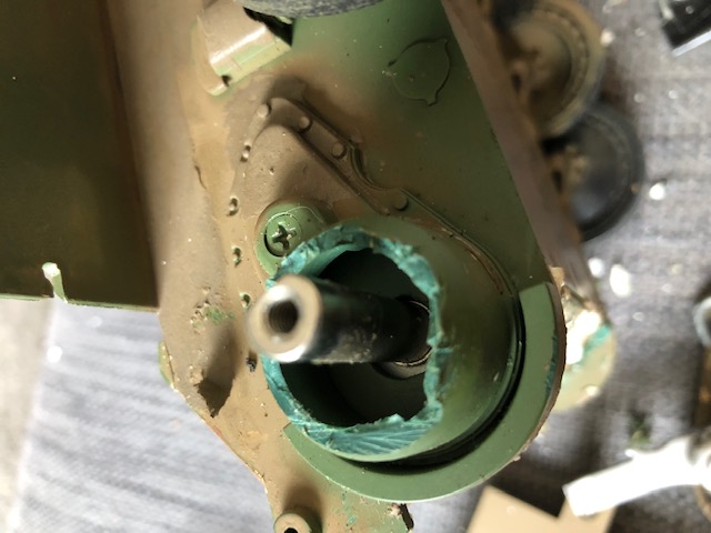

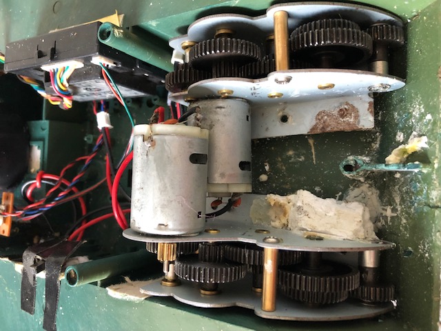

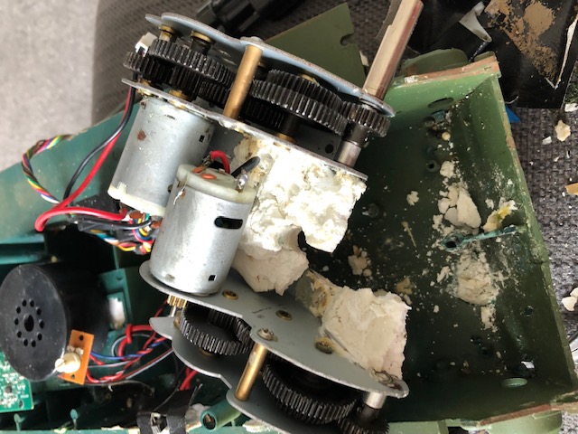

Closer look at gearbox fitment.... or non fitment
HL Panther G
HL Jadgpanther

Looking at the link, Pete, these look the same as the ones I have in my Panther and the metal lower hull. Ill see what base they have or how they fit.
Am I to think the JP base is different then from standard Panther? I’ll be home later today so I’ll find out.
John

John, if you look again in the link I gave you. Look at the second and third pictures, you will see a plate/bracket which is the conversion for the jagd panther. It's to hold and move the higher motor back and lower.
I'm not sure why it's needed, I'm guessing that the motor in the higher position may cause problems with the jagd Panthers upper hull fitting which doesn't apply to the standard panther. Could the higher motor get in the way of the gun innards (bb unit) when on high elevation?
Other than that extra motor bracket, these gear boxes should be the same as the ones for the Taigen panther with the lower hull metal base.
Mick.

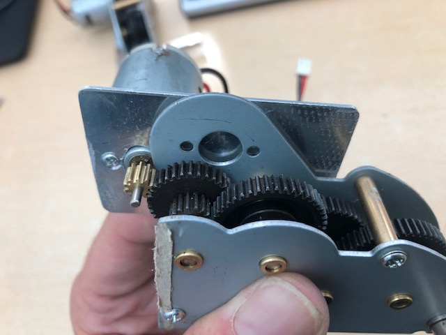

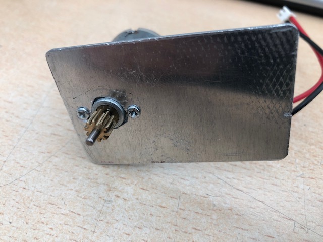

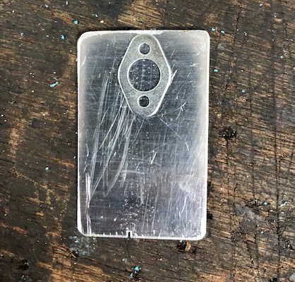

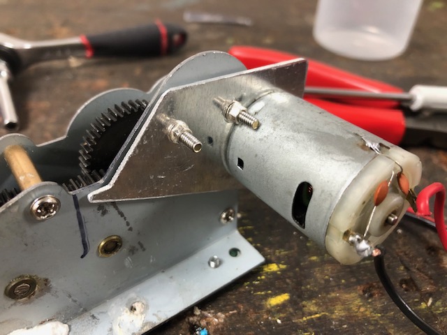

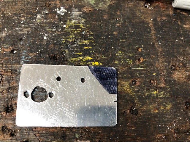

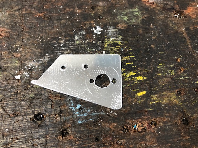

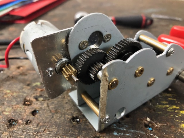

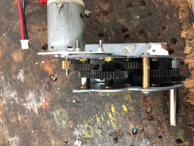

Taking a closer look, I could see what you meant Mick. So I’ve made one( luckily a few quiet hours at work today), I’ll have to wait until I’m home at about 1900hrs to see if it fits.
Anyway here’s the process in pictures. Sorry for picture overload!
John
Final fit making sure gears mesh nicely and not tightly.
Trimmed excess for neatness and stop infringement of upper body
Rough template for motor. Giving room for movement

Only final placement will tell if I’ve made this correctly.
HL Panther G
HL Jadgpanther
Posts: 7595
Re: So today I bought this..
:clap: :clap: bravo sir :thumbup:
Now make it in steel ;)
With close inspection of the pro box, it looks like the top of the motor is inline with the top of the two screws that hold the bracket to the gearbox.
Sorry, got to say, if you have this bracket as a test piece, I really would consider making the final bracket out of steel. Under load when you get this beast rolling, that aluminium plate is more likely to flex, and the brass motor pinion will only need to be out of mesh a little for it to get damaged and strip.
Also I noticed the plate/bracket is slightly spaced off the gearbox, it would be better if you could get them tighter together, would make it more stable, and align the pinion more with the first driven gear.
You may have to do a little indent where one of the gear shaft bushes goes. Also I would use a minimum of 2mm thick steel.
