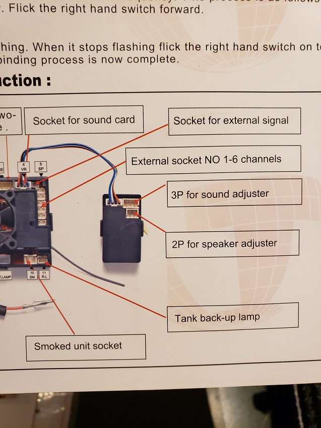

I know this is a old thread but I’m having a bit of a issue, I bought the later cylinder type tail light from forgebear and have the taigen v3 board and actually was going to reluctantly wire into the front headlight. I too didn’t notice there is a “taillight” plug until I saw this post searching for some other possibilities to wire it up. I had already cut the headlight wires and tested it, worked fine but I did not solder it, I had the right size plug for the taillight plug on the v3 board with wires attached already and spliced them together but it does not come on! When I kill the “engine” on the receiver and leave the power switch on it will then light up flashing. All other functions of the tank work as they should. Any ideas?

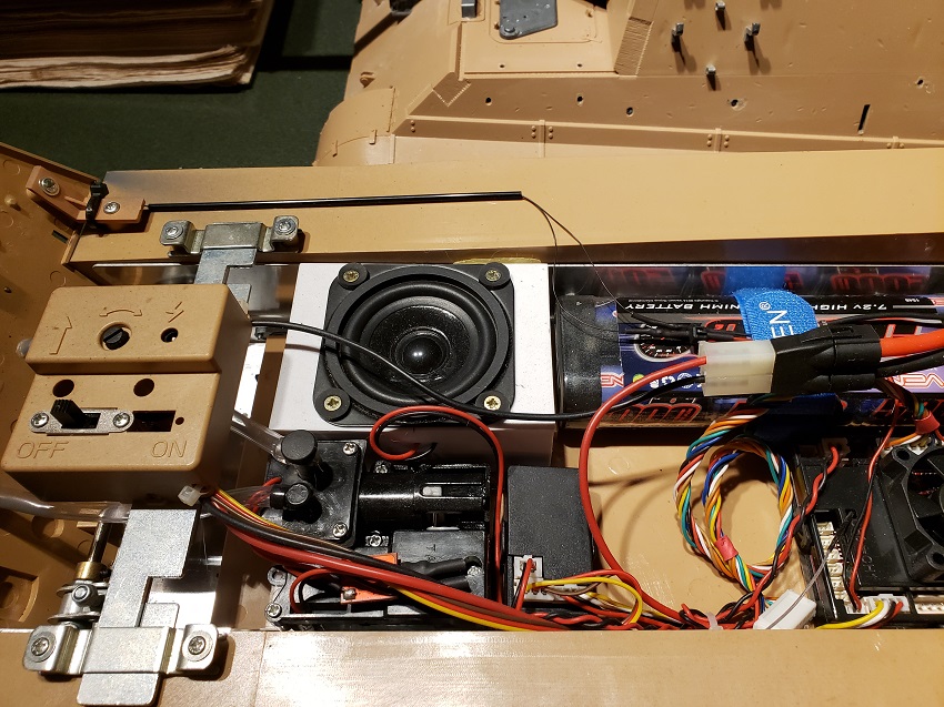

In the past versions of the Taigen MFU, the rear convoy or any added tail light would only come on when the tank was being driven in reverse. Is this still the case? I now wire the convoy light with an added plug and use the small plugin where you would add any external signal device. Works very well!

The front headlight is the taigen headlight I didn’t wire in a new one. I cut those wires and tested the connection there to potentially use as the power source for the rear taillight I got from forgebear. I decided I didn’t really want another upper hull connection so I started looking into other places. I did try the taillight spot on the v3 board but it’s only coming on in reverse I discovered.

Yes seems to be only coming on in reverse! This almost had me pulling my hair out :lolno: as I did not know it was supposed to be this way. I’m definitely going to try that external signal spot but I just realized I don’t have a connector that small..

Posts: 7866
Re: Convoy Light Hook Up?
Hello!
Jarndice has the right of it. I am going to order some myself as I just ended up a search in parts and spares and found none. As far as sizing, the space between the pins on the boards male connection is 1.0mm . Makes these the Mini Micro type of JST. I need to resupply so may as well order those ( China shipping )
