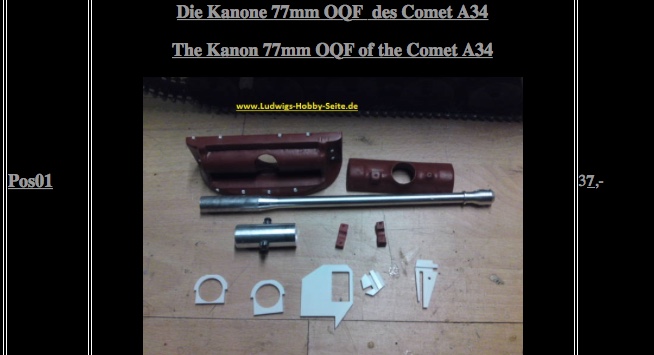

For prospective builders, you should know that there's a chance that the bits you order may no longer be available in the format seen in Chris' online shop. As I said before, some parts have been improved.
However, when I ordered 'Pos o4' (77mm Cannon) here:
http://www.ludwigs-hobby-seite.de/Comet.html, I assumed I would be getting these bits and bobs 'Pos 01' Britisch Tank parts (sic):
http://www.ludwigs-hobby-seite.de/Briti ... Parts.html It's the same heading, and price, after all.
I expected these to arrive: What I got, however, was this:

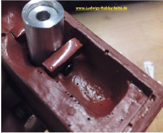

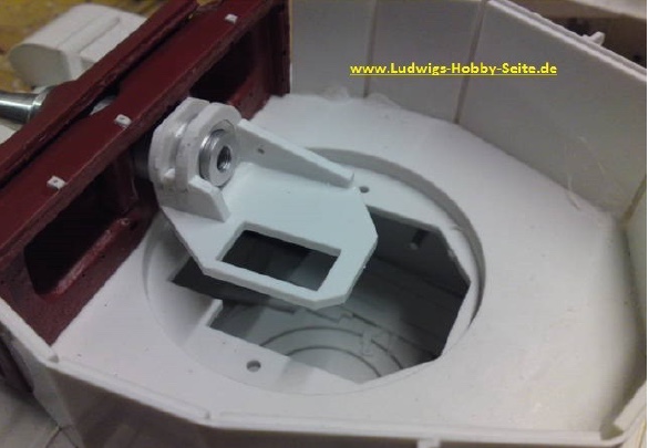

I have pointed this out to him, but it appears that the bits I thought I would be getting have either been altered, or are not available. This means I don't even have the barrel support and pivot assembly (trunnion)
illustrated here: The plastic parts for the recoil are also missing from the kit. Examples of them are seen here: This is all a bit of a muddle (Chris is a genius at designing and producing these kits...but, shall we say a little atypically disorganised, for a German, as a vendor selling them
Anyway, as it stands, I shall have to invent my own means of attaching the movable (elevating) part of the gun mantlet to the major fixed static part, whilst enabling it to pivot, and also enabling the barrel to slide.
Hmm...that's no small undertaking.

Hi
I have the same problem here, also the barrel is a 17 pounder.
Ill try to print a correct barrel when I finally start working on the tank.
Greetings Tim
Greetings Tim

Hi, You could put a Clark recoil unit and design the elevation around it.43rdRecceReg wrote:Anyway, as it stands, I shall have to invent my own means of attaching the movable (elevating) part of the gun mantlet to the major fixed static part, whilst enabling it to pivot, and also enabling the barrel to slide.
- 43rdRecceReg
- Posts: 6295
Re: Comet A34- Ludwig kit
Thanks, Tim and Louis.lmcq11 wrote:Hi, You could put a Clark recoil unit and design the elevation around it.43rdRecceReg wrote:Anyway, as it stands, I shall have to invent my own means of attaching the movable (elevating) part of the gun mantlet to the major fixed static part, whilst enabling it to pivot, and also enabling the barrel to slide.
Where there's a will, there's a way. It's just a question of finding it.
Louis, I used the Clark recoil unit on my (Ludwig) Cromwell project, and so that would be familiar territory. As for connecting the two parts of the Mantlet (Static and Elevating), I'm going to cut two vertical slots in the fixed section either side of the gun aperture, so that I can run two flat pieces of plate (styrene) through to bond with the elevating Mantlet. Then, I can drill the plates where they appear on the inside of the fixed section, so that a brass rod can be run through either side of the barrel, and fixed in place with the two resin retainers/ lugs provided with the kit. That should provide the pivot. Then a small portion of alloy tube/ or ABS tube
with an internal diameter of 12.6mm can be bonded into the outer elevating section to permit the barrel to recoil... Phew..
I could draw a plan out..but that would take more time than I have.
