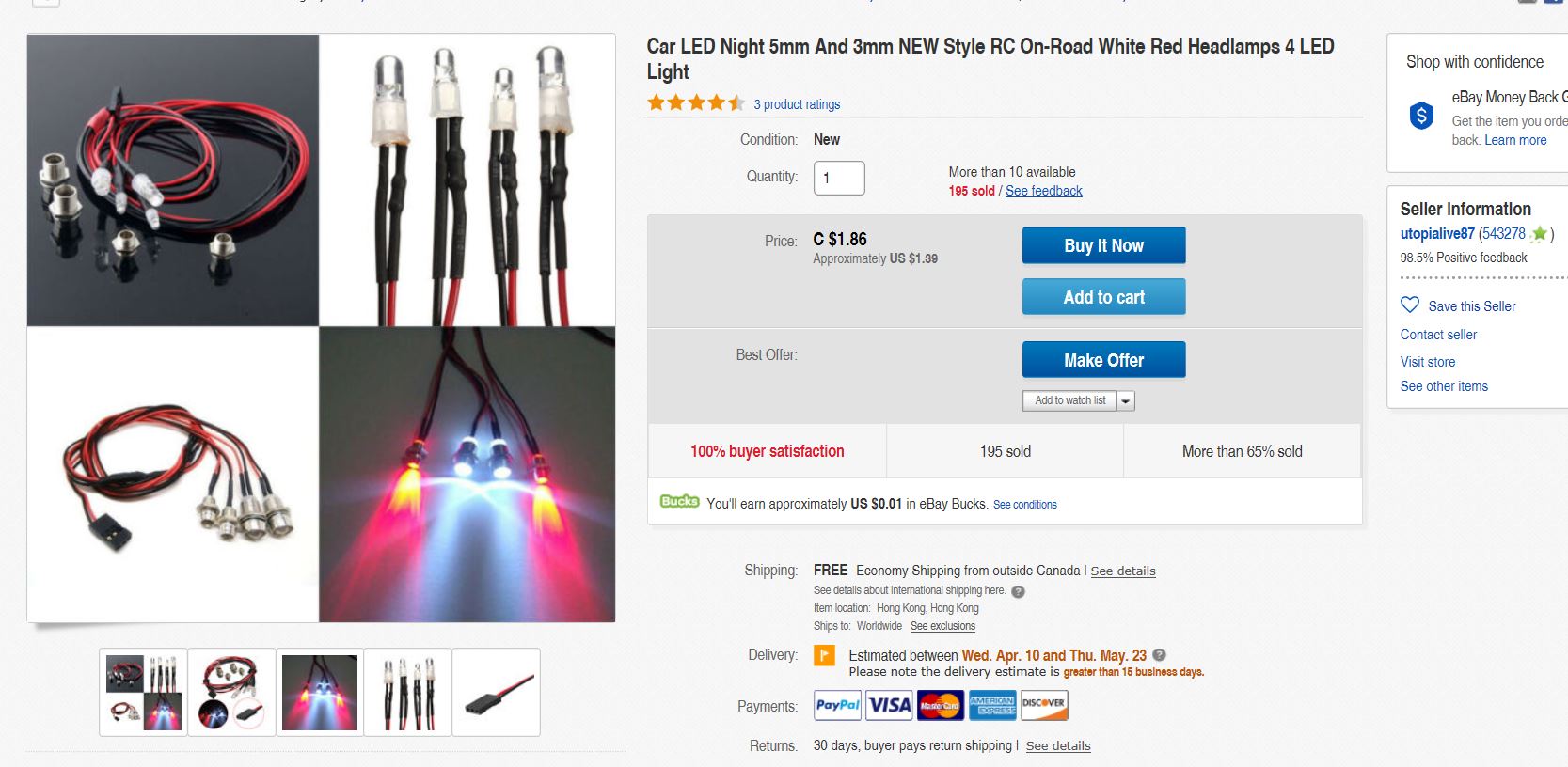

Re: LED instalation
I buy these cheap LEDs by the dozens for less than $2 with free shipping, has 2 white 5mm headlights and 2 red 3mm taillights. Pre-wired with resistor and connector to fit the receiver, or I simply cut the connector to adapt to board headlight wiring and control. I never had one of these burn no matter what I did to them.
https://www.ebay.com/itm/Car-LED-Night- ... ctupt=true
