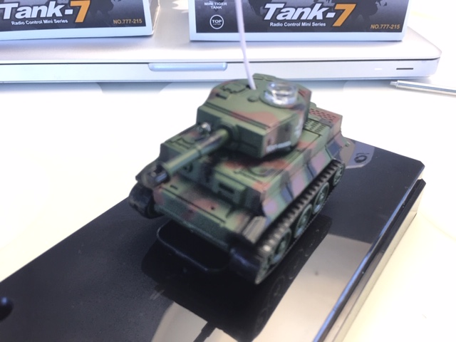

Pros..Well, I do like the plastic display case it comes in as it looks like a micro RRC IR battle tank and is a curiosity but once you drive it it is a letdown.

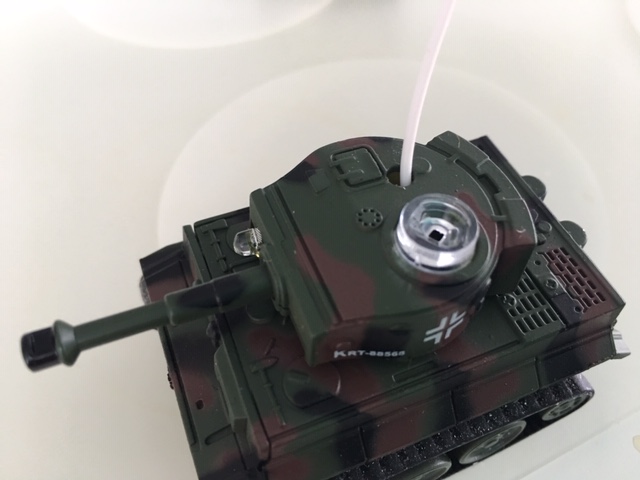

Fake IR detector. Well, this is an IR collector lens but there is no detector in the lens.
Looks like it has an IR battle system.

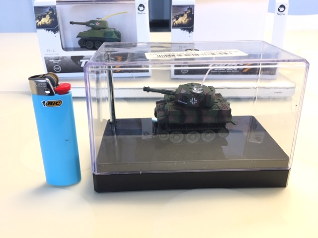

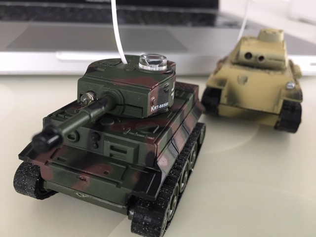

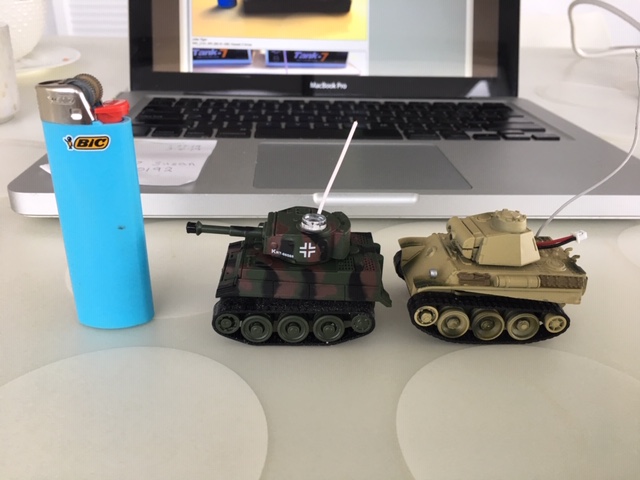

here it is next to the one I got from from ebay. I now have about $100 in 3 of these micro tanks. Wife would not be happy to know that lol.

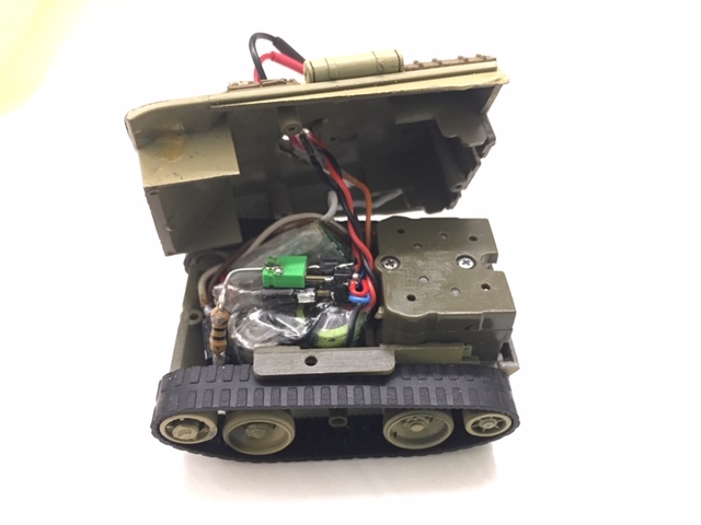

After owning these tanks a few days have decided to modify them.
Step 1.
The L&R track motors are wired in parallel as with most Tanks. I will wire them in series so that both motors are driven by 1 speed control and the other is used for steering. This will change the overall motor impedance so that there is less current being drawn and speed will be decreased.
Step 2.
A 2 cell 30 mah NiMH battery is used @ 2.4v. I will wire this pack in parallel so that voltage is 1.2v. This will reduce the speed further. Voltage will be cut in half and mah will be doubled. So it will go slower but run longer.
The downside to this mod is the goofy Turret Christmas ornament LED will no longer work the new lower voltage. Can't say I am too upset about that.
The onboard TX charger may need to be modified as well but it still appears to work but may be getting a bit warmer than usual.
I have already done the mods to the original micro King Tiger and like the way it runs now.

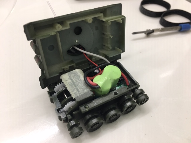

2 cell 2.4v 30mah NIMH pack is now 1.2v 60mah pack. A 1.5mm micro connector is added so that the battery is removable. There was some corrosion in here from the battery making me think these were built some time ago. Maybe as long as 10 years is my guess.

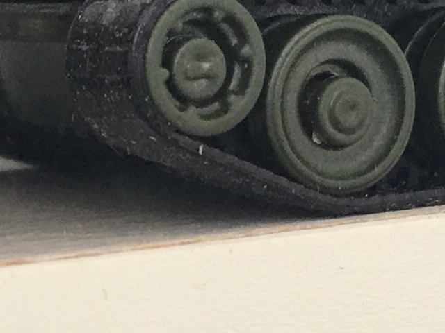

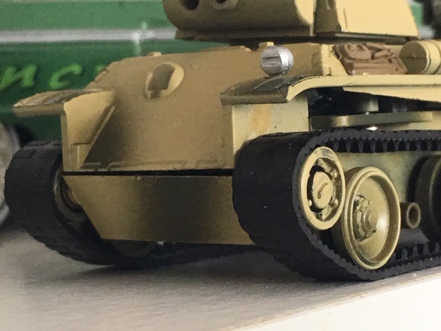

Center road wheel removed for now and tracking is much improved. The center wheel hub size will be modified to eliminate axle offset. Running it without the center wheel for now.
Once again on the ebay Tiger, this picture shows the road wheel lift due to center axle offset. IMO this spoils the tracking of the tank and makes it rock up and down as it moves left to right back and forth makes it look unstabil and toy like to my eyes.
On the Banggood Tiger, all road wheels touch the ground at the same time. The tracking is much better on these tanks but is even better after the series cell mod. Prior to the series cell mod the B-Tiger drove in circles and need constant correction to track strait.
On the ebay Tiger you can see the front roadwheel does not touch the ground due to center axle offset. The benefit of this is that the Tracks have less resistance to turning L\R. However, it causes a "clown " like stance and instability in tracking.

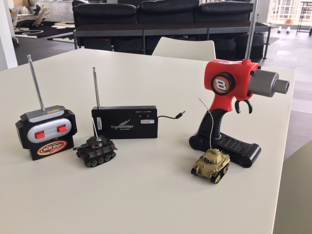

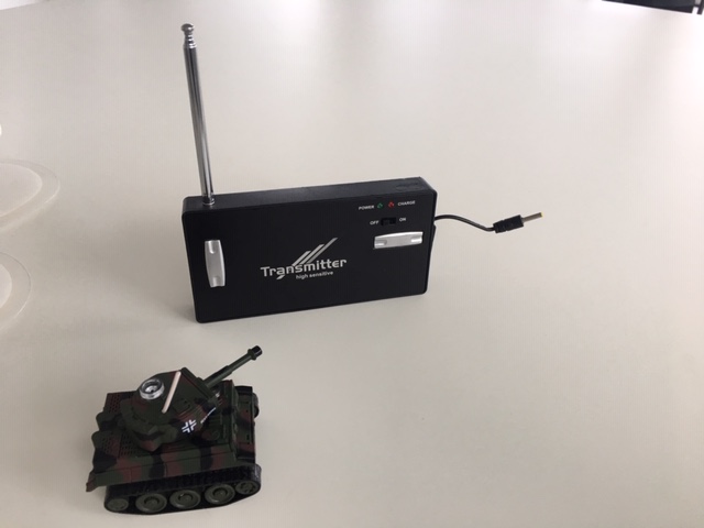

This standard type 1 TX works as you would expect with the Banggood Tiger. It takes both sticks up to go forward. All Transmitters shown are 49.14 MHz.
This TX looks like a car TX but is not. It runs the parallel motors just like the dual stick up\down but only needs the left stick up to go forward.
Both of these Transmitters work with the stock Tank with the parallel wired motors.
The TX on the right is a Type 2. The one on the left is a type 1. The one in the middle is a type 3 which has not been discussed yet.

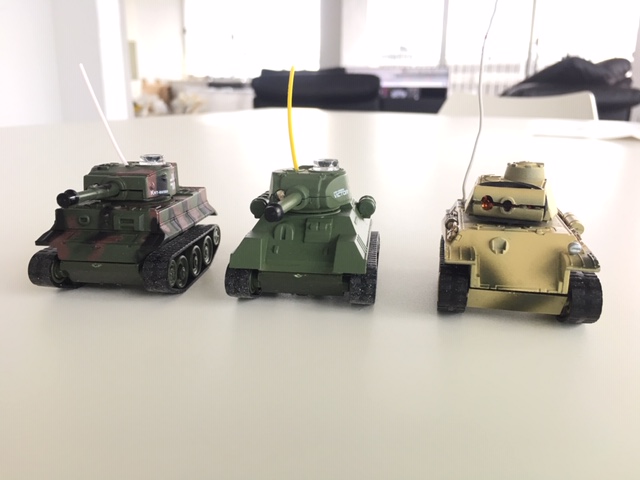

My micro Tank fleet.
