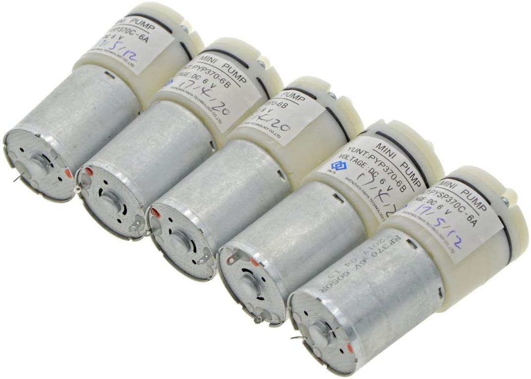

The new pump is much better. It is the same as simple aquarium pump, much more effective and quieter and you can get them everywhere. I have been cutting out the heating element/container from a standard HL smoker and mating it to the new pump to create barrel smoke, but sometimes it is too much and would be perfect for exhaust. Here is an example of the pump that you can get anywhere basically for cheap:
