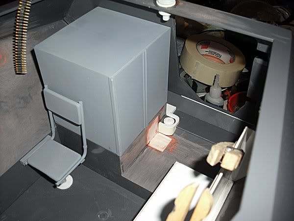

Update:

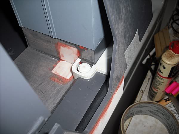

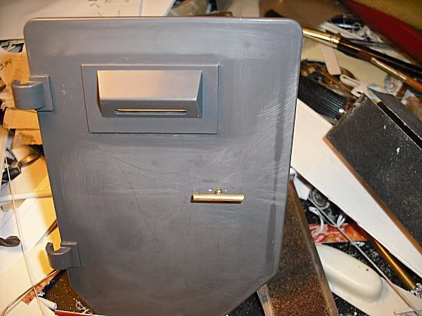

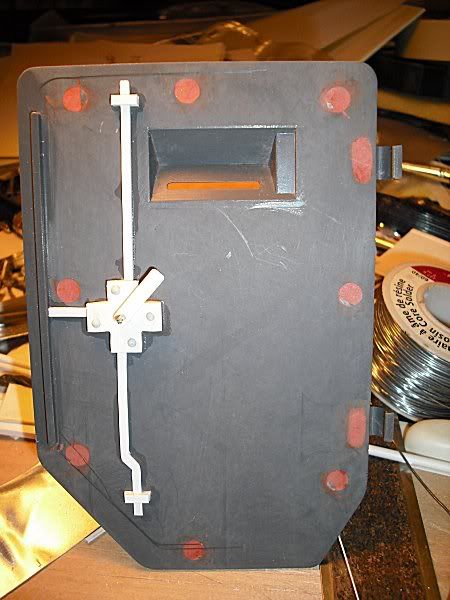

Progress continues with the 250... Here I have constructed the fuel filler spout and cap and guard. In the last 2 pics I have constructed the rear door latching mechanism and outside door handle. Next I will be constructing the medical box for the rear door

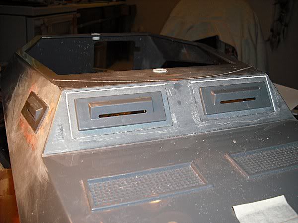

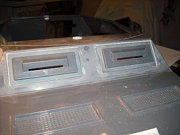

Update:

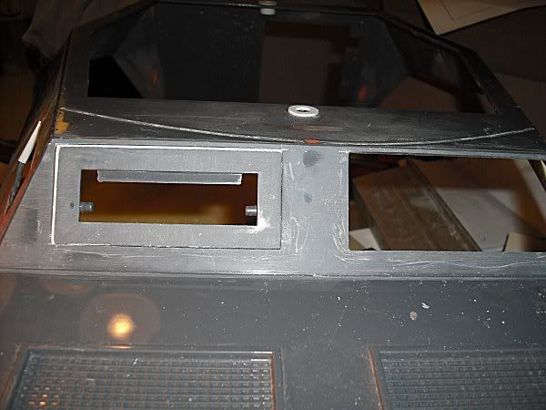

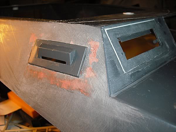

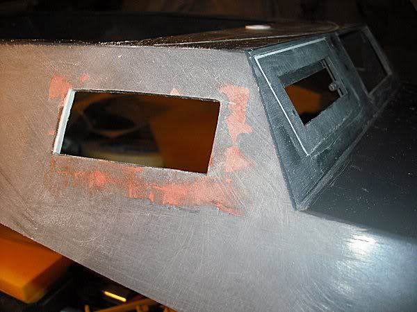

Well I decided to tackle the side and front vision ports. After chizelling off the frames on the side ports I figured there must be an easier way. So on the front ones I used a thin razor saw and removed the vision port by cutting between the raised ridge and the main part of the port. I then sanded off the raised ridge that remained. I then shimmed the section I removed to take up the gap left from the razor saw then glued them back in flush with the surface. Here are pics of the vision ports. Now it's just a matter of some spot putty and sanding to remove the seams.
