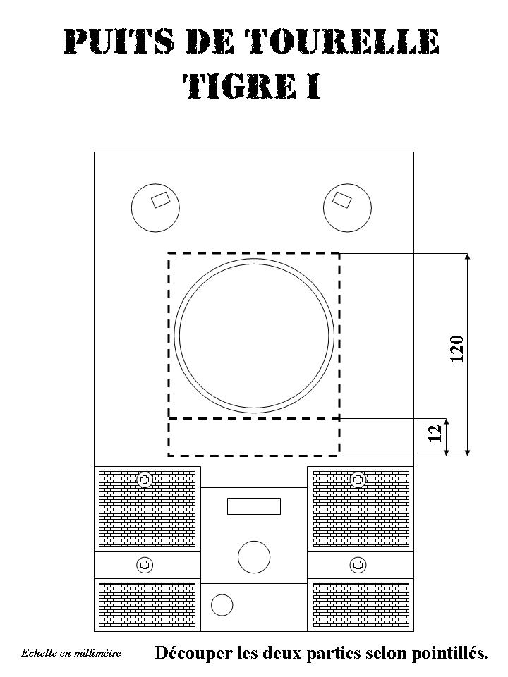

Hi Have Taigen and HL moved the turret ring into the correct position on the tiger? Nice upgrades going on here, filling the gaps round the mantlet is a good fix. The mudguards are ace.

I do not think ? In case ? Here is the modification to perform,
Before

Oh, awesome blueprints for turret mod... I think that I could to live with a wrong positioned turret, but this plans are very exciting :-)
Thanks for them…
