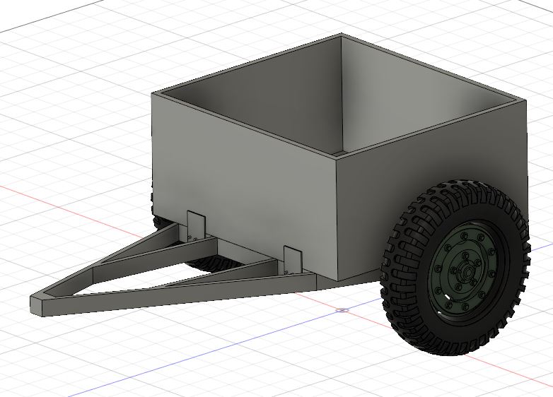

by Tiger6
m8 trailer.JPG (63.19 KiB) Viewed 7235 times
Still can't find any info on the upwards angle of the front of the trailer - it seems like a lot of the scratch builds out there have modelled the frame flat, where as it does appear to have a slight bend just before the box...
Re: Ammo trailer M8 - 1:16 scale
Posted: Mon Aug 13, 2018 6:06 pm
by easy8
according to my knowledge, the trailer is just a square box on wheels. The front size does not have an angle (just 90 degree). The drawing/design is very good looking !!
cheers easy8
Posted: Mon Aug 13, 2018 7:39 pm
by midlife306
It’s the angle of the frame that’s missing, on photos it kicks up a bit

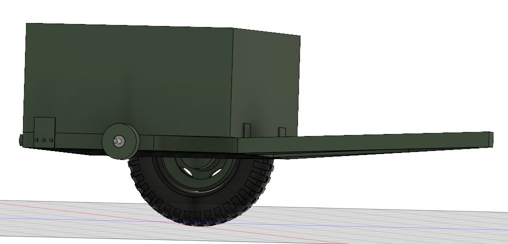

Posted: Mon Aug 13, 2018 9:58 pm
by Tiger6
Yup its very subtle, but the uplift is there. Right now I've just kinked it up at the box edge by about 5 deg or so, but when I get time I'll go back and make it a more gradual curve.
m8 trailer_2.JPG (43.75 KiB) Viewed 7204 times
Right now I have a 2x5x2.5 ball bearing in the dummy drum brake housings, not too sure how well that will work out for alignment so we'll have to see... I'm also having to model the M3 halftrack rim and corresponding tire, as they are different to what I've got done so far :problem: (the Dodge WC rim is in there as place holder for now)
I'm in 2 minds about the box lid - if I did it to scale, it would be about 0.4mm thick which would just curl up as soon as the Sun sees it. I could leave the lid off and let people model it in plasticard, or as I'm kind of lazy, maybe make the edges thin and then thicken it considerably like its a plug in the top - won't be able to open, but might take bright sunlight and warmth a bit better (the sides and frame width are way more than scale thickness for this reason!)
