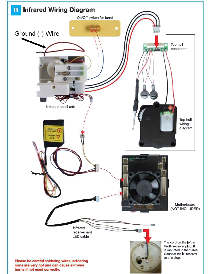

Ok folks, update pics..
One last query.. Can't get the mgs to light up, and the headlight is on permanent even when the power switch is off? They're wired as per this diagram
only difference is the Hull mg is wired to the board, the coax mg is wired into a plug to go in the socket above tags 1-3. Unless the turret connector plug is different on the 2.4? I'd like to get both the recoil unit and the mgs firing on the gun/cannon buttons on the tx rather than the 88 firing on the left joystick up.. Any ideas?
The addictions getting worse... Pantiger, WSN Tiger Mid, WSN T34....And now a Jagdpanther...HELP!!!
Raminator
Posts: 1309
Re: Wsn mid tiger rebuild
Post by Raminator »
Is this the newer generation (i.e. dual-sound) Heng Long board? If it is, you'll need to wire it up like this. If it's not, you'll need to wire it up like this:

cashybai
Posts: 100
Joined: Tue Jun 12, 2018 5:23 pm
Location: Rutland, UK
Post by cashybai »
Cheers Ram, it's the newer board as per your first link. I'll wire it up that way & see how it plays....
