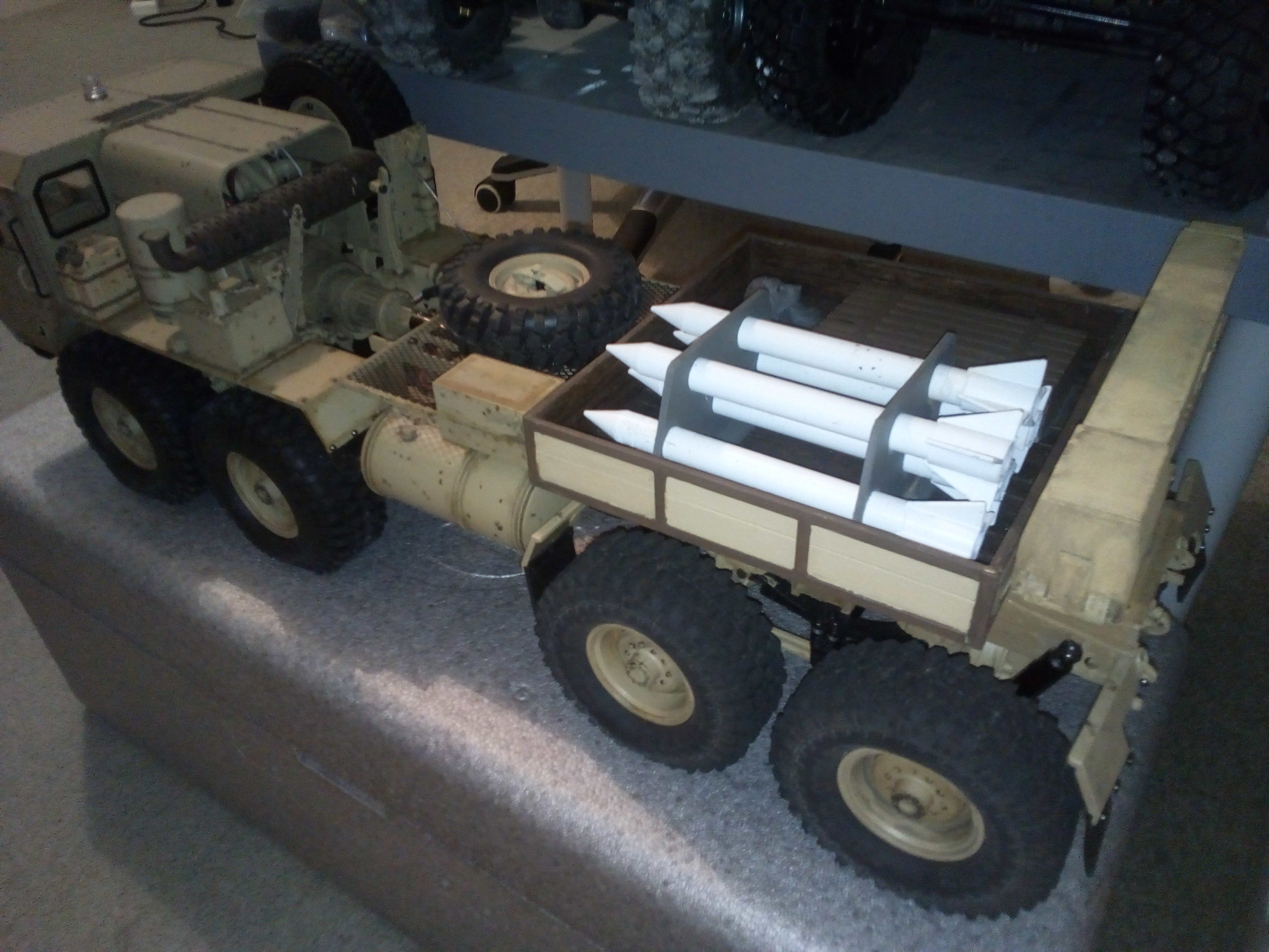

Post by Will01Capri »
Son of a gun-ner wrote:
midlife306 wrote:On a side thought, if Will stopped buying them, the whole Chinese economy would collapse lol
Wayne
:haha: :haha: :haha: that's really funny :D
Nice truck Wayne :thumbup:
HA HA
I only half half the population of trucks in the UK in my spare room haha lol
I do love these trucks though, but i agree with what Wayne says, we like to use them as a base to make more different builds. Now we have 3D printers we can make what we want, i LOVE IT
Those trucks builds are top notch btw ;)
PS i have all the files to make a HEMTT in 1/16, so watch the space
