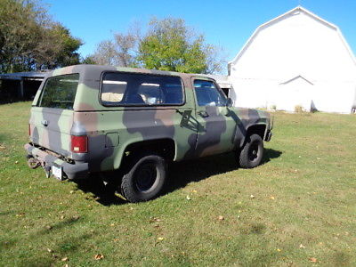

My Blazer
- 1986 M1009 Blazer 59k miles
- s-l400 (1).jpg (31.7 KiB) Viewed 2979 times
