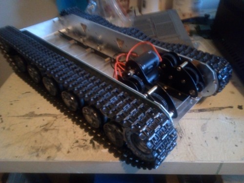

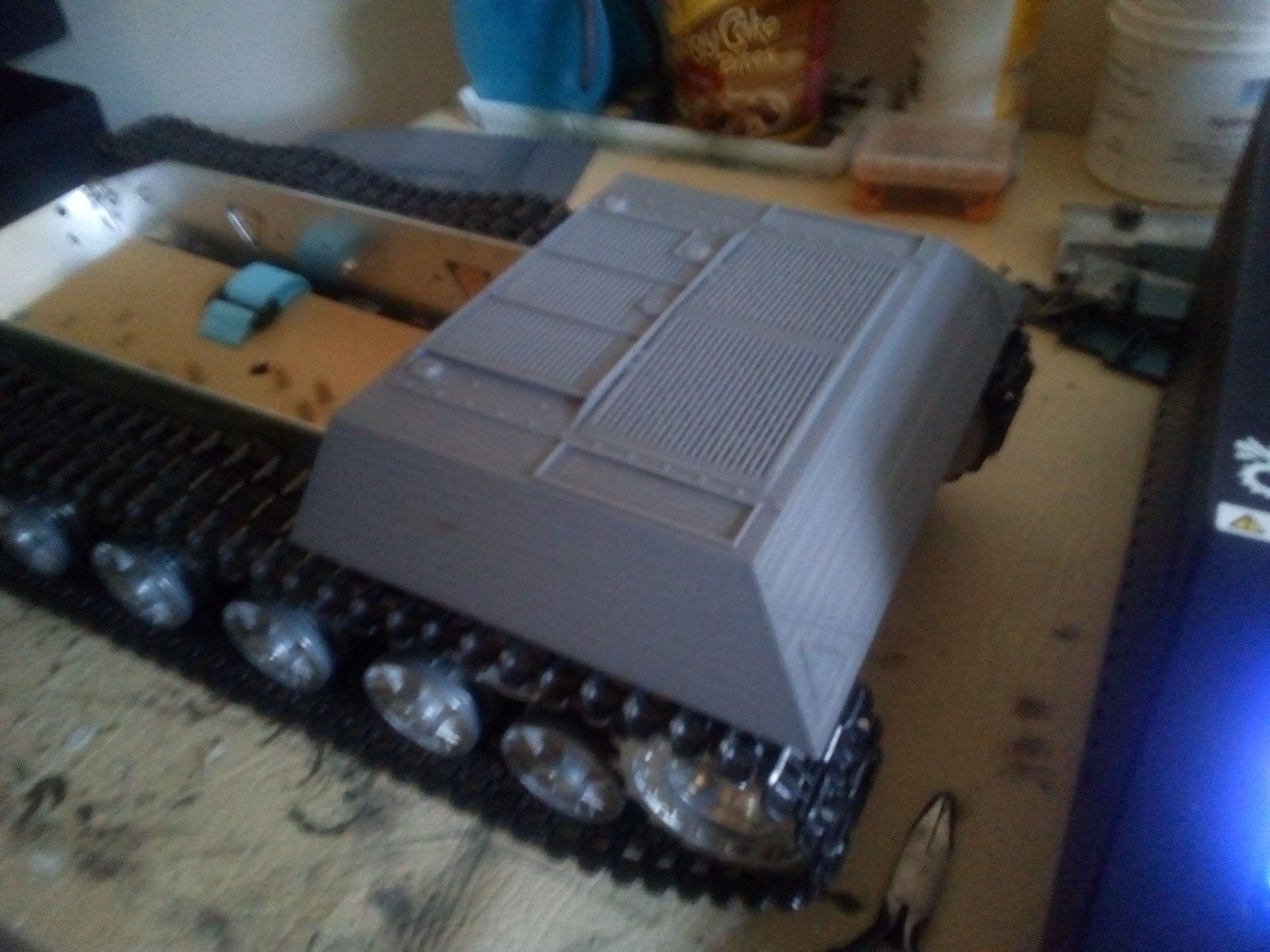

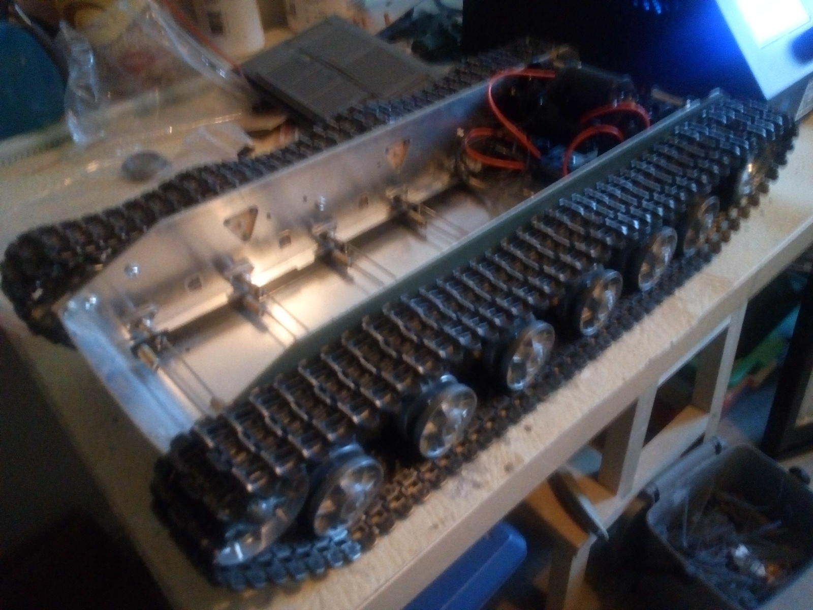

The lower hull arrived, so I assembled it just to make sure that all of the parts were there, and pulled off all of the KV1 parts that I won't need. The spare links that came with it were installed to get the track droop.

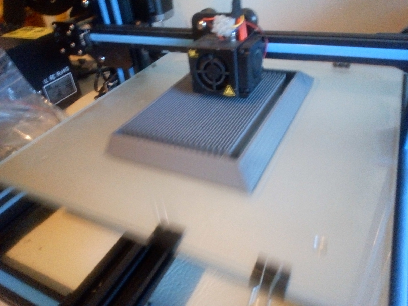

I spent 11 hours printing the rear deck, only to find that it wouldn't fit over the gearboxes, so I am now printing another which is taller, and will take 14 hours.

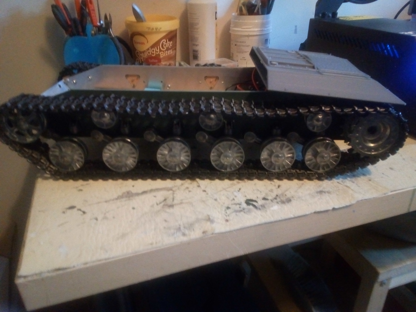

The lower hull is pretty heavy, so it should crawl around nicely. The upper hull is all 3D printed so it is as light as a feather.

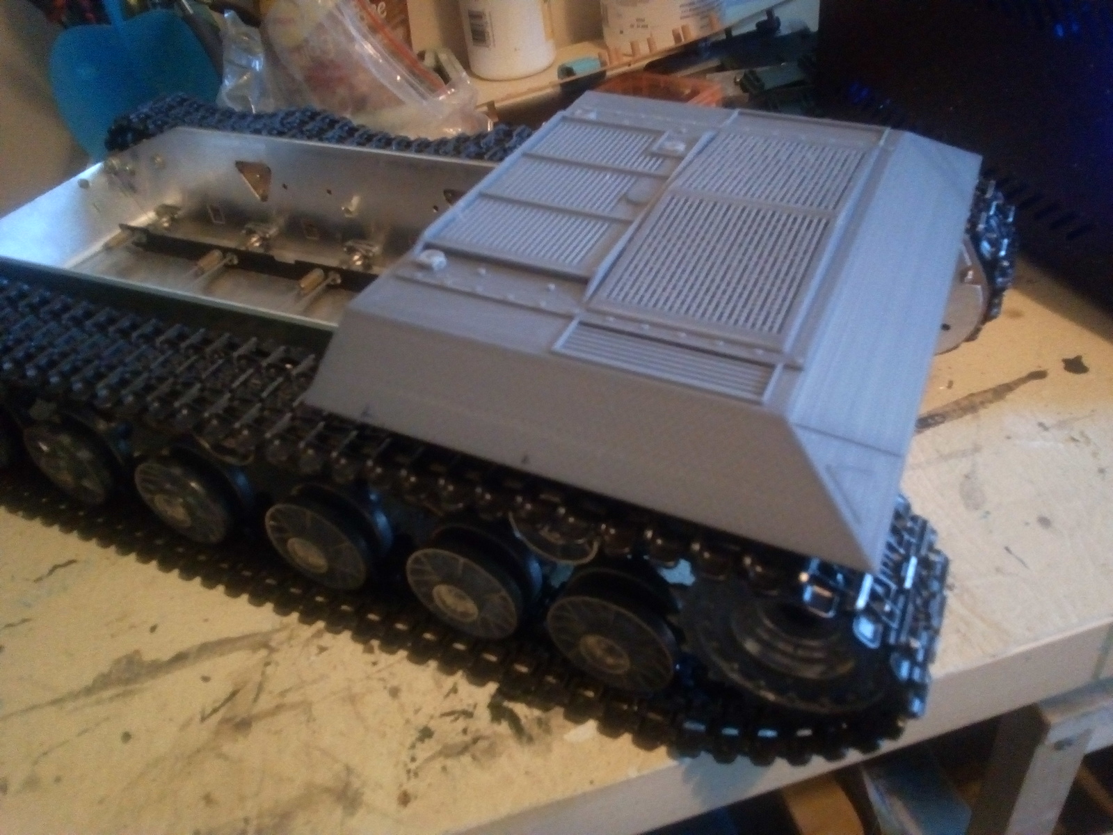

I sometimes feel guilty because instead of cutting up styrene and gluing it together, I am designing parts on a pc screen, loading them on to the printer...and going to bed. I wake up the next morning and all of the hard work is done for me. :S I have learnt how to design parts with all of the hatches and mouldings in one piece, so this whole build is very few parts. It saves print time, filament, and of course everything is perfectly positioned and aligned, with no gaps to infill, which makes everything nice and clean. The whole design is less than 400 lines of Openscad code, which is quite amazing really.
The rear deck reprinted, and clears the gearboxes. Just started the citadel, which is a 22 hour print.... 8O

Looks good. Did you use an infill to stabilise the shape during printing?
