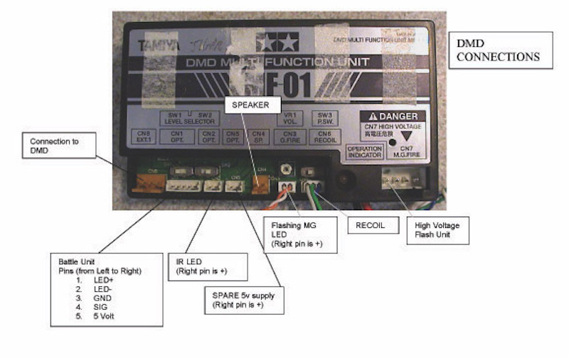

Yup, dismantling the MG can be a bit of pain... What I would do is to grab another led and carefully connect it to the CN3 and then, trigger the machine gun. If it works, you know the problem is in your machine gun´s led. If not, a faulty DMD unit, but this would be the first case I have read of...

Son of a gun-ner wrote:Could the LED be wired the wrong way around? If it was pre wired, it's still possible it was done at the factory, wouldn't be the first time silly mistakes have happened.
Good point......when plugged in, the orange wire is on the right (fore) and the white is to the left (aft). Anyone else with a M4 wanna check this for me?

LED's are of course, diodes, and in general they don't enjoy being wired the wrong way round. It is possible to plug the connector in the wrong way round, and so that's worth checking.

That's the orientation on my (working) Tamiya Panther G MG, Dayle. You can assume you have the right connection. :thumbup: Just check that the connector block halfway to the gun is also properly pushed in.
Re: Tamiya M4 105 Sherman
For confirmation of the correct wiring, have a look at this schematic for the typical DMD. You'll see that white leads are always on the left (fore), and coloured leads on the right (aft)
Tamiya Wiring to the DMD control unit...
Tamiya Wiring to DMD unit.jpg (81.8 KiB) Viewed 3273 times

A quick update: I tried to measure the voltage on the CN3 pins while the MG was "firing". My VOM registered nothing. Of course, I don’t know if I was actually measuring 0.0VDC or my leads were too big to accurately perform the measurement. I also tried to measure the resistance of the LED. I used braided wire strands and inserted them into the LED’s pin holes. I measured 0 ohms.....I don’t know enough electronics to know if a functioning LED should have a resistance or not. But, again, maybe my measuring technique was faulty.
This is when I decided to buy a replacement MG LED. I found Tamiya part # 7255019 on eBay and purchased it. It’s supposed to arrive next week. At that point, I can check to see if the DMD is putting out the correct signal or if the original LED is at fault.
As to SoaG’s point, my LED is wired the same as 43ReeceReg’s working MG......orange wire on the right. Whether o connect the LED directly to the DMD or route it through the extension, they both behave the same.....noise but no light.

Dayle Frame wrote:A quick update: I tried to measure the voltage on the CN3 pins while the MG was "firing". My VOM registered nothing. Of course, I don’t know if I was actually measuring 0.0VDC or my leads were too big to accurately perform the measurement. I also tried to measure the resistance of the LED. I used braided wire strands and inserted them into the LED’s pin holes. I measured 0 ohms.....I don’t know enough electronics to know if a functioning LED should have a resistance or not. But, again, maybe my measuring technique was faulty.

With the LED cable removed from the DMD, You can test the LED with the Diode/Continuity tester section of your multimeter. The appropriate readings (good and bad) for your meter should come with its handbook, but should be something like this, but I expect you know all this:
http://en-us.fluke.com/training/trainin ... meter.html
I often use pin to pin coloured breadboard connector cables to connect units like the LED MG to my Multimeter, that way you get a good connection, and don't need three hands.
