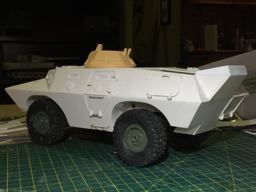

				Hi, thank you everyone for your encouragements.
Continuing on this relatively fast build.

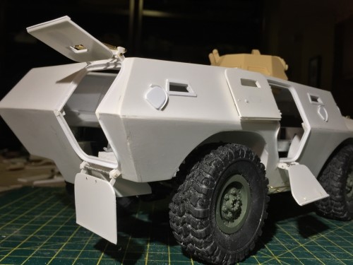

The right side has been completed along with the rear hatch.
			-  Ludwigs V-100 Commando

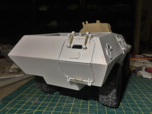

The rear hatch is complicated by this opening mechanism, as seen in  Squadron Signal V-100 walk around.
Someone could easily spend 2 weeks or more recreating it with the various elements. As this is not my style, I am just a guy with basic hand tools and degrading eyesight... I recreated it the best I could, a 2 hour job in total. I think it is enough detailed to satisfy my average modeller requirements, without getting discouraged or over my head.
It still need some fine tuning. The hinges on this armored vehicle are very small and there is a limit to how small they can be made with plasticard without breaking, but I think I can still reduce them a bit to be closer to scale. Also had to adjust everything to the hole created for the door, which is not exactly accurate.
And it still need to open... I will likely have a figure in the back, manning an M60 machinegun.

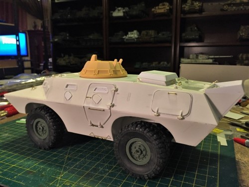

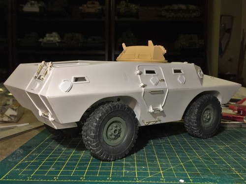

The model as it stands today.

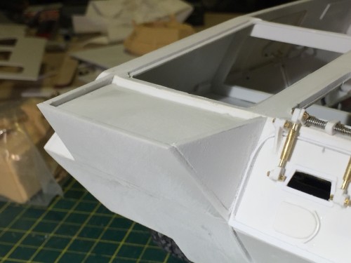

Tonight was the turn of the exhaust stack. It is quite large for such vehicle.
			-  LudwigsV-100 Commando
No parts at all are provided by Ludwigs for the exhaust so everything must be studied from pictures and built from scratch.

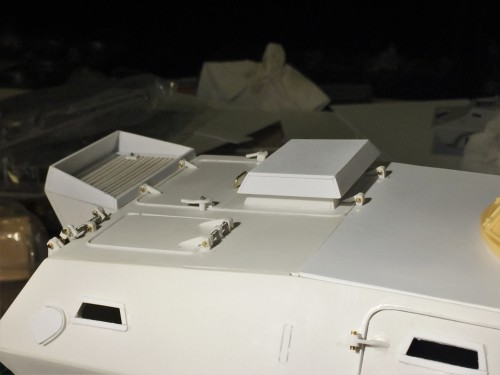

Yeah, that big armored exhaust stack is protecting 2 mufflers inside. It breaks the perfect lines of the vehicle a bit but it got to be there.

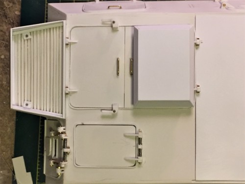

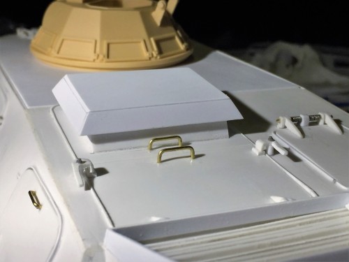

Now, the engine top hatches.

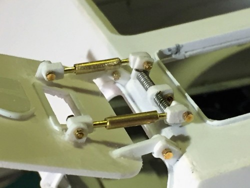

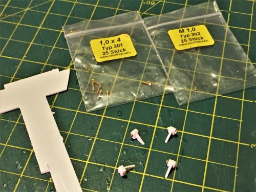

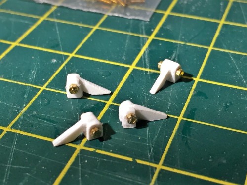

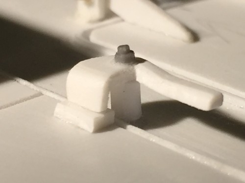

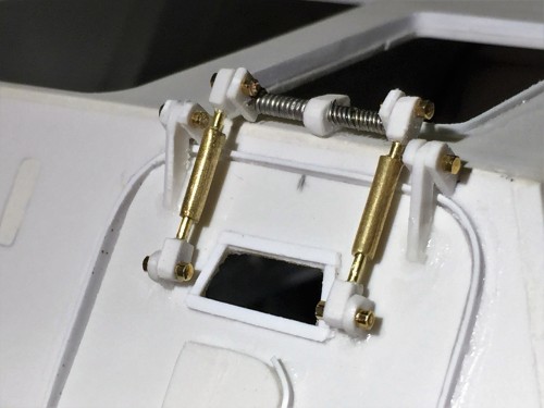

I am finally done with the hinges. To build this model, you need to make 26 of these, most functional if you want to open the crew hatches, carefully...
I do not recommend using the oversized kit parts as the base for the hinges, it seems that downsizing them only make things more complicated. I recommend creating a small assembly chain with part cut at the right size from leftover plasticard from the kit and assembling them all at one. Knupfer M1x4 type 301 bolts and type 302 nuts being required.

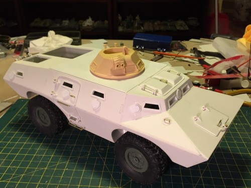

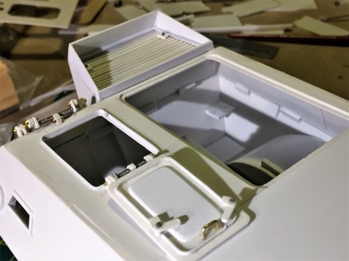

Very little is provided in the kit for the engine top hatches, only a base plate, so everything you see need to be scratch built, including installing a light plasticard strip for the gutter around the hatch, all of the hatches actually.
The cover you see on top of the engine air intake was added to production vehicles to prevent cocktail Molotovs from entering the engine compartment.
This engine hatch was not made to open so I created a static latch. I did not think my plasticard hinges would last long with such big hatch. More skilled builders than me would certainly want to create metal hinges for this vehicle. I am not at that stage yet.

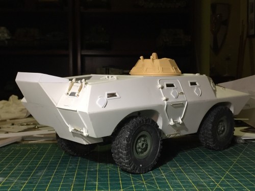

Top rear view

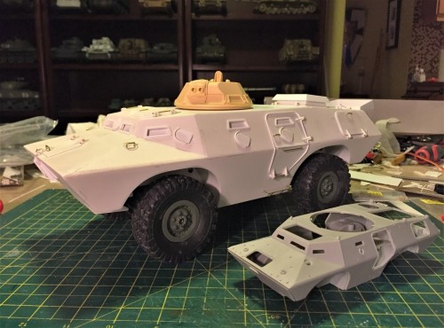

Getting there
Next to a 1/35 kit chassis that is also helping as reference.

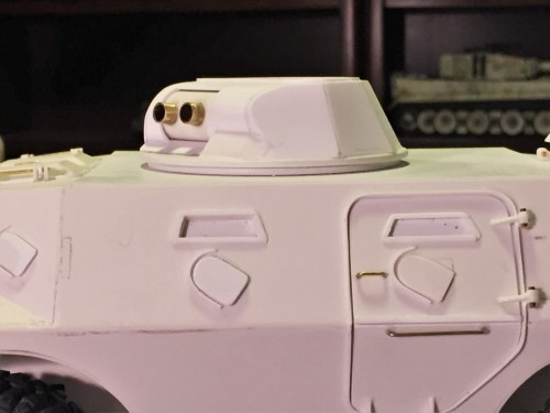

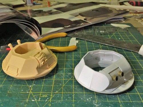

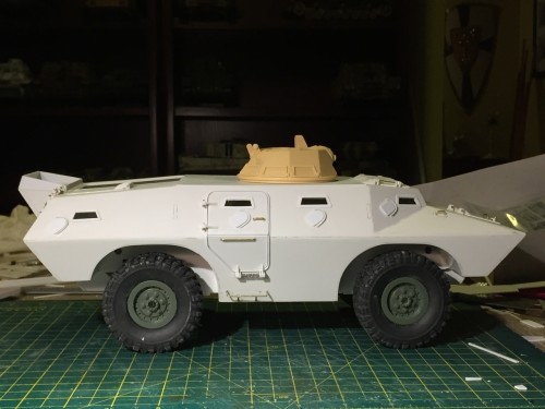

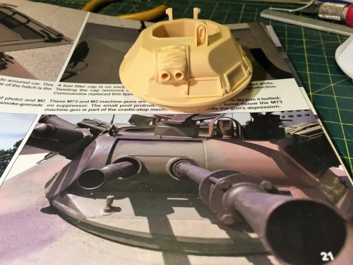

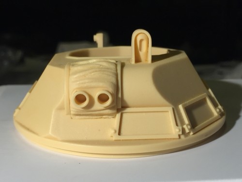

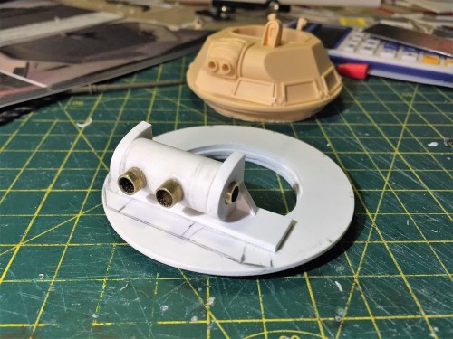

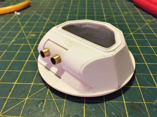

Here is a snowy Sunday project, a V-100 turret, Part 1.

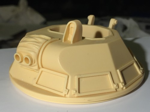

My initial plans were to mimic the Warriors resin turret but it did not take me long to notice that once compared to reference, it has many issues and cannot be used as a model. The angles of the armored plates should be around 63 degrees instead of 55. And you can see that the distance between many key markers are wrong.

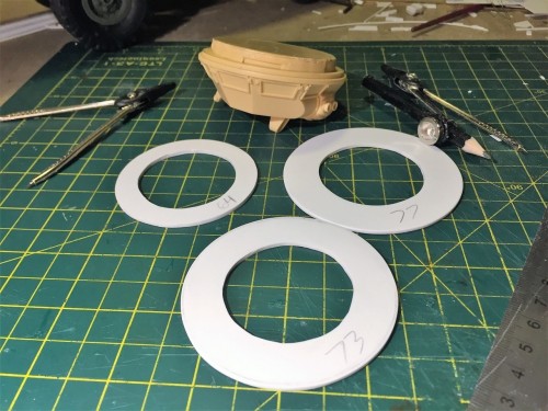

			-  Ludwigs V-100 commando

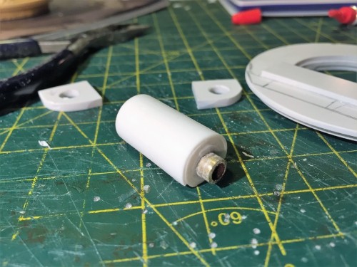

The first step after having gone through all available references is to build the 3 rings to be used as the base, with 64, 73 and 77 cm diameters, without being verified against accurate blueprints.

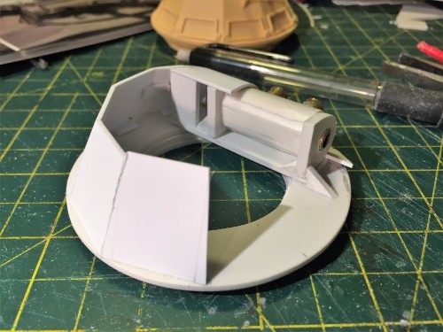

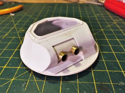

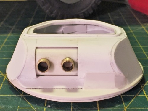

The mount for the Machine gun is made of glued overlay of plasticard tubes of increasing sizes, over a central brass tube core.
Creation of the turret, it went rather smoothly, making sure the angles and height are respected at every steps.
The core components of the turret are created. The turret is of an easy design so it is equally easy to build it with basic tools (blade, ruler, pen...) in relatively short time. It took about 6 hours up to this point, with no major mistakes slowing me down.
Next steps will be to create the hatch, visors and other small details. The turret offers the ability to be armed with either two .30 or a combination of a .30 and .50 Cal MG.  My turret will of course have an M2 50 cal.
