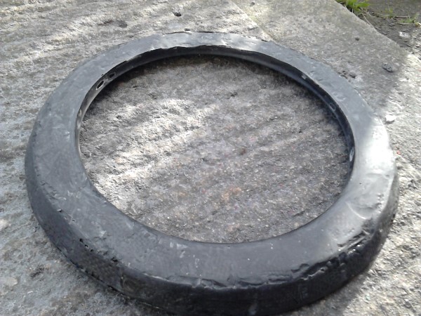

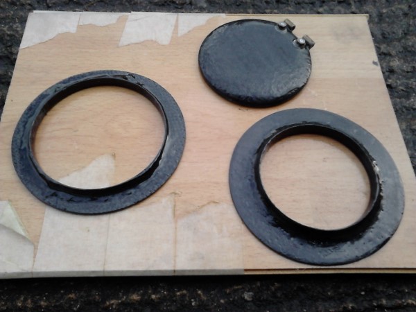

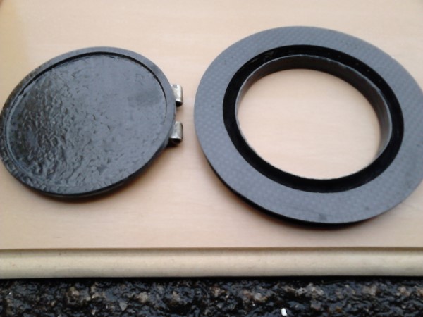

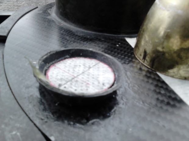

Cf ring for turret/lid looks workable.Its rigid, and should maybe add that four layers was minium. The Celebrations lid, had a drop, inner, so used this area to build over curve, and add strips outer. Its kinda rough on the B side, will maybe sand some more.

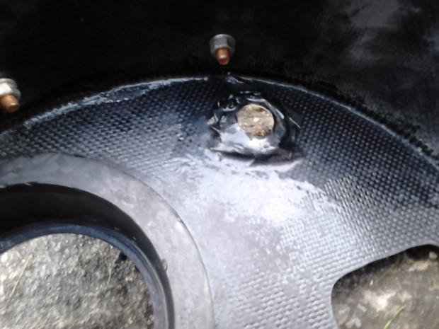

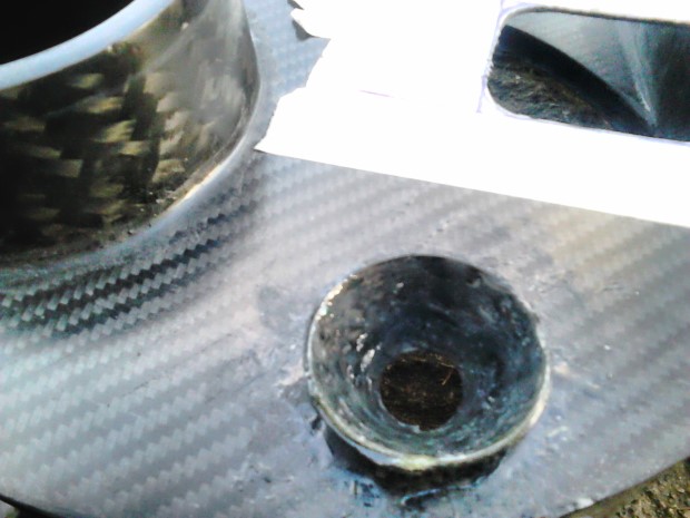

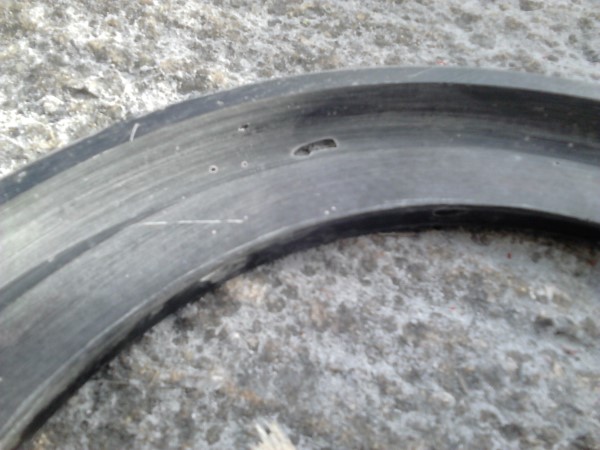

The worst area of repair, doent look to affect any future use. Will add resin to worker area, with cloth after any repairs, which helps on smooth surfaces.

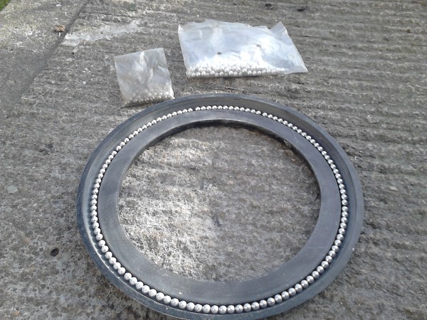

The six mills, look to run ok, and could maybe just cheat, and add round plate on top, the balls rise just above inner circle.
Have looked at rubber seals, online, and found possible pattern, reckon its worth having ago at top ring for this are.
The sixes could be increased, the hollows, got now dont seem functional....they also have a ridge.....maybe steels would wear surface of cf too quickly...
- Rough B side.
- DSC_0197.jpg (92.35 KiB) Viewed 2544 times
- Repair needed.
- DSC_0195.jpg (61.13 KiB) Viewed 2544 times

You could use plastic air soft BB’s or beads if your worried about the steel balls.
Wayne
Wayne
Re: CF Tiger 1.
Hi Wayne, thank you, will order some.

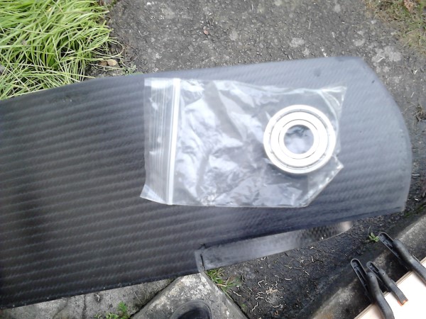

Found some possible bearings for front of turret-gun mount.

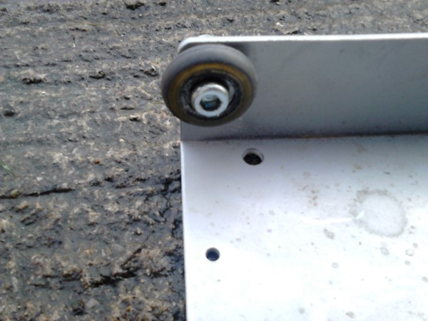

souced some more load bearing wheels, but reckon there alittle on the large side, and theres only four, thought five minimum.

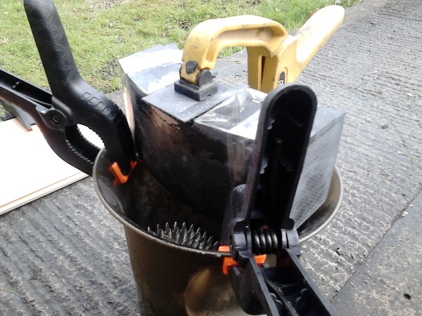

Have assembly to sandwich top hatch seals, maybe some room for rubber seal also, and have ordered a seal as pattern, think its travelling snail mail.

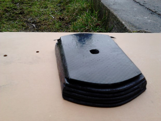

- Maybe better option.
- DSC_0212.jpg (59.41 KiB) Viewed 2519 times

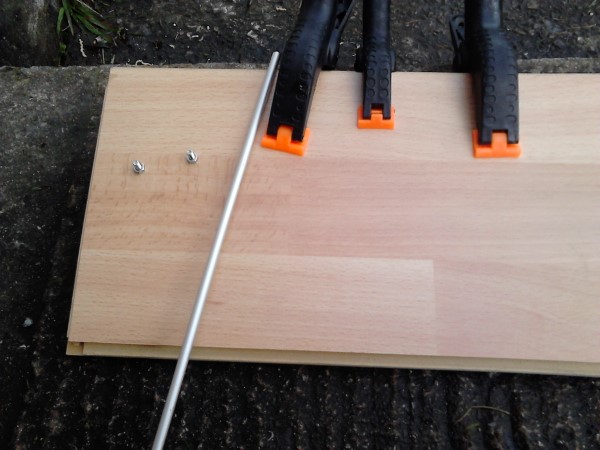

- Possible hinge jig/pattern.
- DSC_0214.jpg (60.01 KiB) Viewed 2519 times
- Rear box being added to.
- DSC_0215.jpg (87.6 KiB) Viewed 2519 times

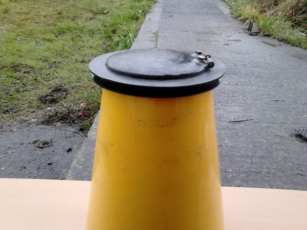

Top hatch assembly looks ready to binding and hingeing together. theres room for extra sealing.

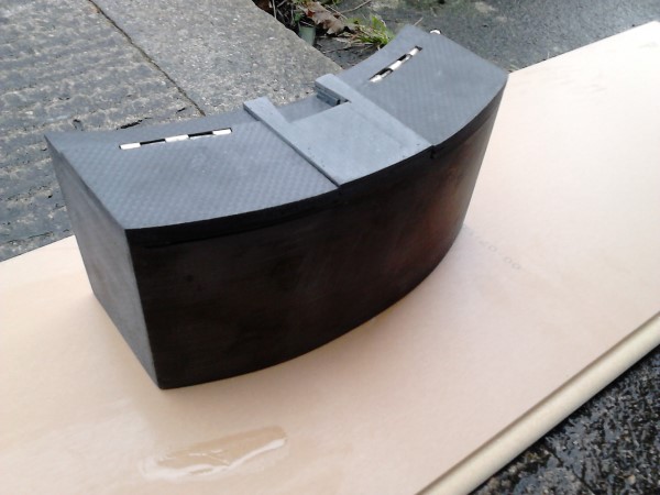

Rear box still needs working.

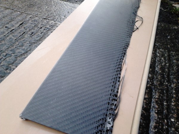

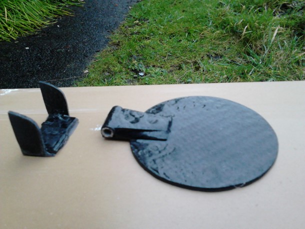

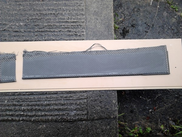

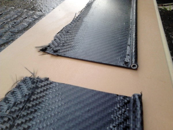

CF ally hinge looks useable. Had placed two boards, next to each other, buttered cloth, placed ally tube ,rolled and sat.
Has pretty uniformed thickness, and cloth gripPed well around tube, looking at various sources, maybe this is way forward for tracks, maybe the guide could have seat, and be sandwiched.
- Underside view.
- DSC_0206 (600 x 450).jpg (69.38 KiB) Viewed 2496 times
- hinge plate.
- DSC_0202.jpg (57.9 KiB) Viewed 2497 times
- Timmed edge DIY hinge.
- DSC_0203.jpg (92.53 KiB) Viewed 2497 times

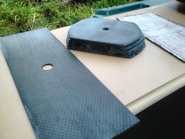

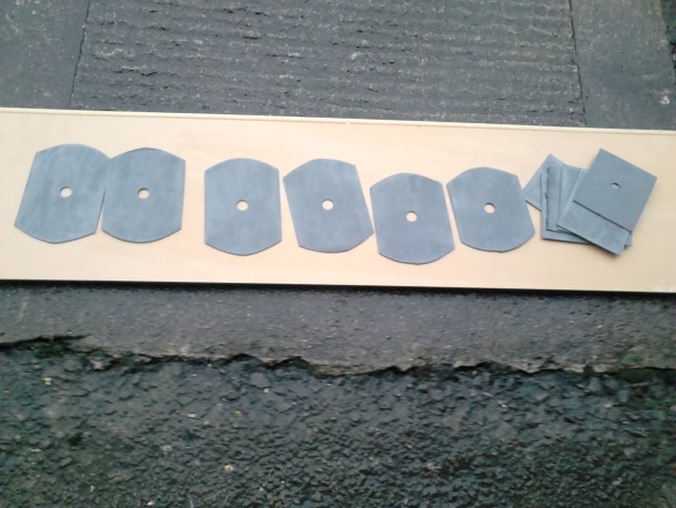

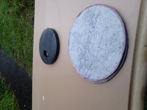

Cut and resined section for gun mount...around twelve pieces, each four layers.

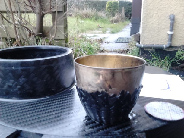

Re: CF Tiger 1.
Not exactly that...but gave ithis ago....HERMAN BIX wrote:The stuff that Americas Cup racing is all about
Like dring an oven.
- Projects. (6) (488 x 288).jpg (43.92 KiB) Viewed 2432 times
