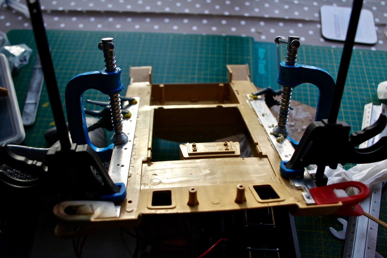

Here's the fit at the front with a little help from a clamp:
StuG IV front with with clamp support

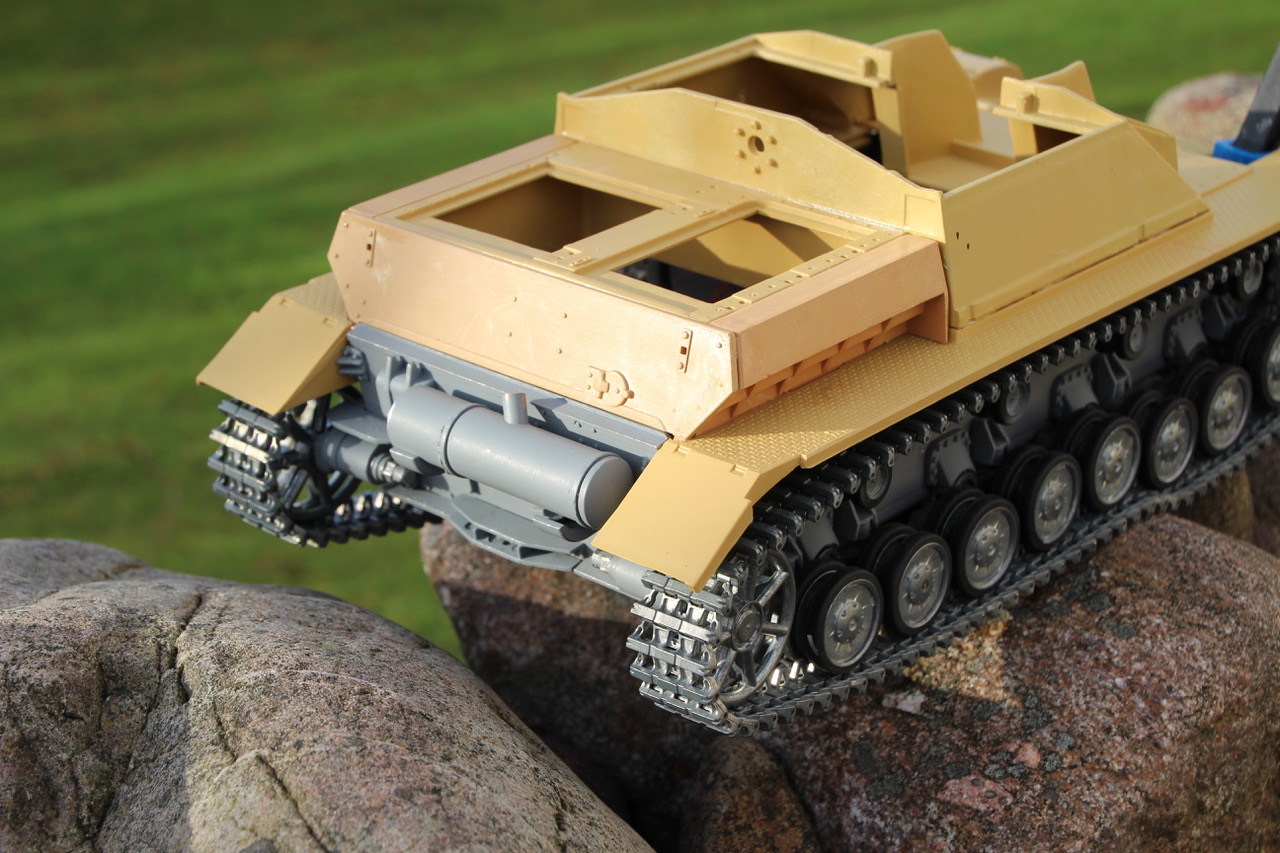

..while the fit at the back is pretty good, and a testament to my surgical skills :/ :/ :D Just imagine another 10mm or so of alloy hull sticking out the back..like unwanted booty'..and you'll understand why such drastic surgery was needed. :problem:
Asiatm StuG IV -view of rear fit

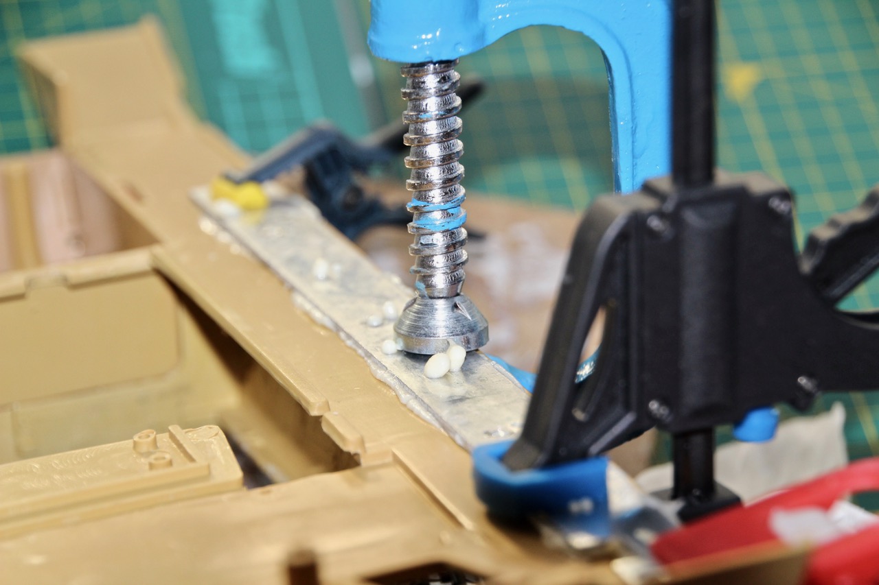

Now, while I could compensate for the Tank's turned up nose with a few concealed brackets and screws, it's not a satisfactory outcome. It's bad enough having to fill all those yawing gaps in the bodywork up with Milliput, or Vallejo Putty.
So the only thing for it is permanent orthopaedic traction. The means bonding some stiffeners (straighteners) in with epoxy, to keep the wayward front attached to the front panel.
Asiatam StuG IV- orthopaedic traction pic A
Asiatm StuG IV- orthopaedic traction pic B
I'm going to leave the Epoxy to cure for 24 hours. Then I hope it won't requite further intervention...
There should be plenty of clearance between the alloy braces (off a Tiger I) and the tracks.

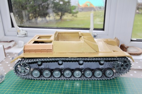

Well, here's the result of the traction treatment. The aluminium stiffener has reduced the frontal snubbed nose look to a minimum. With Tamiya style hull attachment points fitted at the front, it should disappear completely. :think:
StuG IV given a bit of British backbone...

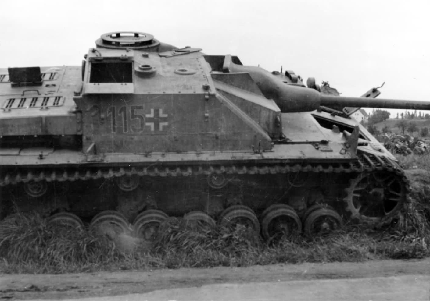

Now I need some pics to work with..a sort of artists' model (except I'm no artist ;) ):
I like this monochrome shot of an abandoned StuG IV:
StuG IV  No 115- abandoned
StuG IV - No 115- abandoned.jpg (92.34 KiB) Viewed 4074 times

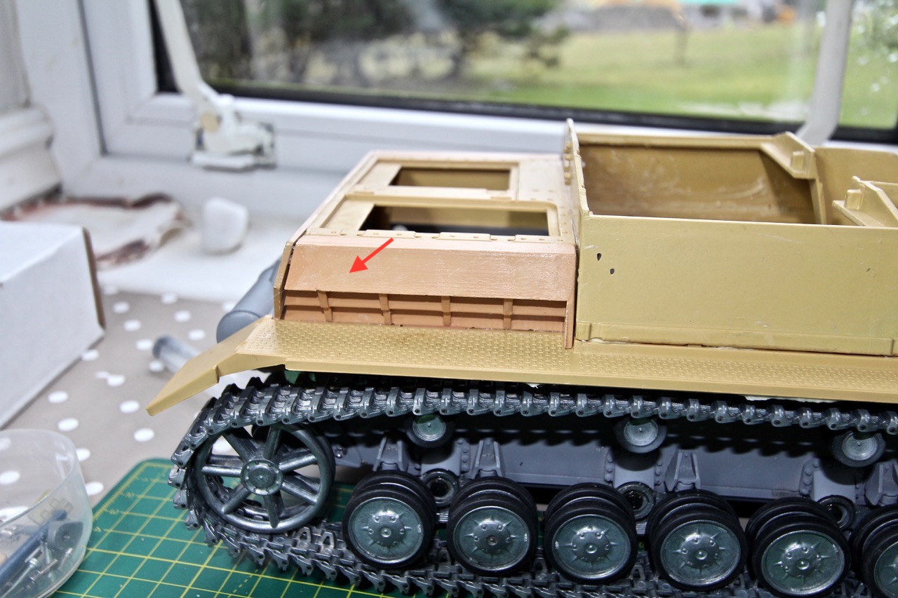

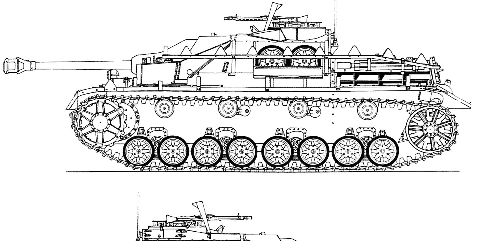

and this for detail- especially the angled engine deck this model has got entirely wrong :thumbdown:
StuG IV early model in blueprint form
That rear deck has got an appointment with my saw in the near future :-< :D

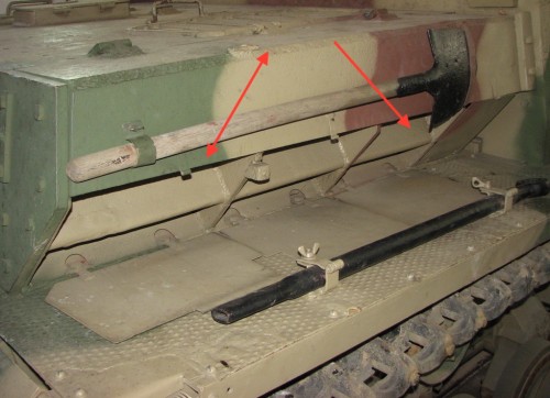

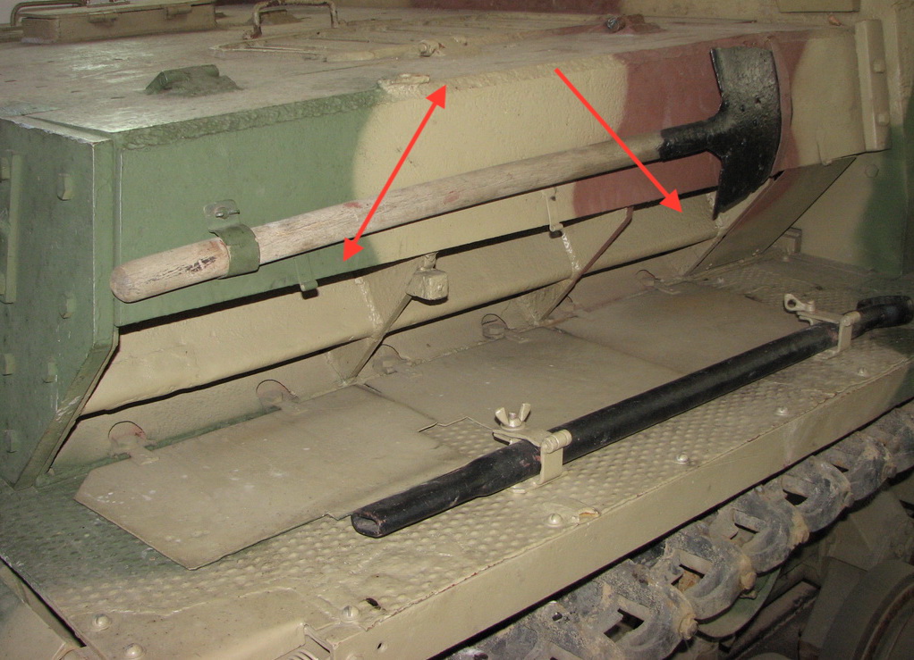

Just look at the differences in the ventilation louvres too.. :O
Stug IV louvres
Stug IV louvres
and Mr Tam's somewhat fanciful interpretation :-
(note: 'Tam' is actually part of Asiatam's CEO's name, and not to be confused with a shorter form of 'Tamiya'. Mr Tam's models are short on Tamiya's details, as much as his surname is on Tamiya :haha:
Sorry for that. "At least he's out there trying", you might say. Yes, I grant you that, but his products are very trying... ;)
The Tam version has one too many divisions, and all divisions are spaced regularly; where they're irregular on the real thing. Yes, they can be blanked off with hinged covers, but he still has one too many, and they're too symmetrical.
In addition, just look at the gaps I'm going to have to fill with Milliput, or VJ Putty 8O

Whether it is reality or optical illusion, comparing your upper hull to the photo, do your track guards kick upwards at the end? They rather remind me of skis. P'raps the hinged parts could be adjusted?
Re: Asiatam StuG IV conversion kit...
Estnische wrote:Whether it is reality or optical illusion, comparing your upper hull to the photo, do your track guards kick upwards at the end? They rather remind me of skis. P'raps the hinged parts could be adjusted?
If you compare it with the blueprint above, Estniche, I don't think there's a world of difference. Do remember, moreover, that I'm working with Asiatam parts here..and that's a world of pain and inexactitude. :|
Also bear in mind that the hull's just sitting there unattached..and unstressed. Eventually, it will be fixed to the lower hull by a means as yet to be devised; but it could be magnetic. :think:
Illusion and reality? I think we'll keep Metaphysics out of the thread, but suffice to say that you're all a figment of my imagination- as is the phenomenological World- especially after a Friday might slurp :haha:
Nah, I never did like Bishop Berkeley's ideas..
'Hinged parts".. are only theoretical at this stage, unless you're seeing things I'm not.. :haha: However, I might well add some bespoke hinges to the mudguards later.. :think:
