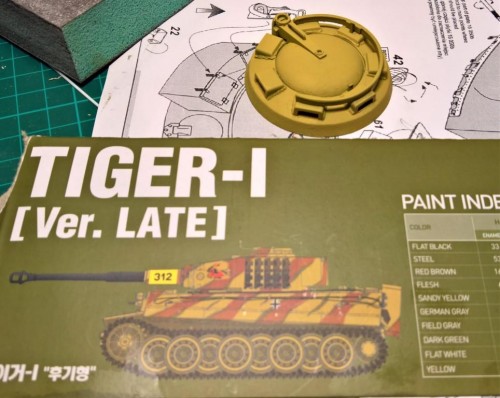

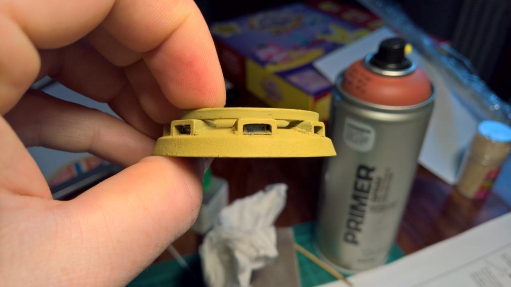

Meanwhile I tried the Revell colour 36116 Sand Matt, which is in the Academy callout for Sandy Yellow. Well I sprayed it well thinned on a solid black matt basecoat (AK black primer). I wasnt impressed at all. You have to spray it really solid to not make it look blotchy. Then I felt it was much tooo yellow. I had expected more of a beige sand colour. Like on the cover artwork, but it matches the side artwork close to 100%. Im not yet sure though i I want it like that.

Soeren will you attempt to paint with a different product?
Posts: 11974
Re: Tiger build planning
Bear in mind too that it will darken & alter once washed and weathered ...............

I will try it on the turrets first with camo and wash, filter and oil modulation. If it doesn't work for me, I can still change.

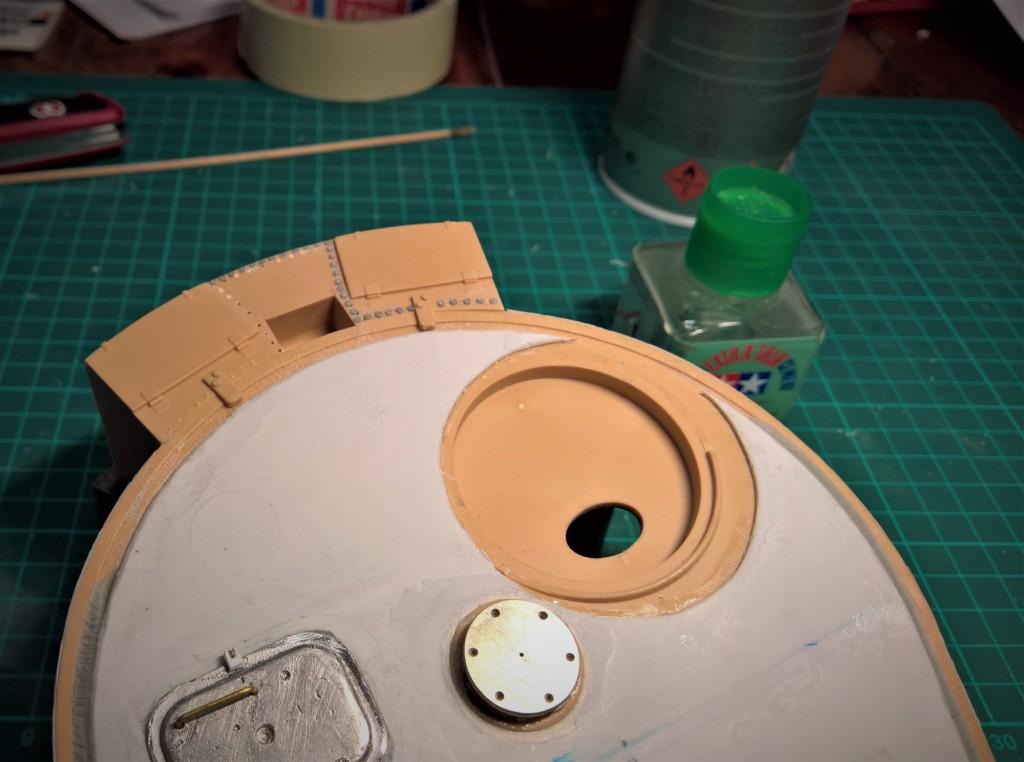

Started adding the optics. Unfortunately the brass mounts, when placed into the cover like shown in the ABER manual, the opticss wont fit in. So I had to pry them freee again and place the optics, then glue it in place again. some gaps have to be filled in then.

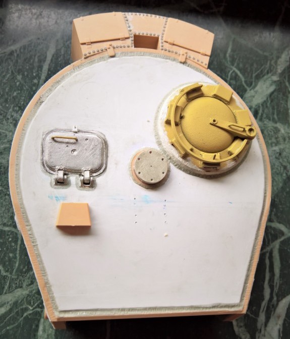

Sunday morning, time to add the cupola and making of the remaining weld beads. Maybe painting one layer would be needed now to see where the roof and transitions to other parts need some modification. Meanwhile working on the mantlet mount and recoil/elevation unit.

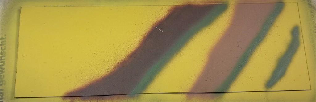

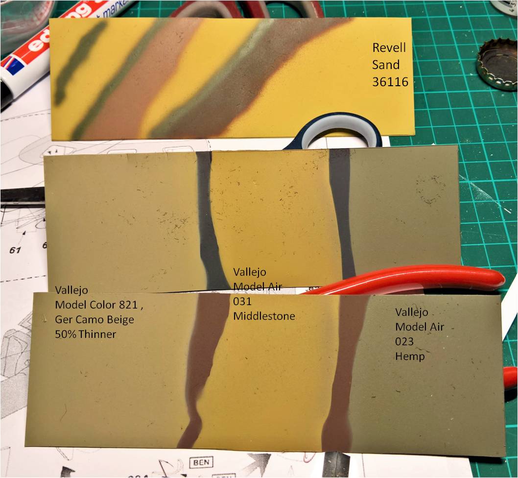

Yesterday, I tried the camo colors that Academy recommends when using Revell Acrylics. Right side you seethe the Revell 3 tone. The brown is too light. It is RAL 8025. I wonder who messed up here, Academy? Left ist the Vallejo RAL 8017, I will stay with that most likely. The Revell green is ok though. I bought the two Vallejo colors from the Academic recommendation, from the model.color and the model.air line. In the bottle they already look very different. Stay tuned for the test sheets tonight.
Soeren
Posts: 1356
Post by Soeren »
Still not finished with the color discussion, I bought the Vallejo paints according to the Academy guide. Left is the Model color for their Sandy yellow, center is what they recommend from the Model Air line and right is what I have taken from the Vallejo conversion chart for 821. I sprayed the paints on either gray or redbrown primed plasticard. Also see the way off Revell test. Also included is the picture from the SCHWEREPANZER thread referring to Dunkelgelb.

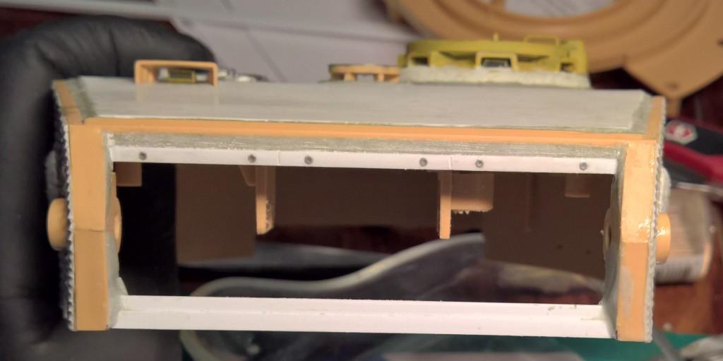

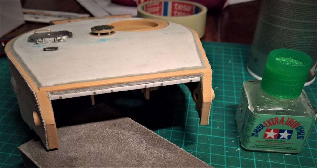

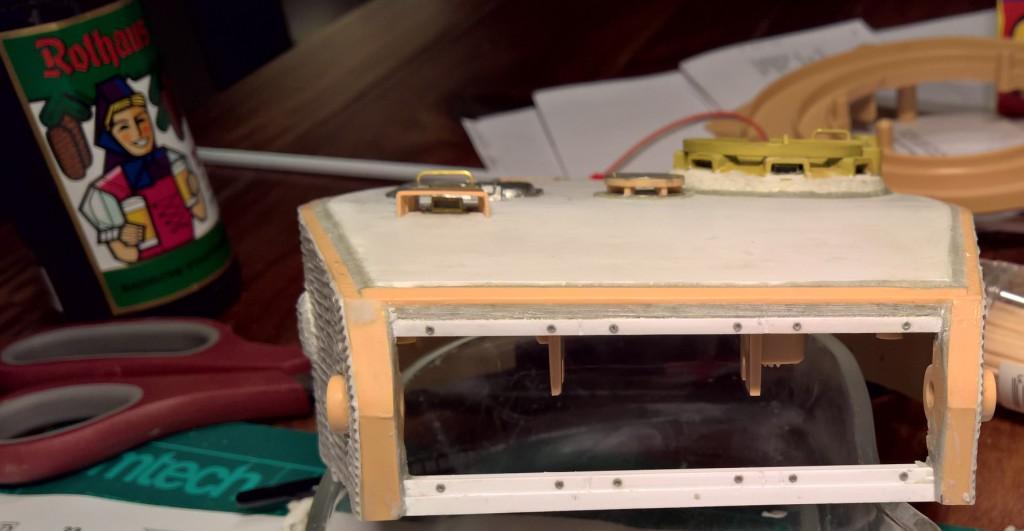

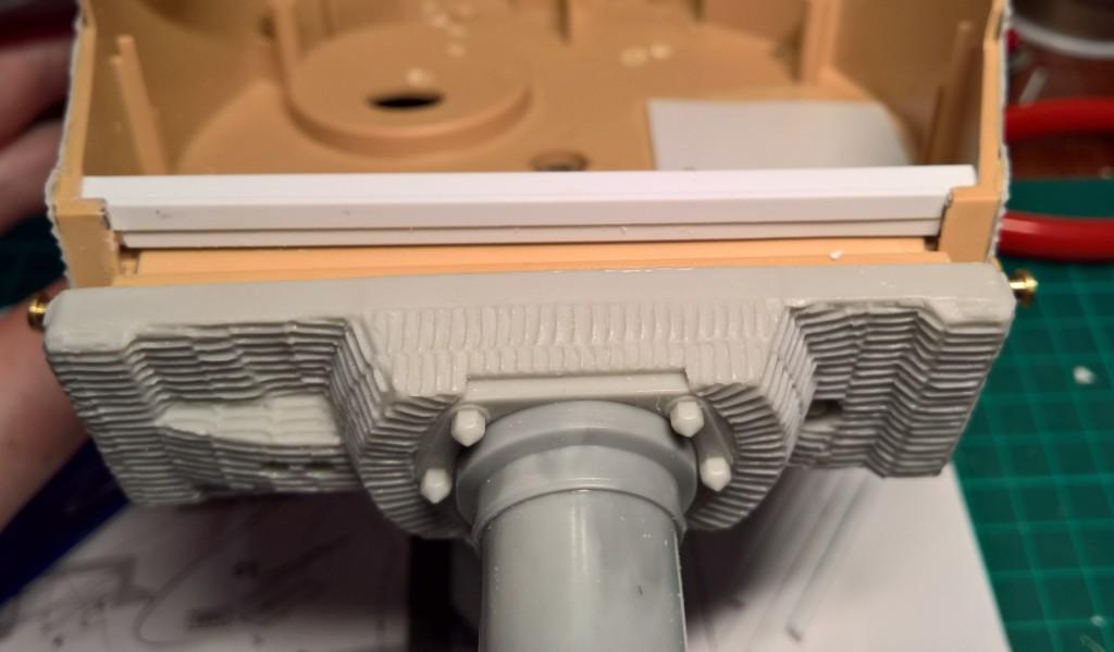

Todays job is done, doing hte lower lip. One evergreen 3.2x6.3 placed in horizontally and a 1.5x3.5 to make the lower lip and 1x2.5 to make the splash guard. Then the sides filled with Apoxie Sculpt. Some clean up to come as it is all well cured. The mantlet sits now rather tight and wiht nearly no gap when seen from the front. A single oddity though, while in full elevation the top raiming gap is close to completely even, the lower gap in full depression is wider to one side. But as it is on the bottom we will not see it once the turret is mounted.
Once sanded down a bit and bolts added, even the girls from Schwarzwald approve :D
Now I have just to work out how these guys go together
