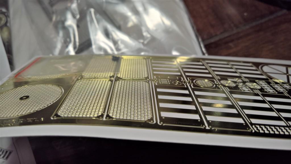

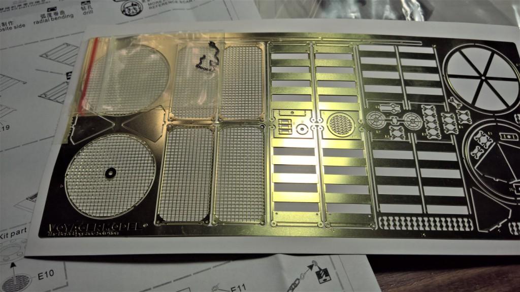

Hi there, a late Easter Egg arrived, I got the Voyager PE grills for the Panther. First note, it is more delicate than the thick and stiff Taigen stuff. But, considering the ABER pictures, it has less definition than the ABER parts, that look more like interweaved. The Voyager stuff is just flat. The thickness of the PE is also really thin. On the other hand, you pay 15€ for a set of grills, plus all the other detail bits, compared to the 30€ for the more detailed ABER set. So it is an option still.

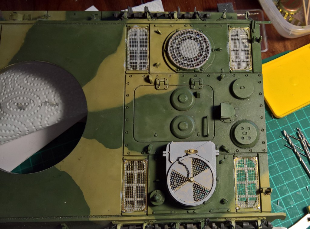

Herre you go, most of the Voyager grill set added. Pro it looks better than the molded on parts. Cons, the pieces are slightly oversized for the Taigen upper. The grill for the right side vent had to be trimmed and to be able the add the compartment heater all the molded on details had to be sanded down. The air intake grills are slightly larger as well but can be placed none the less.
The bolts for the chain were from the ABER Panther set and the grills are held in place by cast hex bolts. The Yoyager kit only includes bolt head look alikes.

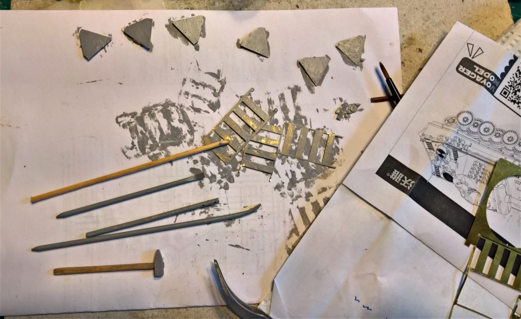

Another afternoon allowed working on the remaining tools.
The large prybar is form 2.5mm brass rod, the smaller is made from the Taigen long one shortened and reshaped. The tube tool from 2.5 mm Trumpeter brass tube. The hammer is a tin cas head and a shaped beechwood rod.
Everything primes with Mr surfacer to add some texture.
