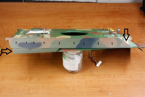

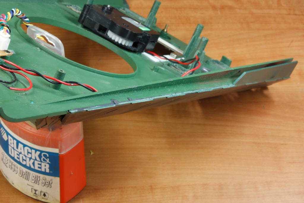

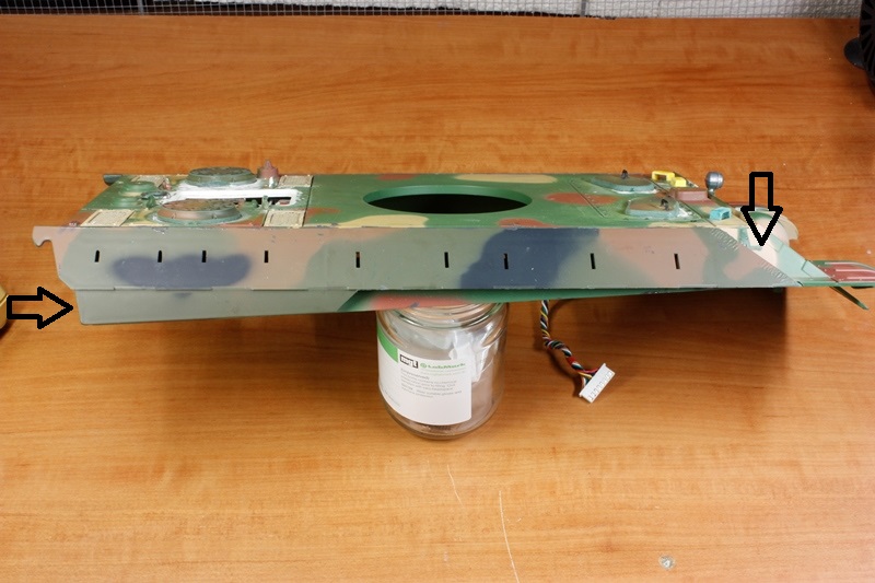

As Dean pointed out the sponsons on the Ausf A (and D) have a different slope and side profile. Dean rebuilt his sponsons with plasticard, but before following him, I was a little wary about the fragility of the separate piece that forms the vertical side of the rear of the sponson. He strengthened his with resin, but I preferred it to be moulded in one piece like the Pantiger. After a while I had an ‘ah-ha!’ moment and measured the Pantiger sponsons. Miraculously, they are exactly the right height to fill the slope between the top of the hull and the horizontal side rail, on the Panther G. And that vertical piece comes already attached.
So I cut the sides off the Pantiger upper hull, added a bevelled edge at the top and another on the Panther G side rail. They were glued on with JB Weld.

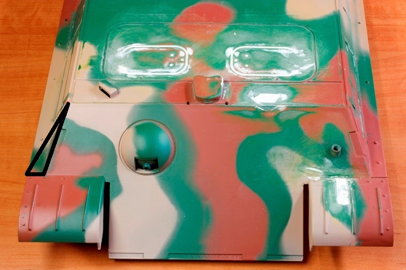

At the left arrow I was left with an incorrect dog-leg shape at the rear, and the vertical piece ran along the side almost all the way to the front, a legacy of it originally having to match the Tiger hull rear. That has been trimmed to line up with the third external road wheel. Also, it has come up too short at the front and will need some extension to match the front of the hull.

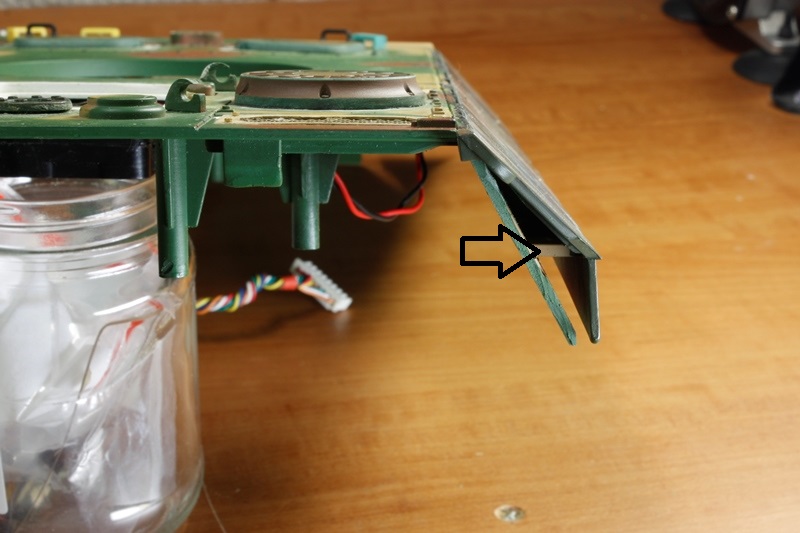

Again you can see the Panther G side rail lines up nicely all the way to the rear, creating a neat triangular cell in the sponson. Even the piece below the side rail will help provide support.
From underneath it looks fairly neat too. The Panther G has extra below the side rail which will have to be trimmed.

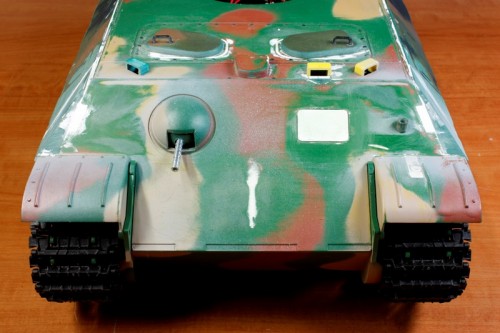

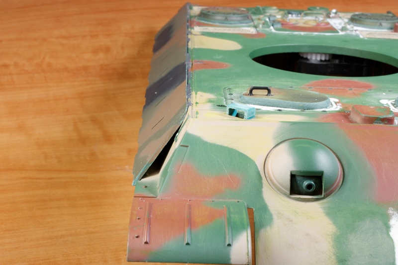

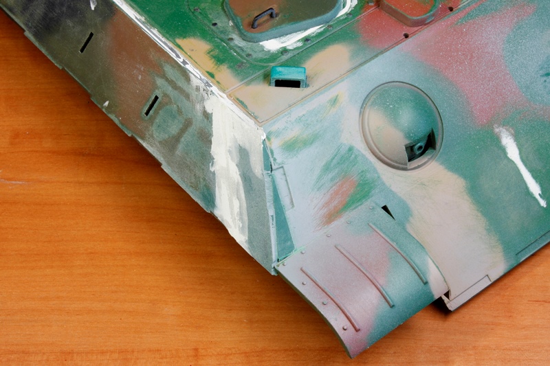

I’ve never had to do that, but what I gained has come in handy fixing the front of this plastic tank. Again using left over pieces of the Pantiger, I filled in the gaps at the front of the upper hull sides. Thanks Eddie.
I needed to add the drivers vision port, but didn’t see the need to make a fully opening one, as Dean did. I considered placing a thin styrene sheet across the rentire front to make it a neat finish, but figured it was probably less work to fix the existing front. I also added the obligatory metal MG.

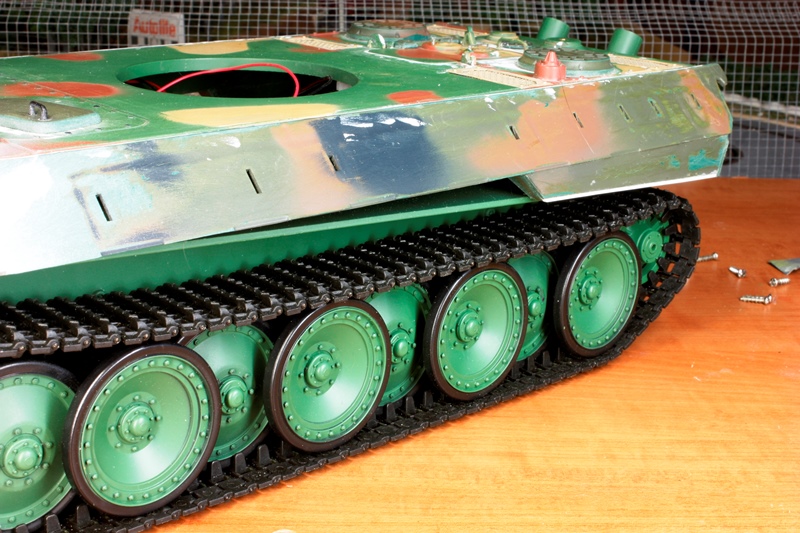

The Panther G hull top sides were trimmed to match the Ausf A side profile and the gaps between the old and new filled in. The hull lower will be fixed later.

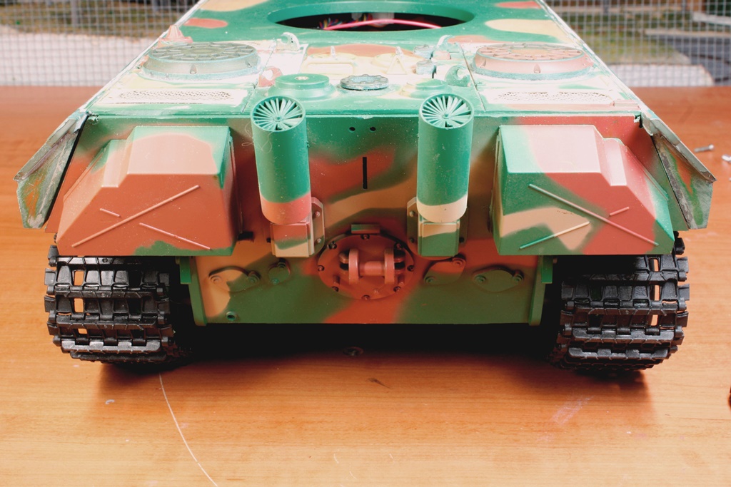

Here is how it looks now at the rear. Once the rear boxes are moved outwards, they will hide the join line between the upper and power hulls.
