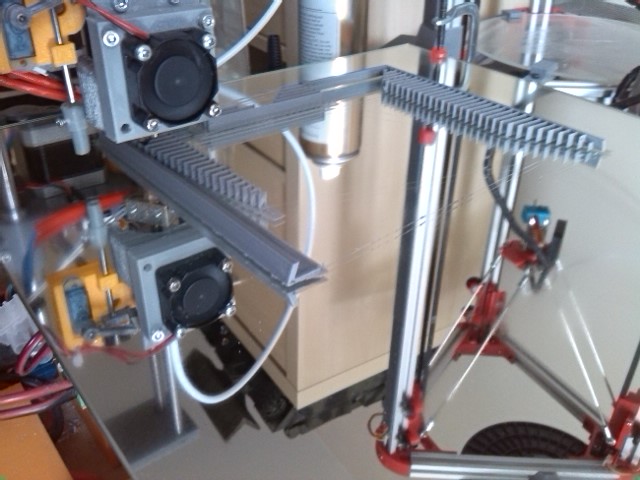

wibblywobbly wrote:I am printing all of the parts designed so far, while I wait for the suspension springs to arrive, as I need to check where the mounts are on the lower hull, to get the correct tension.
Yes, the parts are turning out well, though I am always aware that they could be even better if I applied myself to some minor details on the configuration side of things. :{ The printer is positively ancient by current standards, but as it does the job, I am not complaining.

I just got 3 hours into printing the crew surround, and was so busy looking on here I never noticed that the nozzle had blocked...aaaarghhh! It's a 6 hour print, so back to square one and start again!! It was printing the wafer thin support structure that did it, hope it doesn't happen again..might try installing my own supports and disabling the Cura option.
