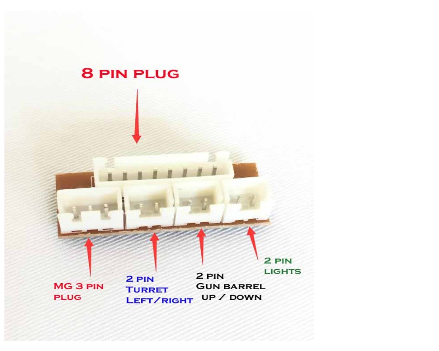

the three pin at the end should go to the machine-gun led. In my T90 the machine gun led wiring was soldered to the outer pins of the 3-pin connector, on the back of the little board. The middle pin is not used. I think it can be used for a second machine gun, or an ir flasher. Not sure.
The middle 2-pin connects to the turret rotation, the 2-pin one next to the 3-pin goes to the airsoft motor, and the outermost of the 2-pins connector takes the gun-elevation plug.
If all's correct, You're left with just the big' colourful flatcable and the gun trigger-switch cable going from the turret to the controller. The wire from the micro switch on the airsoft unit goes to socket CN3 MG fire, and needs to be plugged into the most right two pins of the5-pin CN3, otherwise no shootie bang bang..

Just to add a little extra detail to Wibb's link, this is the new 9 pin connector with named connection points. Hope it helps. Personally, I just map out the traces of the circuit boards, and their connectors, with appropriately coloured pencils and a sheet of paper. It helps to work out which wire is going where, and though which connection junction.

Odd.. On the KingTiger with the 4th gen controller, the middle 2-pin connects to the turret rotation.

The micro switch on the back of the gun is missing. I doubt You can get a main gun "boom" without that. Or, if the microswitch sits at the side of the gun. If so, the following goes:
The 2 wires from the microswitch go directly into the Ch3 "mg" port on the controller. They don't use the connection block thingy.
By the by, the triple socket's outer 2 pins are for a machinegun.
