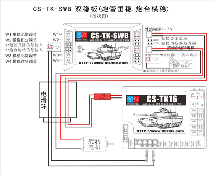

The engine deck kit from OKC is really for the Clark Tk-24/Tk-60G2 electronics which has both horizontal target locking and vertical stabilization. You cannot use it by itself just to to prevent the main gun from crashing into the engine deck. I have try to do this with two gyro but it was very difficult to adjust and too sensitive for our purpose (I have to use heli gyros). I have been trying to install the Tk24G2 for a fellow member on a Heng Long Leo, but there is a limitation of the sensors being 8 cm from the main electronics, which means that the only way you can do it is to put the electronics into the turret. This is fine for Tamiya Leo/Type 10 as it is designed with all the electronics in the turret, but is much more difficult to do in a Heng Long Leo.
What I use on Carl's Heng Long M1 is actually a Chinese brand MFU's own stabilizer unit, which is plug and play with any servo elevation and rotation. Here is a picture of the wiring for it in Chinese (I know enough written chinese to figure out what goes where. The CS-TK-SWB is the stabilizer unit that sits in the turret):
Basically it is plug and play into any tank with a servo elevation and servo rotation as long as a separate power feed goes into it. It actually also has a port for the Heng Long Rotation unit, but it is much slower. I used it in my Merkava, but it is best to stick with servo rotation.
For Carl's M1, it is basically all set-up. All you need to do it to convert the Heng Long elevation to servo elevation, and then couple of servo connections and you should also have vertical stabilization. I just need to tell you where to plug in the servo elevation unit and the MFU elevation feed.
I still have two more of these units as I find them sufficient enough for our purpose and the plug and play is simple to install.

Yes indeed, if you have the elevation kit, then it is just a matter of plugging the elevation servo into connection a (b is for rotation), and connect c to either the IBU2U elevation servo port, or the receiver channel that controls the elevation.
I have an IBU2U FO for the Merkava, but it does not have elevation anyway, so I can't really say whether it is worth it or not. I never like Clark's elevation control so I always switch it to a separate channel on the receiver and mapped it to the Clark's elevation channel instead. I think the other advantage of IBU2U FO is the extra sound function, so if you can use it then maybe its worthwhile. I can't really say whether the servo elevation is worth the upgrade by itself.
