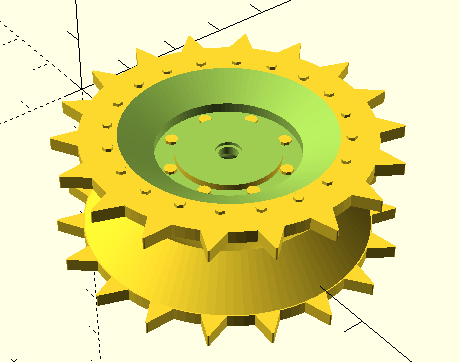

This is what I was aiming for originally. No idea what I was entering into the code, it just worked how I expected it to now.

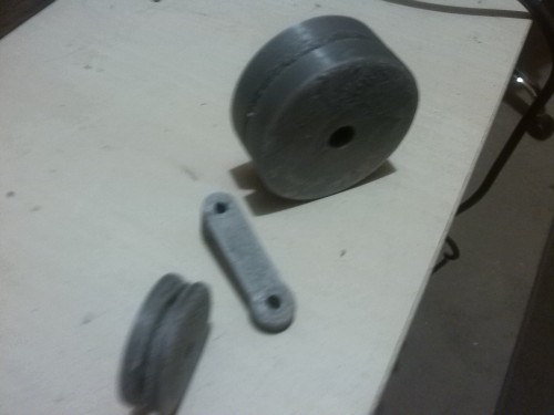

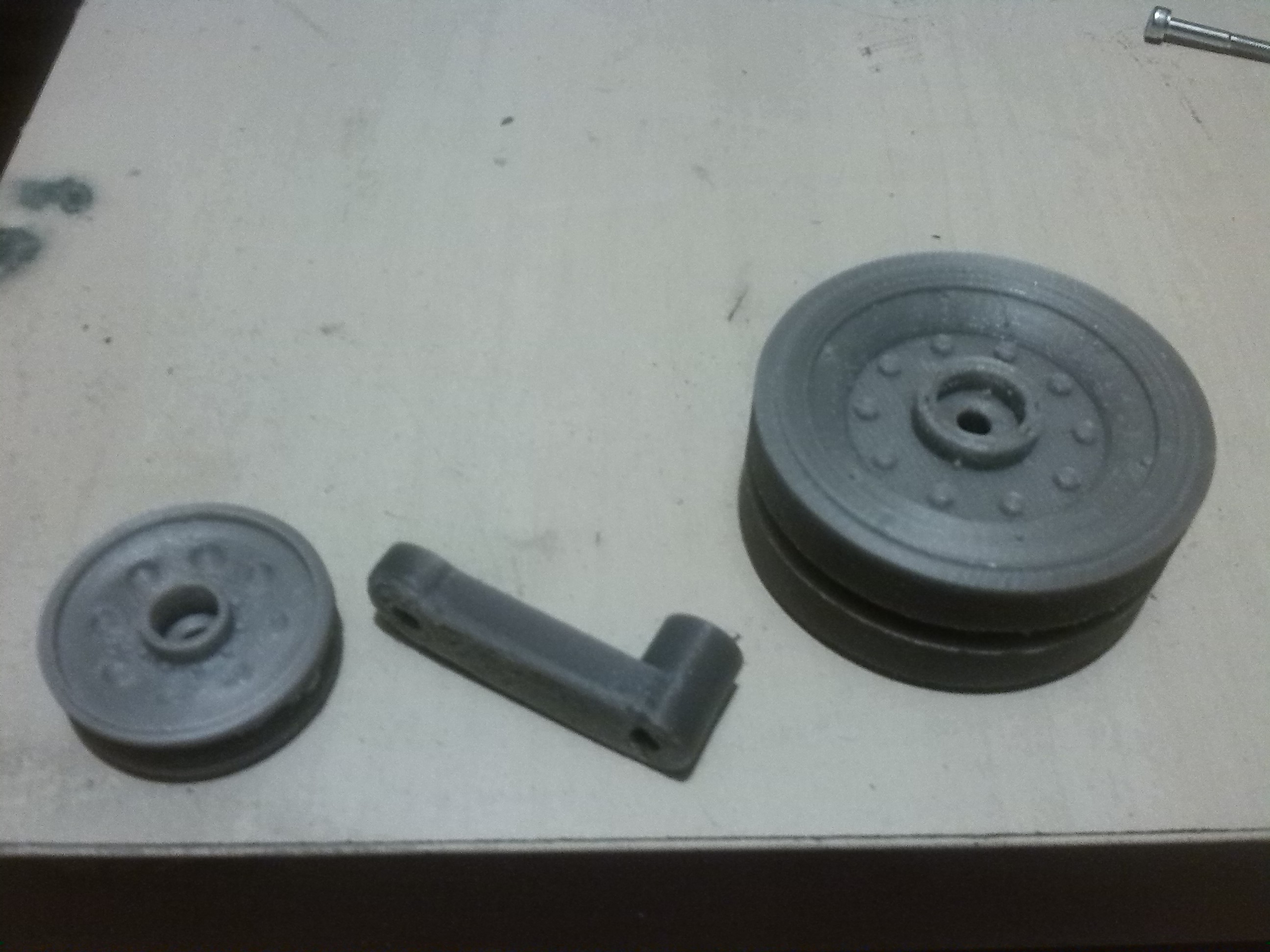

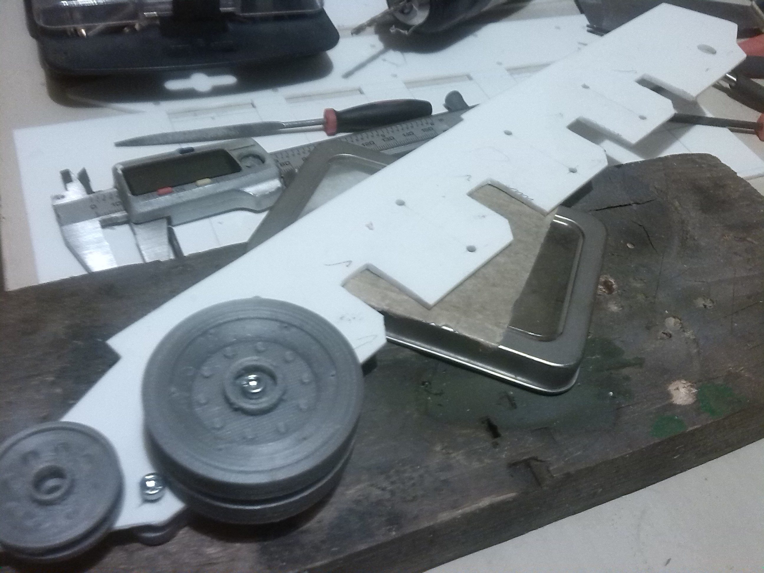

Filament arrived, so did a few test prints. Quality and detail are pretty good, so I am happy with that. Ordered a mountain of various allen bolts, nyloc nuts, bearings and springs to fit the various axles and suspension arms. The arms will be redesigned with coil spring mounts.
One roadwheel takes almost 7 hours to print, so that's 70 hours....
...but they are solid and will take a roller bearing.
Need a new heater element, so that's on the way too. Need to get hold of some P3 tracks somewhere, need one pair plus one side to get enough to do this one.

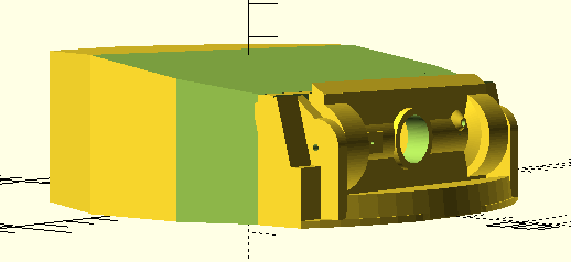

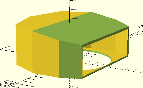

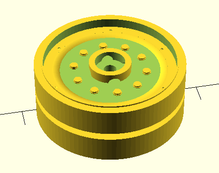

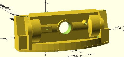

Before printing anything I decided to take another look at what I had. By redesigning the road wheels, and making them look more authentic I have got the predicted print time down from almost 7 hours to 1.5 hours, which is a bit better.
I also designed the mantlet, which was a bit of a challenge. There are a few different designs. It will have elevation, and I designed it so that I can smear milliput over it to give it the cast look.
A rough turret has been done, but I won't be printing the whole thing. I'll use this to make a supporting frame and attach styrene sheet to it. Otherwise the print time for the shell is almost 20 hours??
