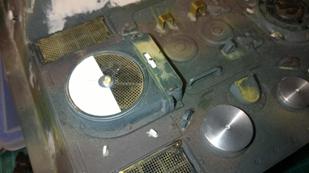

Thanks to all the great builds and resources on this side I added two tiny bits, that make the tank look much much better in the end. Pricepoint for both? Negligible

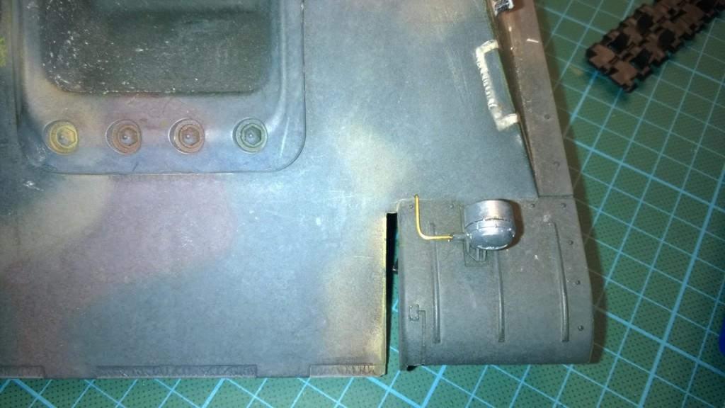

Now I have the spare track hangers in the making. Wasn´t able to bend them form 1mm brass. So I am doing them from 1mm styrene and sand them to shape, to look like bend bars of metal.

Well, I actually used brass bolt heads for the bolt heads. It will be styrene for the hangers. But retaining rods and chains will be brass age in. But I couldn't bend the 2.5x1.0 mm brass to even brackets, even after heating the brass. So I went with styrene bars and cut 6mm long pieces for the brackets, 3per hanger, glued those together and sanded the corners to give it the rounded shape of bend metal bars. The Taigen metal track links have a snug fit.

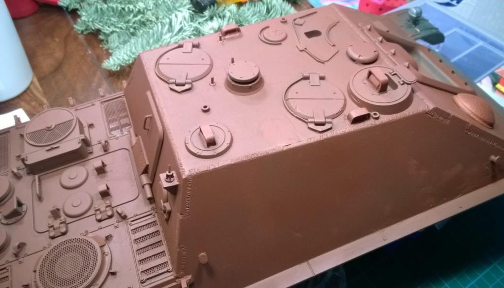

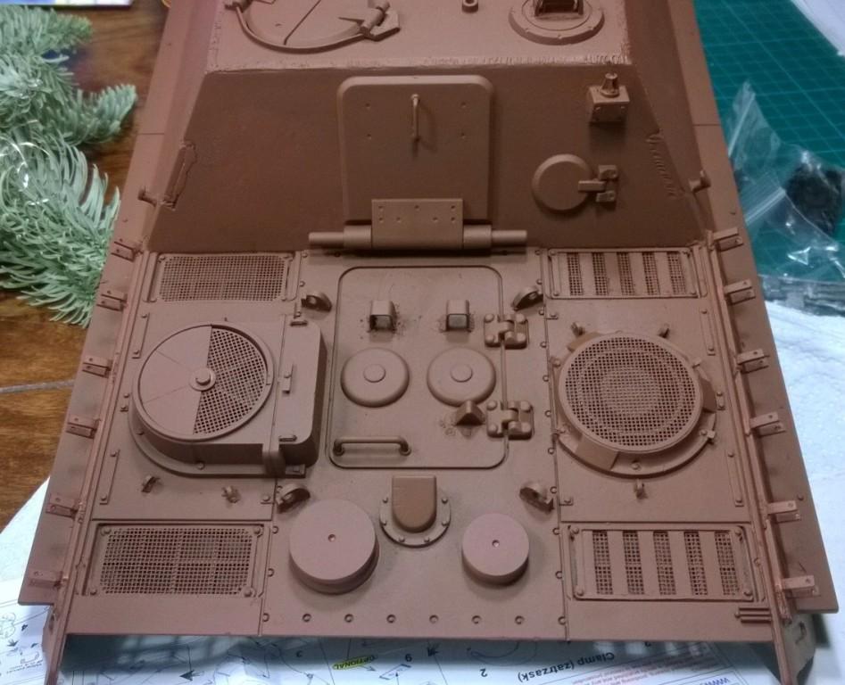

I couldnt wait any longer and gave it a thin coat of rust protection paint... The details blend in nicely...
Next will be all the retaining pins with chains. I think I will do the tools after the final painting before weathering.
But I see, at the Roof, I have to fill the previous vent position better.
