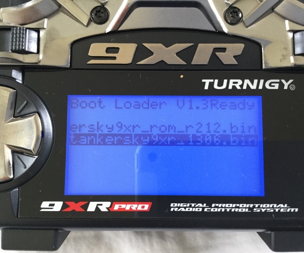

Hi Brianbrizo58 wrote:Hi All,
Well got the tank firmware on (ersky9xr_rom_r212.bin) is this correct it dose not have tank in front of the er?.I'd like to ask a few questions,1/ when I checked the firmware was there and the number was correct I pushed menu and on it went. Now when I loaded the firmware from the site I saw all the folders on the SD card. Should I be able to see them on the boot screen of the radio? 2/followed the instructions to add the firmware now I put the stick in the centre and still getting the warning. So any guide as to how to set it up would be most gratefully accepted. And believe me I do need some help here. Brian...
ersky9xr_rom_r12.bin is the standard firmware the radio comes with (just checked mine).
Your looking for the firmware tankersky9xr_1306.bin (the rc tanks Australia link I sent you)

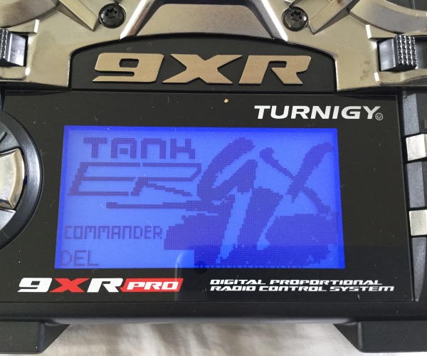

You will know when it's loaded because the screen will have a tank picture and the word commander next to it.see the attached pics
I still get the throttle high warning when I switch on but I haven't had time to play with it yet.

I think what I've done is I have downloaded it but didn't put it in the firmware folder
(Absolutely stupid.) I had to do it in an Internet cafe no one in the family has a windows computer. So I'll have to go back up there and check it's there and move it to the right folder!!!. I knew something wasn't right. I can't check on the radio if it's there!!!. Thanks Del for putting me straight. As I said I'm very close to throwing the dam radio up the end of the garden. Brian...
