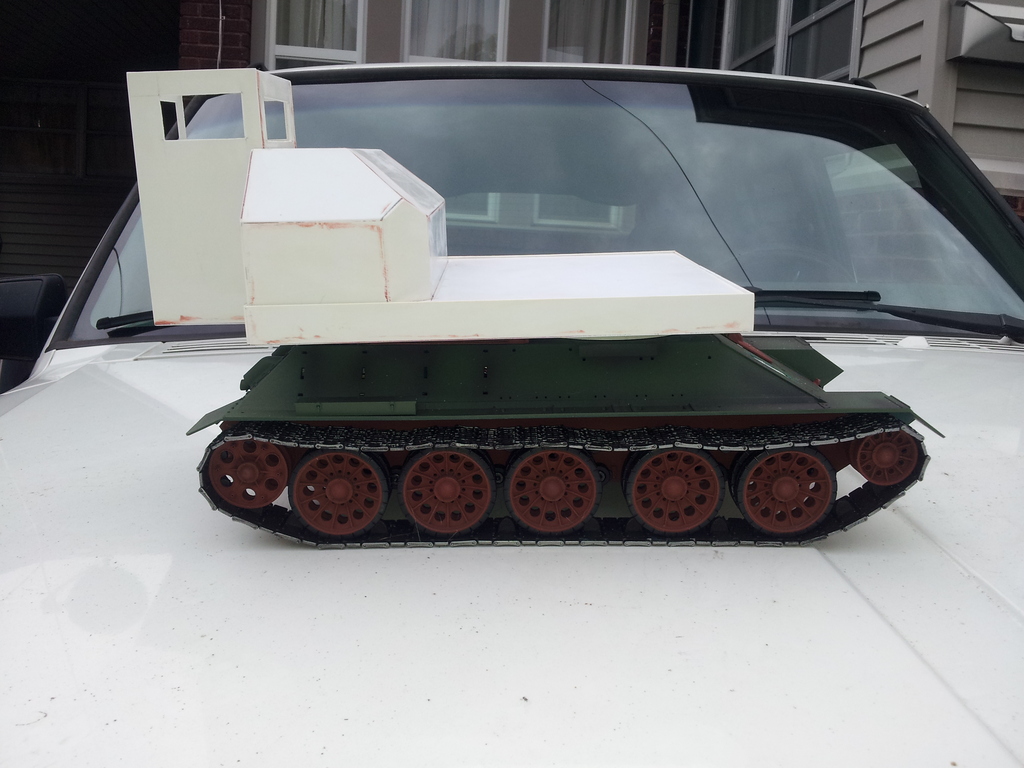

by capt midnight
Thanks for the link, Herman. That just might work. I'll pick one up and give it a try.
Here's where I'm at, so far...
Shimmed up the suspension arms. Looks pretty close, I think.
Here's the upper platform and control cab...
Still looking for some ducted fans that will work. I'm thinking about just getting a couple of 40mm fan units, then hunting up the motors to fit. Most of the units I'm finding have brushless motors. GWS made some 40mm units with regular motors, but I can't find anyone that still has any in stock.
I'm sorting through the hull fittings to see what I want to put on. The rest of the holes will be filled and textured with putty. Also found a couple of good pictures of the control panel. Also made use of some leftover tread plate to put on the deck and control cab.
Bill
Re: T34/85 Conversion
Posted: Tue Aug 02, 2016 7:56 am
by RobW
Could you use brushless units, and run an ESC from the battery with a relay triggered from the machine gun? So using the mg triggers the relay turning on the fans.
Posted: Tue Aug 02, 2016 3:17 pm
by capt midnight
That's pretty close to what I was planning on. This one has the 2.4 radio, but the smoker control is on the tank, not the transmitter. Was thinking about swapping parts with another tank and use the on/off for the smoke to power up the jet engines, then use the MG button to control the water pump. I plan to put in a separate battery pack to run the pump and jet engines, with relays powered off of the RX18.
Bill
Posted: Tue Aug 02, 2016 3:34 pm
by RobW
Forgot about the smoker - if you use relays then brushless ESC & motor should be fine? Someone who understands elektrickery may be able to explain otherwise?
