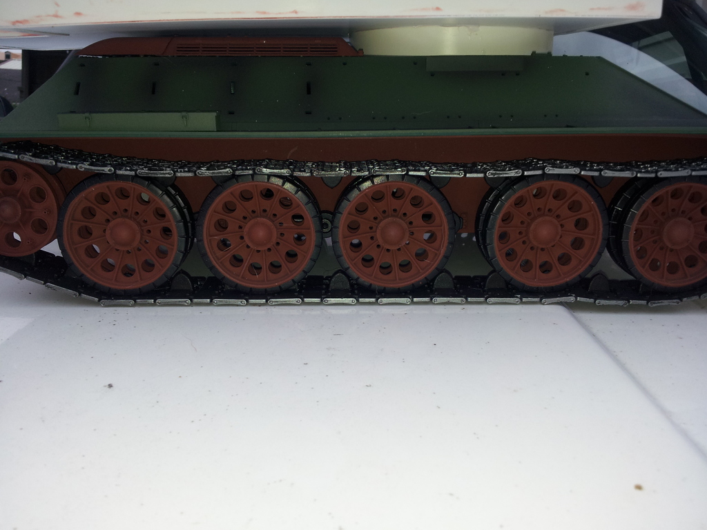

Thanks for the great idea, Michael. I'm gonna give it a try. I can shim them now, and adjust if needed after I get all the rest of the junk on top.MichaelC wrote:Bill,capt midnight wrote:Thanks for the input, guys. I hadn't realized that it was setting that high. After looking back at my reference pictures, I see what you mean. After seeing the two holes in the spring mounting area, it makes me think that I may be able to drill another one to adjust the ride height. I was kind of thinking that I might have to do some tweaking after I get the upper built and mounted.
A quick way to adjust the ride height is to actually put a small piece of styrene into the suspension arm stop so that it will stop higher than factory height. This will reduce the travel of the road wheels but will give you the proper ride height with very little work. The whole point of the Christie suspension originally was that the upper of the road wheels act as the return roller so the tracks should really be touch the top and the bottom of the road wheels.
MichaelC.

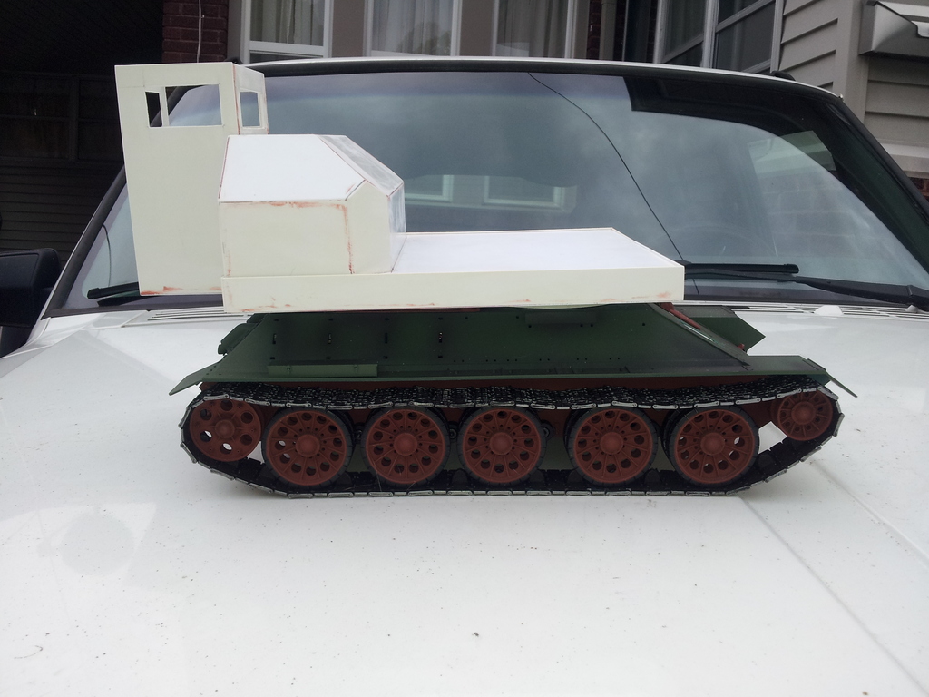

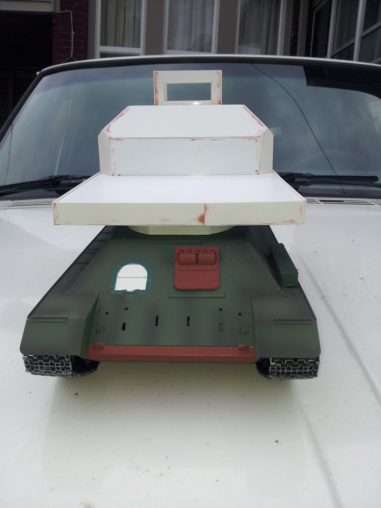

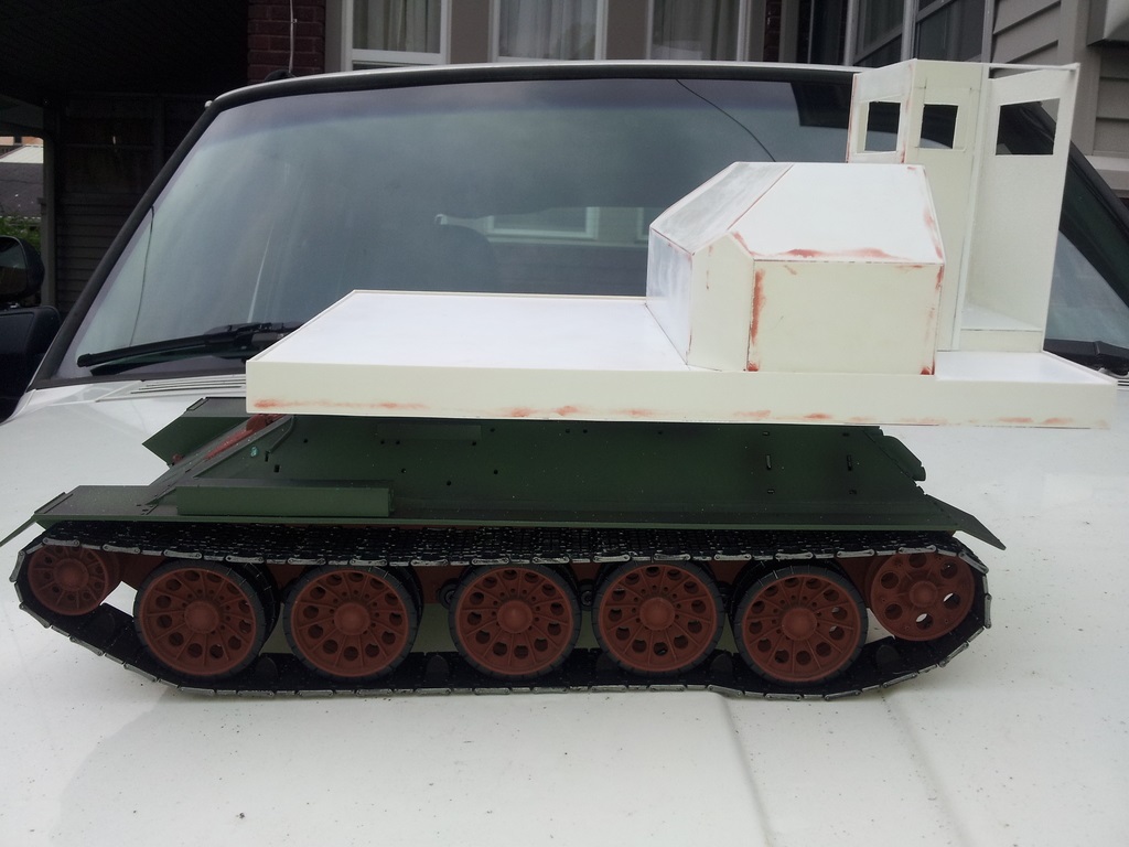

Here's where I'm at, so far...
Shimmed up the suspension arms. Looks pretty close, I think.
Here's the upper platform and control cab...
Still looking for some ducted fans that will work. I'm thinking about just getting a couple of 40mm fan units, then hunting up the motors to fit. Most of the units I'm finding have brushless motors. GWS made some 40mm units with regular motors, but I can't find anyone that still has any in stock.
I'm sorting through the hull fittings to see what I want to put on. The rest of the holes will be filled and textured with putty. Also found a couple of good pictures of the control panel. Also made use of some leftover tread plate to put on the deck and control cab.
