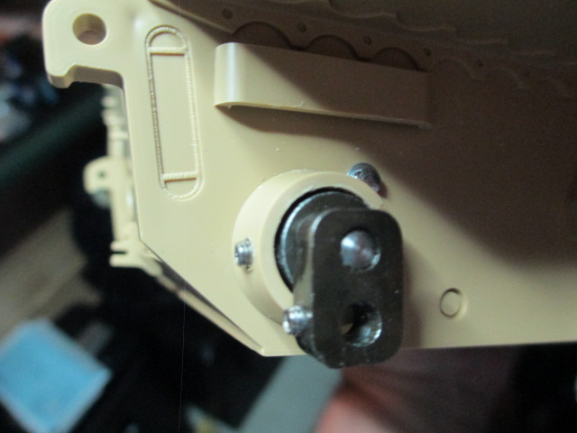

Step 7 this evening required some measurement and drilling. I installed the aftermarket idler adjuster from Henntec. I was surprised when it was not a drop in replacement. I'm used to drilling holes for small screws and mounts ( I have one of these on my Porsche King Tiger ) for fitment. However, this part required a complete drill out of the metal inner hub where the idler adjuster inserts. I can only assume that the diameter of the idler hubs are smaller on the static model vs the RC version. The adjuster is installed and will give a great measure of track stability to _Mike's_ Tiger *chuckles* I think I have mentioned already that I'm building this for Sassgrunt. I'm just happy to be allowed to do the build. The fact that it is fun is just icing on the cake. Pics:
A very solid piece once installed.
A very solid piece once installed..JPG (80.76 KiB) Viewed 3794 times
Installed!
Installed!
Careful measurement is required to drill the attachment points and access for the grub screws
Careful measurement is required to drill the attachment points and access for the grub screws.JPG (85.24 KiB) Viewed 3794 times
Once this is done, there is no going back to using the stock Tamiya part without a new inner hull.
Once this is done, there is no going back to using the stock Tamiya part without a new inner hull..JPG (82.72 KiB) Viewed 3794 times
Make certain that you want to use the aftermarket  adjuster if it requires drilling.
Make certain that you want to use the aftermarket adjuster if it requires drilling..JPG (70.84 KiB) Viewed 3794 times
Step 7 is somewhat more involved when using the aftermarket adjuster.

I'm sorry that you had to go through the effort to drill out the hull so that the Henntec parts would fit. Great job, though! I'm glad that they replaced the original idler arms with their own robust arms. From talking to people who frequent Danville, that is one of the few weak points on the Tiger I, (especially if you ever upgrade to metal tracks). At least now the idlers will be as bulletproof as the gearboxes.

The idler fitment on the full option Tamiya tiger is the same painless,you have to open out the inner hull just like you have on this one.

Mike, No apologies needed. Building this kit is something I look forward to every evening now. Del, it is curious that the Henntec adjuster requires the Tamiya lower to be modified when used. I wonder if this piece was designed with an Asiatam or Torro\Taigen lower hull in mind. Well, Mike will be able to run the metal tracks whenever he chooses. The fitment of this piece makes it bulletproof.

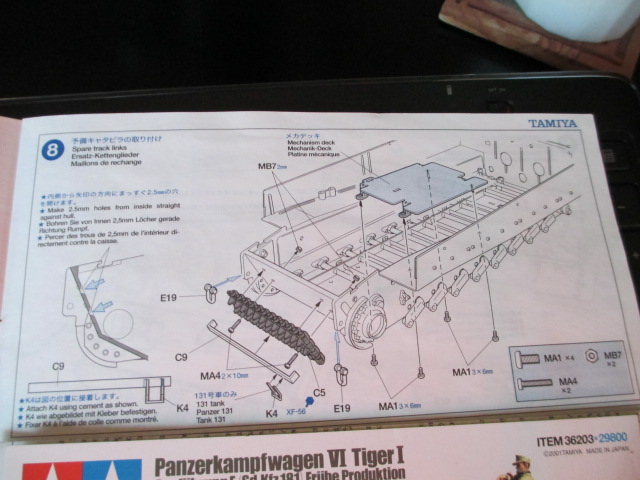

Step 8 tonight involved replacing Tamiya's molded spare track segment with a run of nylon track. Flexible and it will hang correctly in the bracket. I have a trip up to Pueblo tomorrow night then some casting work to do for the Stuart on Sunday. I will get back to this build by Monday at the latest. Pics:
Bracket for the spare track mounted with a run of flexible nylon track set aside for it.  This won't be mounted until the lower hull is painted.
A little help from Waylon!
A little help from Waylon!.JPG (94.61 KiB) Viewed 3777 times
MFU mounting brace
MFU mounting brace
MFU mounting brace.JPG (79.98 KiB) Viewed 3777 times
Step 8 is a lot simpler than the preceeding step but still involved using the Yankee drill to start and make a couple of  holes in the lower hull.

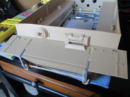

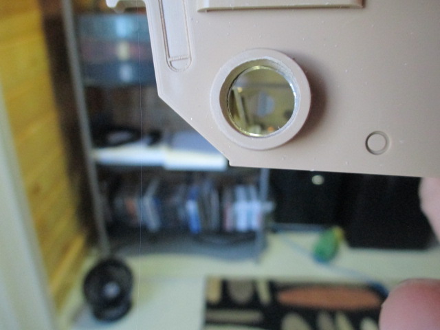

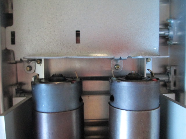

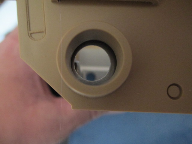

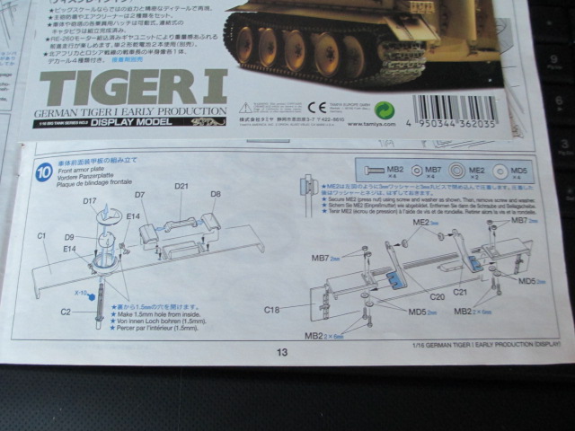

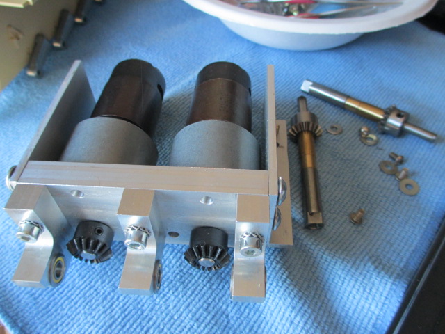

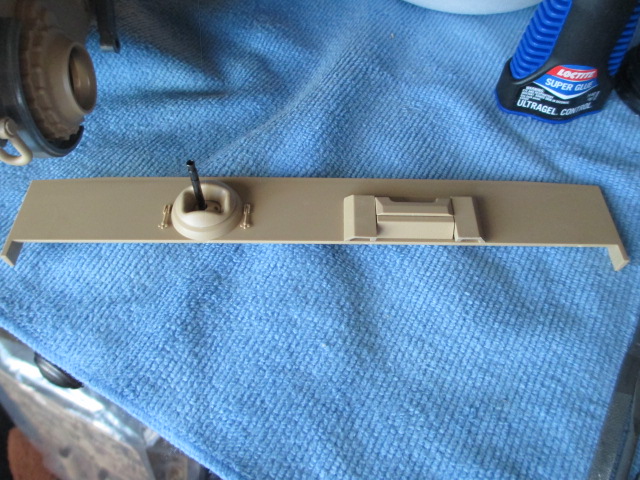

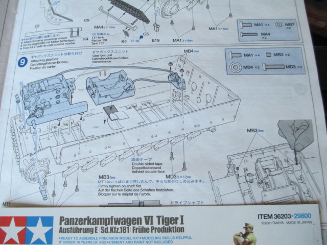

Steps 9 and 10 this afternoon. To leave room for the MFU platform, some adjustment on it's leading edge was called for and done. The rest was simple and Tamiya's own brand of efficient. The plastic bow MG was swapped out for the metal one which will be lit by fiberoptic. Pics:
Checked for fitment
Checked for fitment
Armor plate
Armor plate
Step 10 is the front armor and aside from swapping out the bow MG is exactly as per instructions
The shafts will not be installed until the lower hull painting is done.
The edge now provides room plus a protected attachment area for the motors.
The edge now provides room plus a protected attachment area for the motors..JPG (93.7 KiB) Viewed 3750 times
Step 9 required that the leading edge of the MFU platform be bent up to allow room for the longer motors.

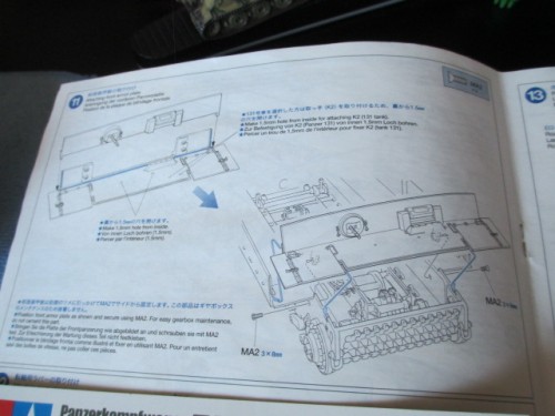

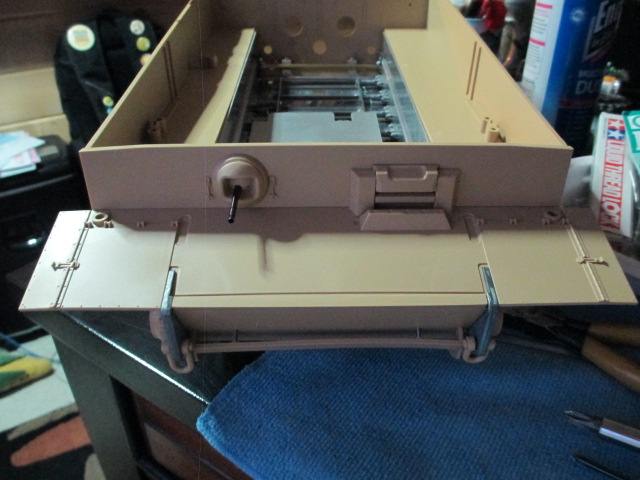

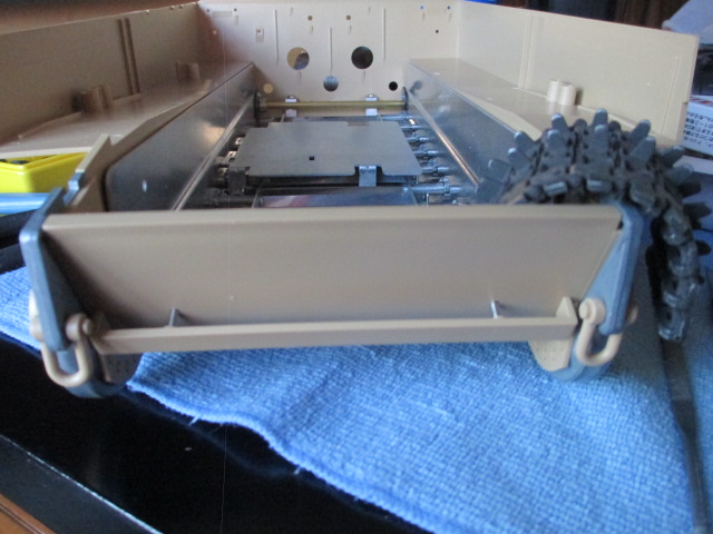

Step 11 was just drilling a couple of holes and mounting the armor plate. I didn't use any glue on the one area it is called for because I am coming back after the lower hull is painted to mount the spare tracks with those screws. Steps 12, 13 and 14 all involve wheel, sprocket and idler assembly and mounting them on the lower. So it is time to prime and paint. I am going out of town tomorrow night and will be back Sunday evening. I'll pick up this build on Monday ;o) Pics:
Holes for the shovel mount drilled and everything lined up and screwed together correctly.
Step 11...Good thing I checked fitment because I had two overlapping plates on the front armor mounts backwards.   It always pays to read the destructions, folks.
