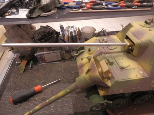

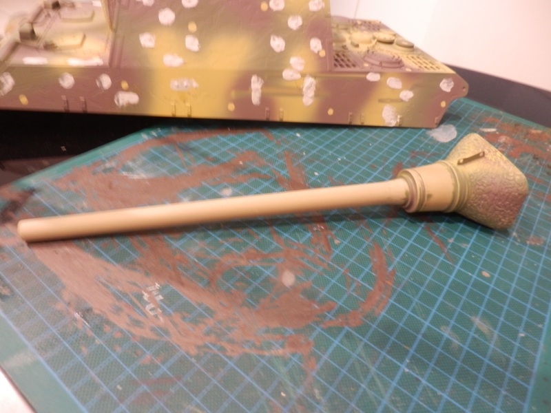

Part of the dismantling was quite informative. The barrel on these is a resin casting over an aluminium tube for the airsoft pelets.
I have a rough plan to use a similar method of creating a recoil system using a cut off Pz III barrel as an anchor device to secure the Matorro barrel onto a recoil mechanism.
The resin material is rock solid into the mantlet, so the jury is out on this for now.
While I wait to see if Mr Jackalope's lower will be coming, all I can do is cut & sand.

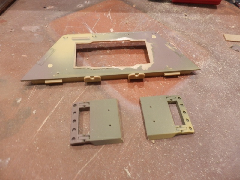

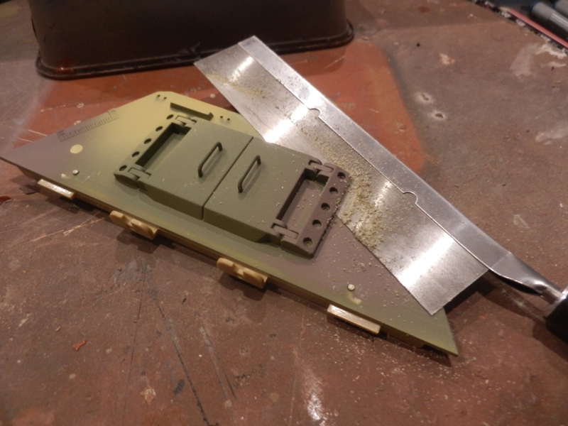

So, I sanded the barrel outer, and cut the rear casemete door moulds off the rear plate.
The doors I reckon I can save to make hinge and close. It was a bit of an act guiding the razor saw through the entire lot without taking to much off, or deflecting the cut into the rear plate, so pretty happy with the result.

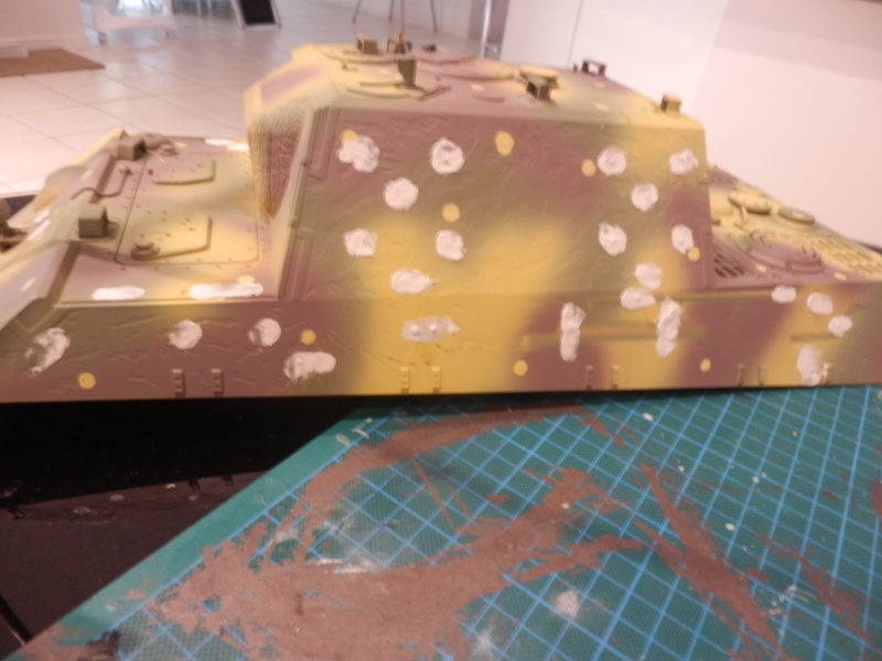

Also filled all the accessory peg holes on the main hull. I will be lengthening the lot so all these will need to be repositioned.
Being a late version, it will have three rows of spare track on the sides, this should also help to cover up where the join will be.
