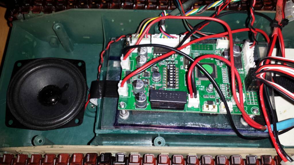

Hi Ian, the sd card was out in the beginning so I put that in properly, the speaker is a vistron I think but I can not see a volume control plug for it, the speaker has made a sound like crackling after the gun recoil for a few seconds so there's diffinatly sound coming from it,

From what i can see from the pictures there's no speaker or volume pot connected ....

Hi, this is the speaker Image if you follow the cable you can see where it is plugged into, there is no cable or plug for the volume though,

Should be a volume pot plugged in next to the speaker socket.

Model Builder 4 wrote:Hi, this is the speaker Image if you follow the cable you can see where it is plugged into, there is no cable or plug for the volume though,
Cheers, Lee

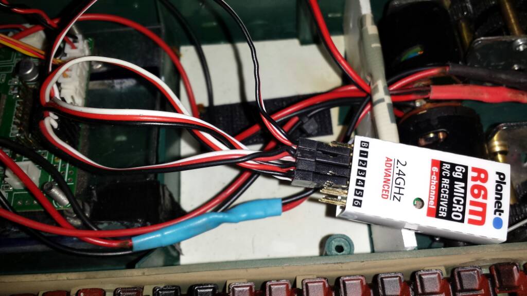

Could you pop up a pic of the rx as it is now pls,just wanna check something.

Just took the volume lead from another tank, all the turret and gun sounds are now working fine, still can't get the bloody thing to start though, I'll have to tow it around :haha:

Does that tx have 5 channels? If it has have you tried the switch for that

Hope this pic is ok Del,
