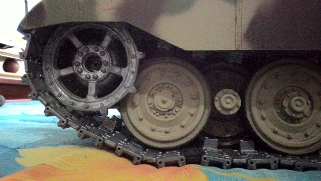

Jussek
Posts: 641
Joined: Wed Sep 07, 2011 7:59 am
Re: Broken King Tiger metal tracks
Post by Jussek »
this pic would show the 'hand rule' talking about the correct tension of the tracks
best regards
Jussek

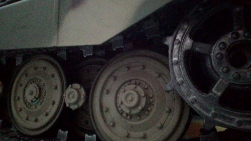

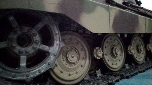

Please check these?
and this?
and this?
and this side
and this side
what do you think?
what do you think?
