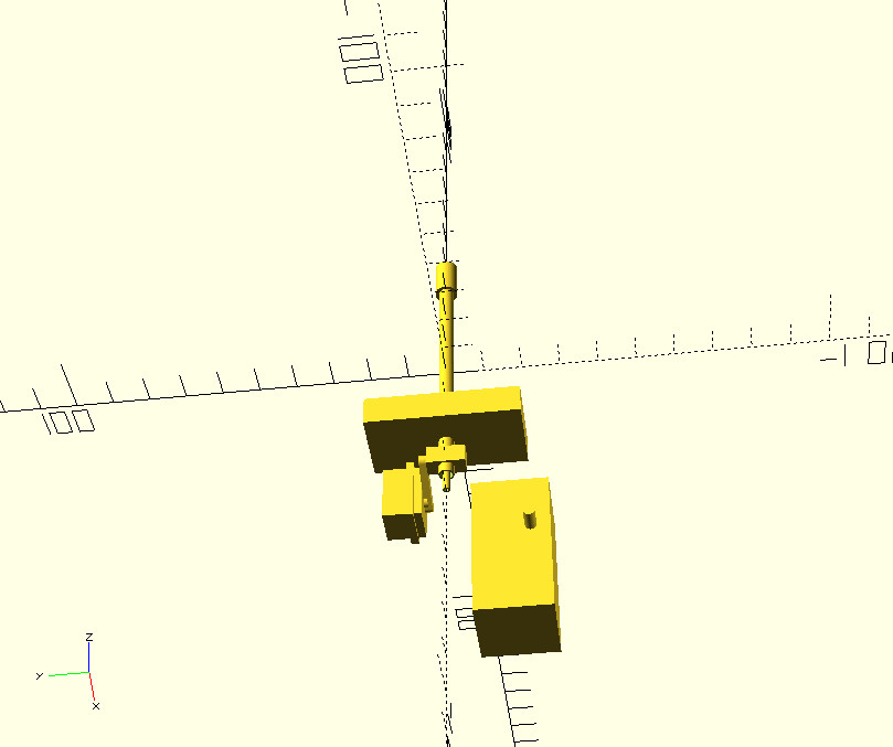

This might work. I hope it makes sense.
One outer barrel attached to recoil servo.
One inner barrel locked to inner turret elevation mech inside of it.
Inner barrel linked to smoke unit.
Fire the gun and the outer slides back over the inner.
The inner barrel is full of smoke.
How to release the smoke?
In the tip of the inner barrel is a diaphragm valve.
In the tip of the outer barrel is a Z shaped pin.
When the outer barrel moves back, the Z shaped pin pushes on the diaphragm valve and releases the smoke which is under pressure as it has been pumped in there from the smoke unit.
A flash led can still be fitted by running the wires up the inner barrel, through the diaphragm.
Clear as mud? Now who is going to build it? :shh:
