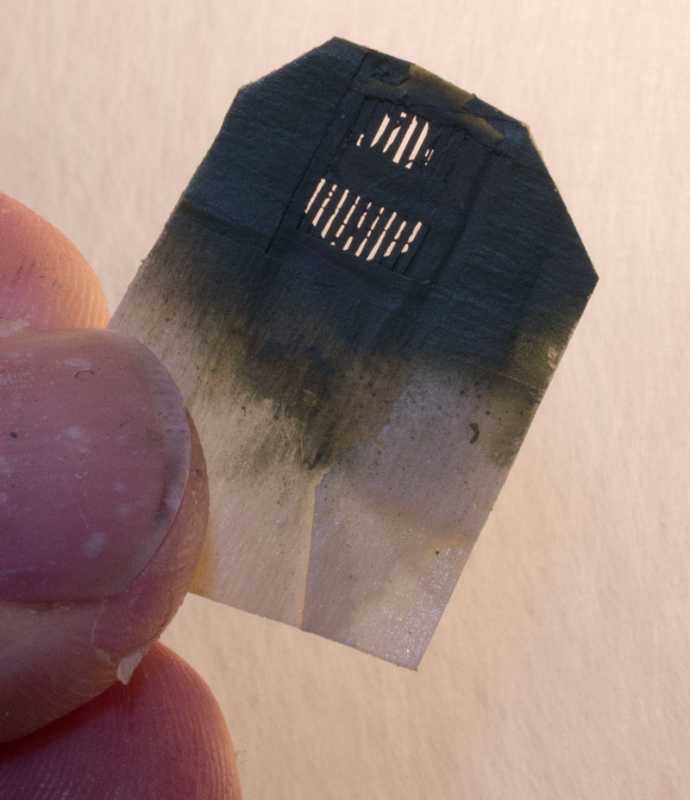

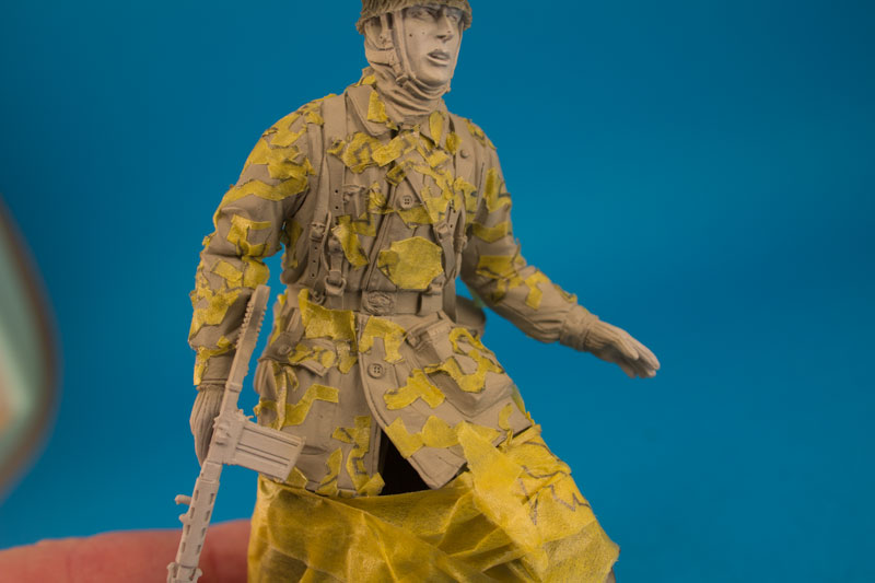

Here's the base coating of a splinter camo all done with an airbrush. I would never be able to get that flat with a hand brush. After covering it, I'll go in and do the details with a brush. The three splotch colors were masked and the splinters were sprayed through a small PE screen.

How did you do the masking? Very inpressive. Figure work is some where is like to start using my airbrush more but have struggled to get to grips with.
I masked the colors with tape, then sprayed the rain marks through an old T-34 PE screen, taped off:

Some sound comments above - and ausf your airbrush work on that figure is a wonder to behold. Having said that I guess you will be brush painting the face?
