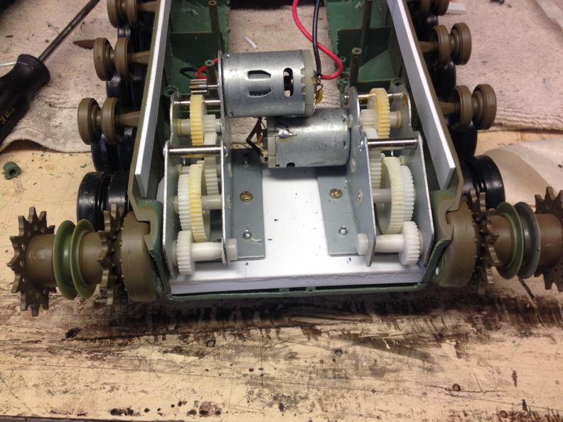

That went smoother than I had anticipated. I made up a motor plate and added structural reinforcement to it. I mocked the motor plate in the hull then screwed down the motors and checked again for clearance. All good. I made that last little plate in the rear lower hull to mount lights and towing hook. Thanks again for the help Michael C. Really, all the real dirty work is done at this point. I will let it set up for an hour or so before messing around with it some more.

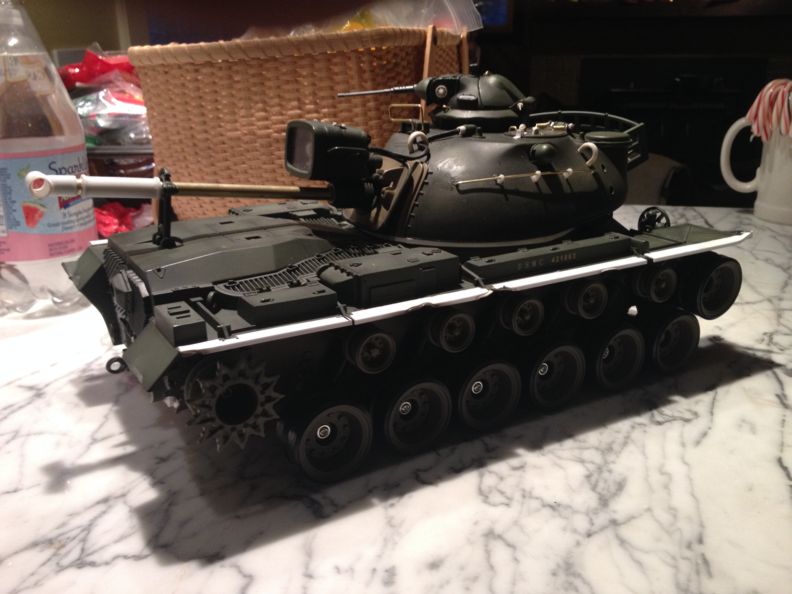

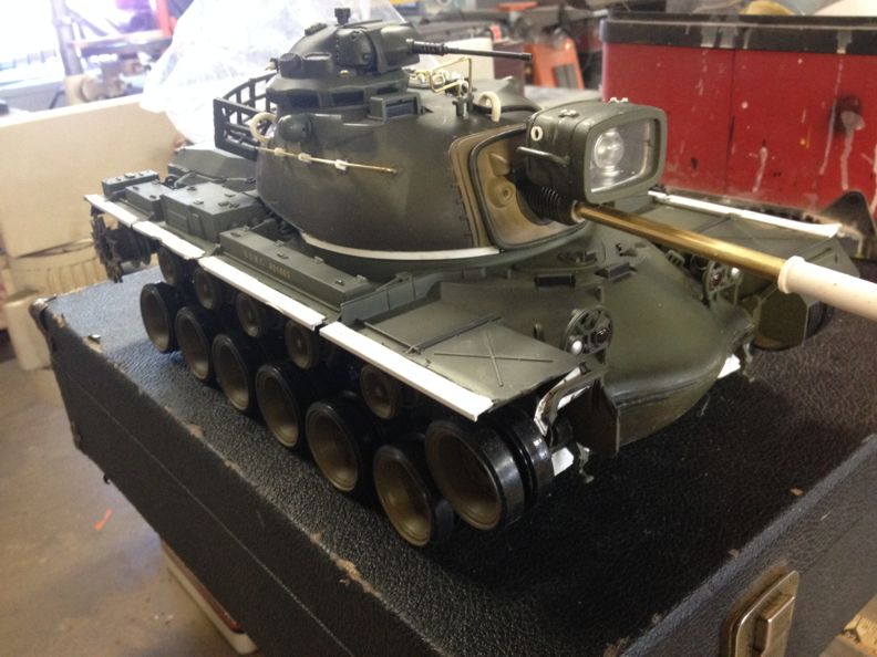

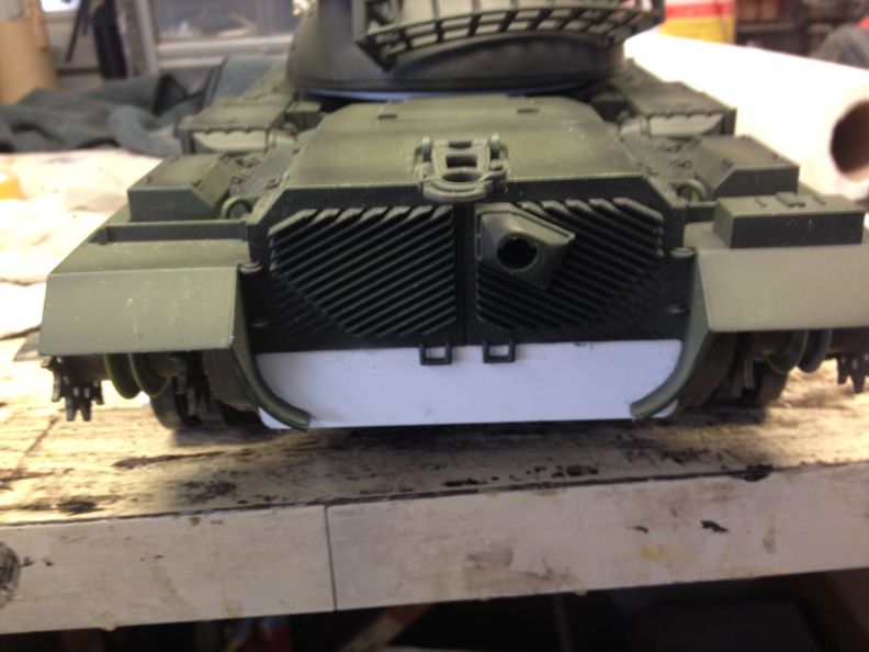

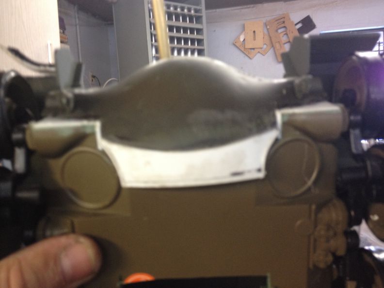

Home for the New Year day, with out a hangover. :) Happy New Year everyone. I got a few hours in today, taking care of the loose ends on the M48. Mostly, the rear and front end of the lower hull. Tying these two separate entities so it looks relatively seamless and still retains that authentic M48 look.
The rear was relatively simple. I could not duplicate the real tank in regards to the angle of the last portion of rear lower hull. Just not enough room with the motors in place. But still pulls it off with some sense of accomplishment. The front was a bit trickier. I designed the front end so that the upper hull basically hooks around the lower and is centered nicely.
I also added a section of split box channel to create the details at the edge of the track "fenders" on upper hull. I will be drilling and adding bolt details on this section soon. I also took a bit of liberty to add some damage here and there.
