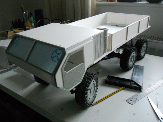

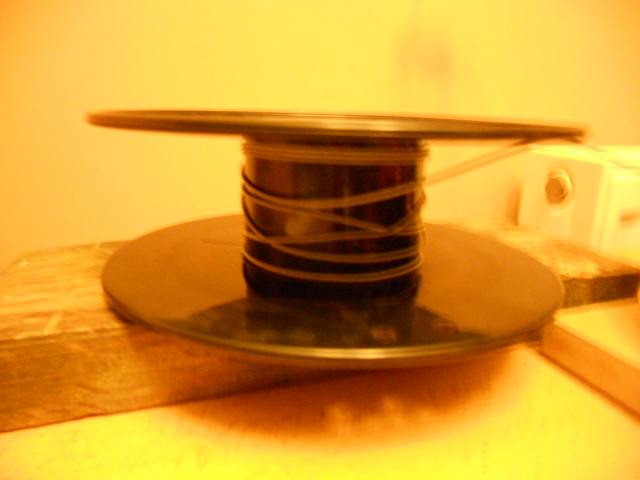

Its taking shape, done a bit more now, will post some pics when I get the chance. Waiting for a new reel of filament before I print anything else, just a few bits to go behind the cab. I also want to do a static hoist to go on the back. Then its fuel tanks, lights and mudguards, and some stowage.
The nice thing about these trucks is that all of the parts and hop ups are available. To change it into an eight wheeler all I buy is two chassis extension rails, a servo, and a steering axle. with wheels.
I'll also look at upgrading the motor to a rock crawler one, and installing a decent esc.

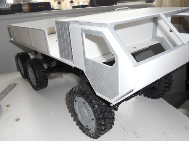

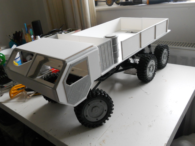

Waiting for the new reel of filament before I can do much else, but this is where I am. The cab is all rock solid, I started designing a dashboard and interior, but soon realised that the centre of gravity would be too high to go adding too much stuff up there. If its used for rock crawling then rollovers go with the territory, so a low c of g is the thing to go for. I'll dust the windows with an airbrush, so no one can see inside.

Coooolll, can't wait to see it in action. If top weight is an issue you could always use balsa for the load bed as I did on my trucks (mind you for a rock crawler it probably wouldn't stand up to the wear and tear)? Alwyn

It wouldn't do a lot of good, there is already a large sheet of alloy running front to back that I have used to take the flex out of the chassis. The other minor issue I have is that the steering servo is chassis mounted, so the front axle moves when steering, which means I lose the full steering lock. I need to either remount the servo on the axle, or stiffen up the front end using a panhard rod, or an Axial A frame. Just another problem to apply myself to....

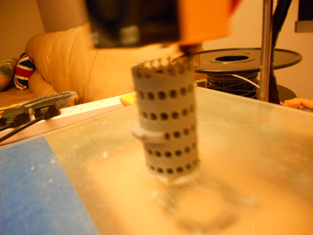

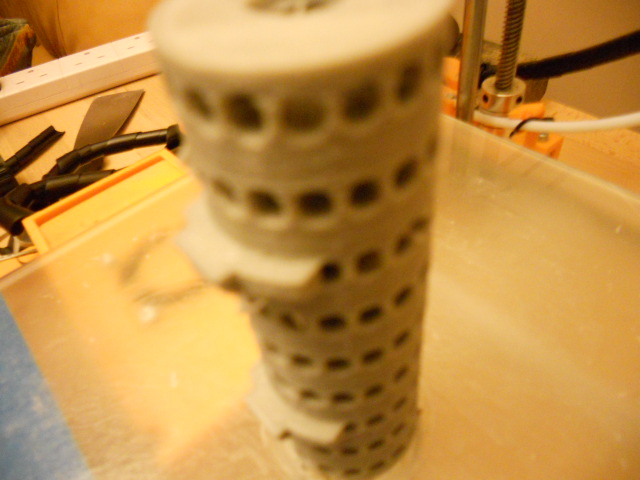

3 hours into a 5 hour print, just using up the last of the filament on the reel, its touch and go as to whether there is enough there to complete the exhaust...
