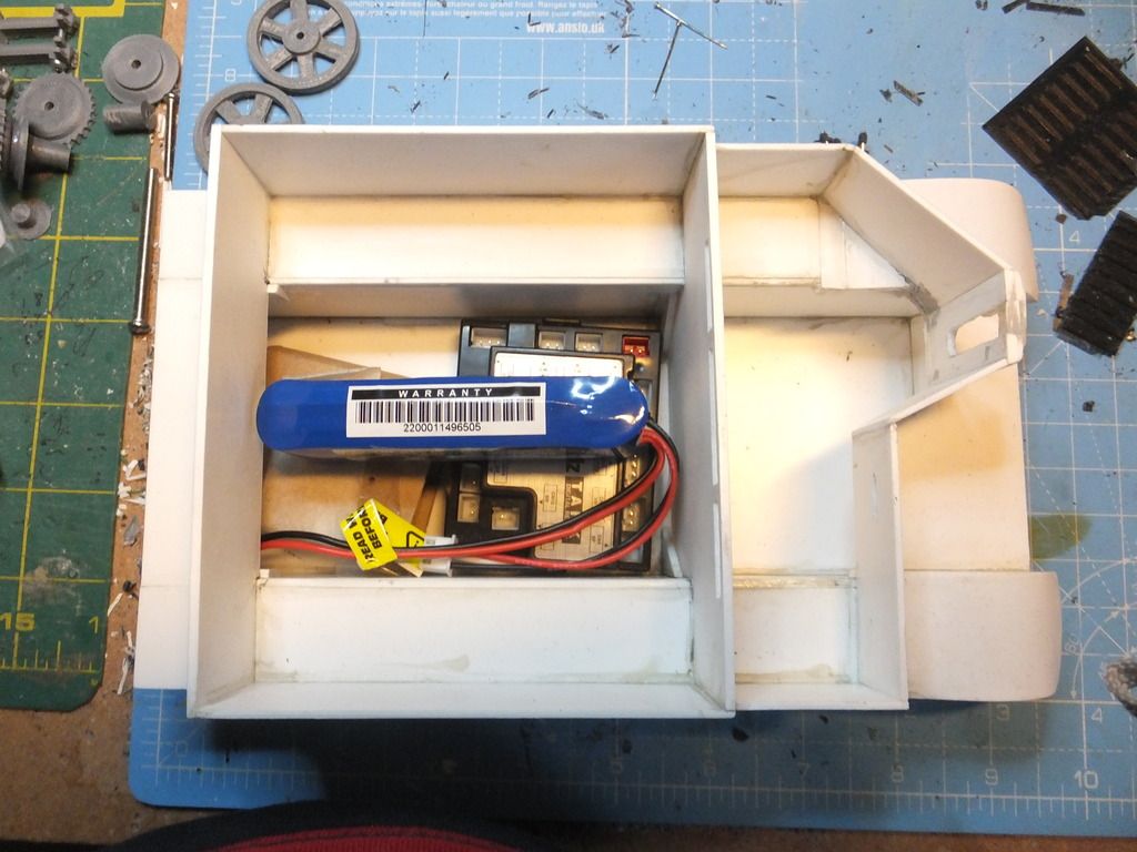

More pieces have arrived and construction progresses.

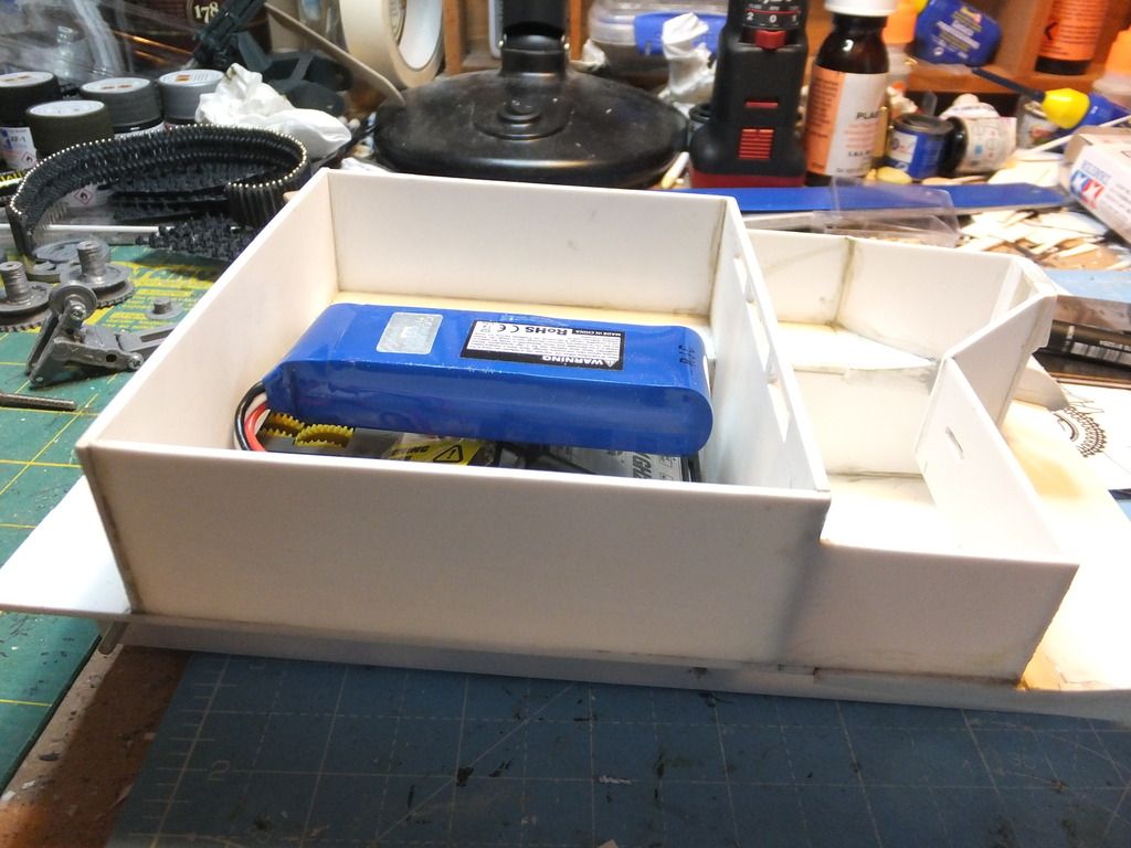

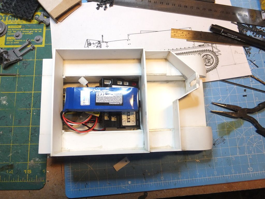

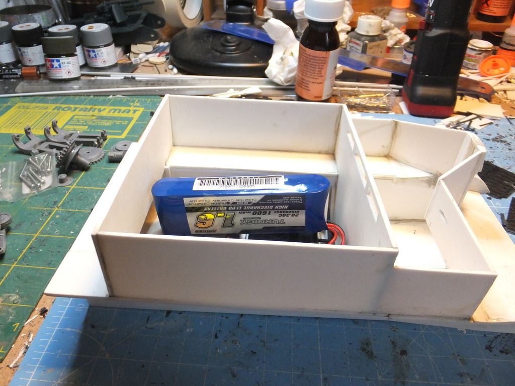

The mini LIPO battery has arrived and is a perfect fit. I'll have to change the power plug as I can't find a mini LIPO female plug anywhere except the states, so I will change to mini tamiya plugs which are readily available.
As you can see it will fit where the engine cover goes. I will just have to build a small rack to hold it clear of the MFU and Motors as the battery will probably get warm when running.

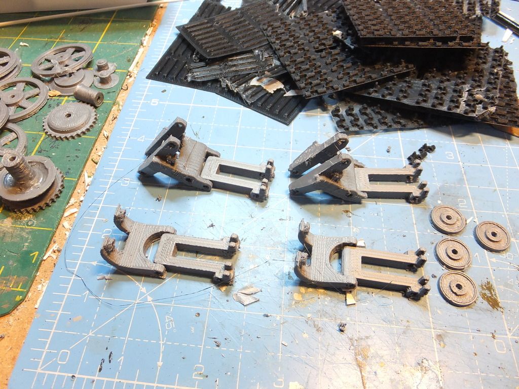

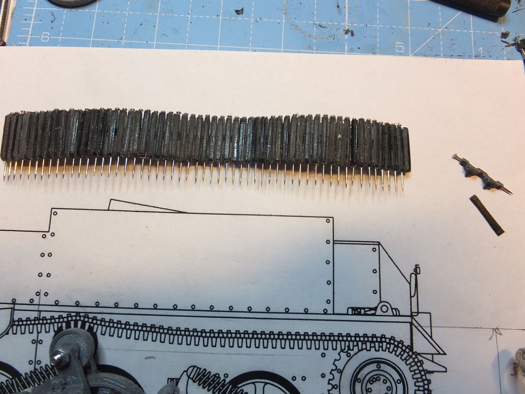

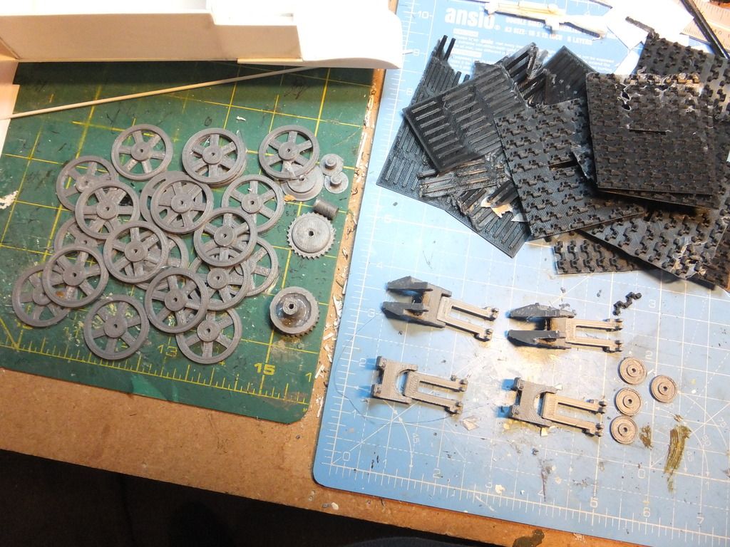

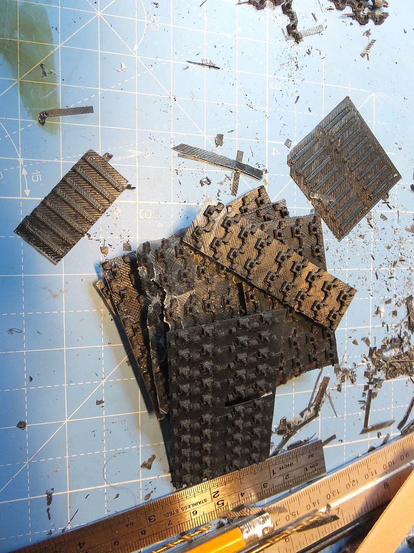

I have made/assembled 55 track links so far and at the moment this is quite a slow process and initially error prone resulting in some wastage. I will need 185 links per track so that shoiuld keep me amused for a while. You can see the link elements on the right consisting of the link and the pad which get glued together. The link contains holes for the pins but these need to be drilled out with a 1mm drill as they are slightly rough from the printing process. The pad and linked are glued together with styrene solvent, cleaned, and assembled with a bit of nip and tuck to get a smooth fit.
the raw material looks like this
And many thanks to Woz for the many excellent pieces that he has produced for me. :clap: :clap: :clap: :thumbup:

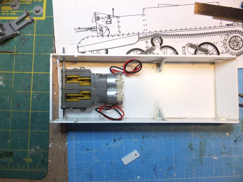

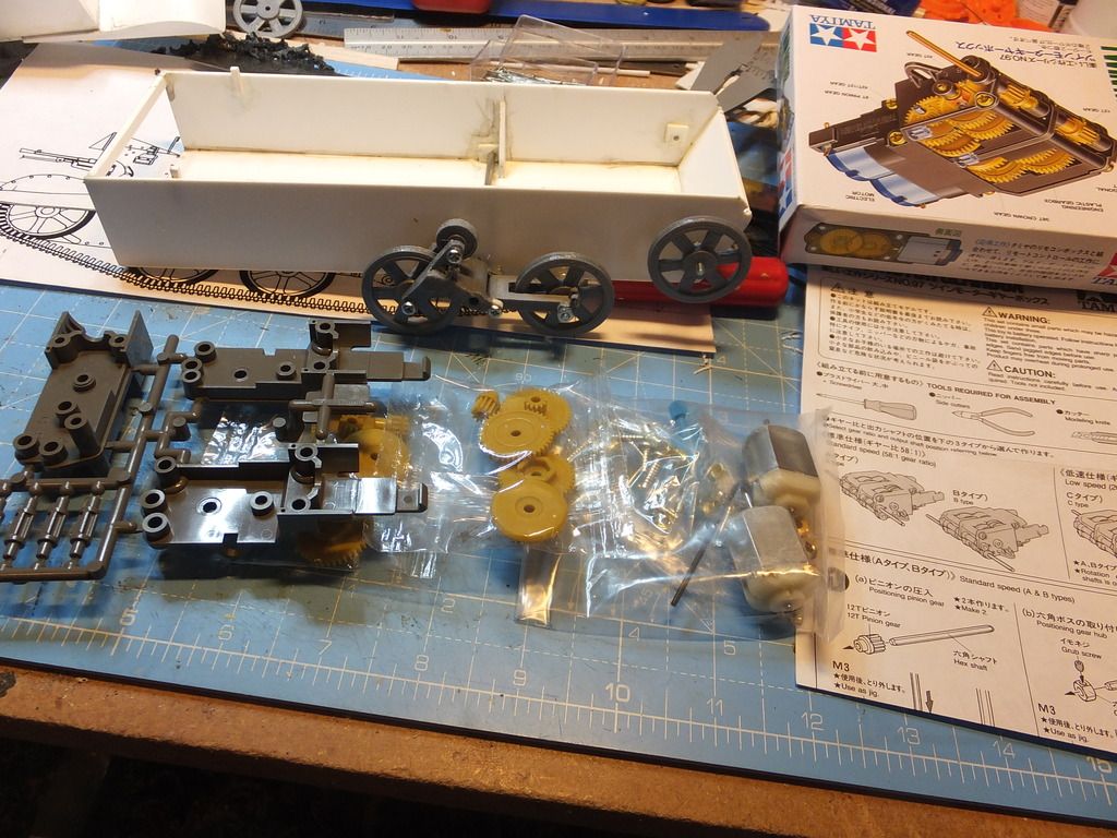

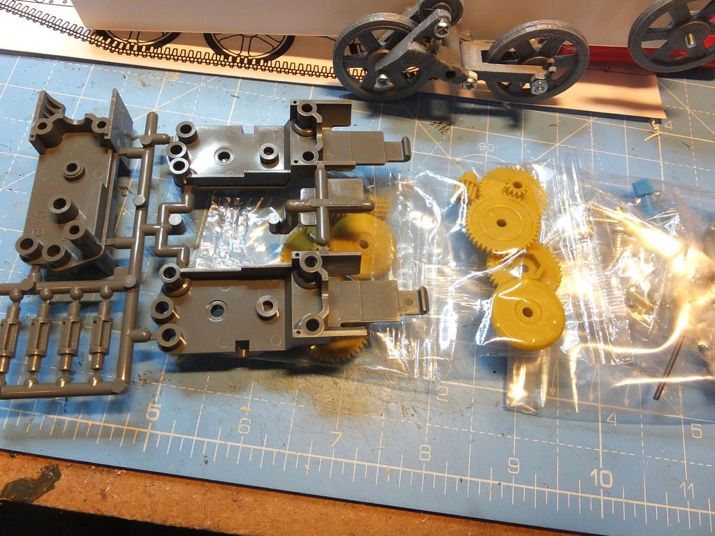

More goodies have arrived. The Tamiya twin motor/gearbox arrived from Oz (the cheapest place including postage and only took 10 days - awesome!). It's a diy kit so that is about to challenge my assembly skills and patience, judging by the tiny size of some of the components and the japanese instruction manual.

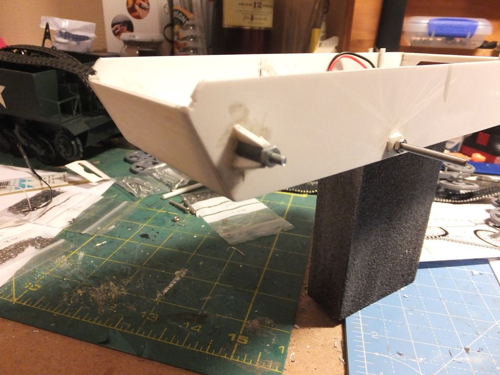

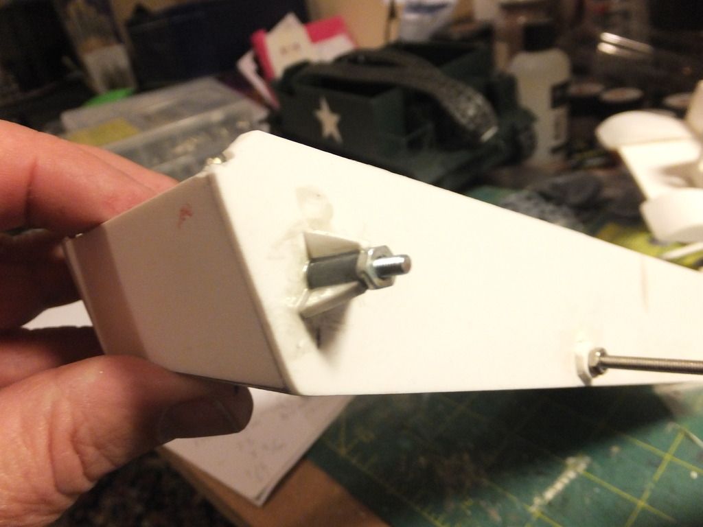

Those following the build will see that the front suspension and front wheel have been positioned and work started on the reinforcing for the mountings. All the nuts/bolts are M2.5 with the exception of the front suspension mounting bolt which will be M3 (because you can't get M2.5 in the lengths I need and also M3 will give better strength/stability).
More detail on the motors/gearbox parts - you can't see the really tiny parts in the pic.
More detail on the strengthening, the bar currently in place is only being used to correctly align the reinforcing and will be replaced by M3 bolts
The gearbox/motors are slightly larger than anticipated, I maybe looked at a different version for sizing so a bit of nip and tuck will be needed fitting everything in.

Progress report - we have motors!

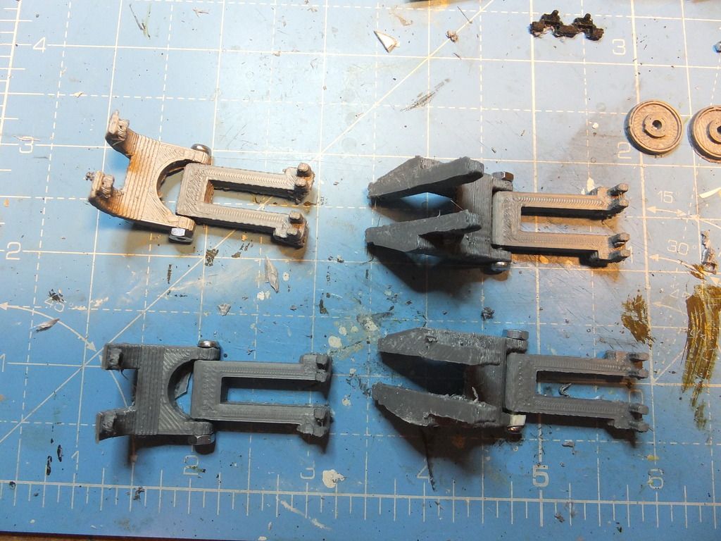

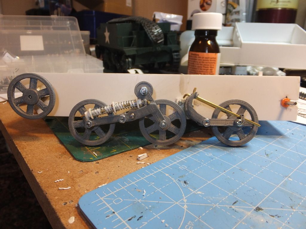

The motors were finicky to put together and the diagrams were quite obscure but I managed to sort it out eventually. The motor/gearbox unit is quite heavy so I will have to beef up the rear suspension. Everything still fits but it's going to be a squeeze.

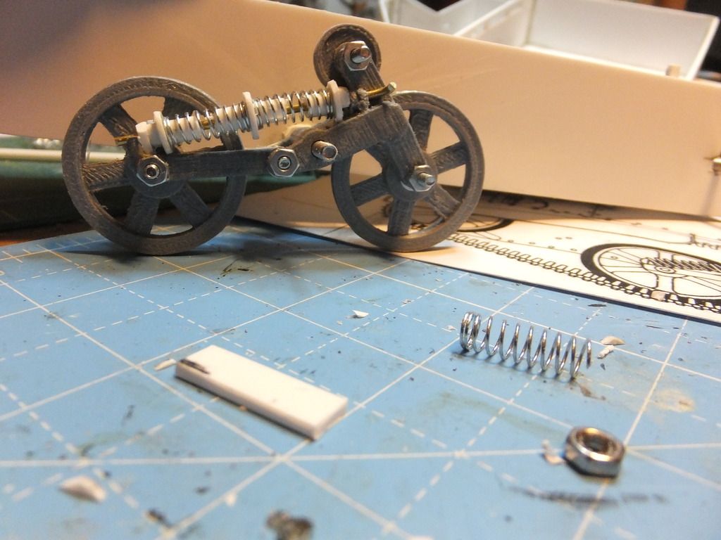

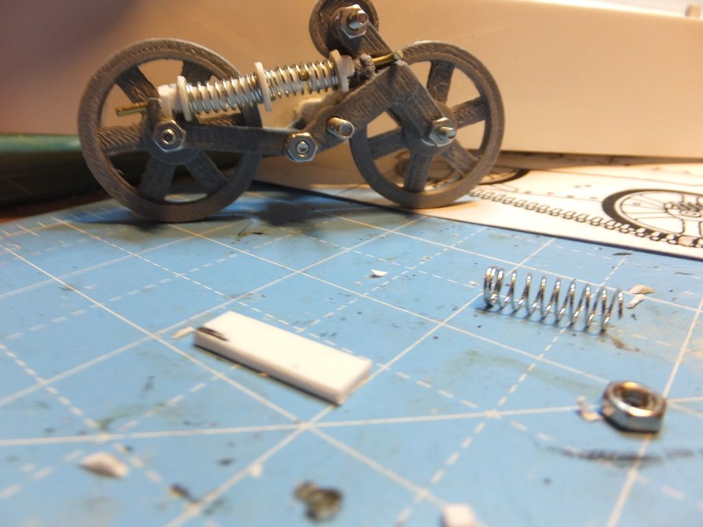

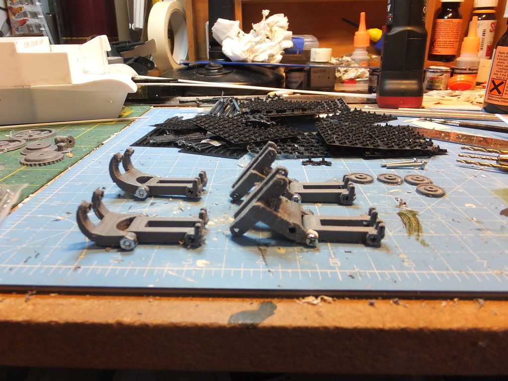

I've now started assembling the suspension and created the first spring unit, tried it and it works quite well although I may have to fit beefier springs.
uncompressed
and compressed
Now to manufacture more springs. :thumbup: :wave: Alwyn

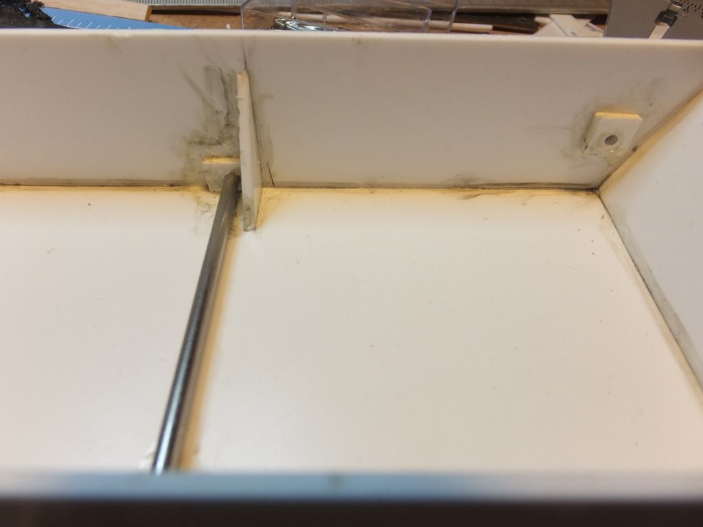

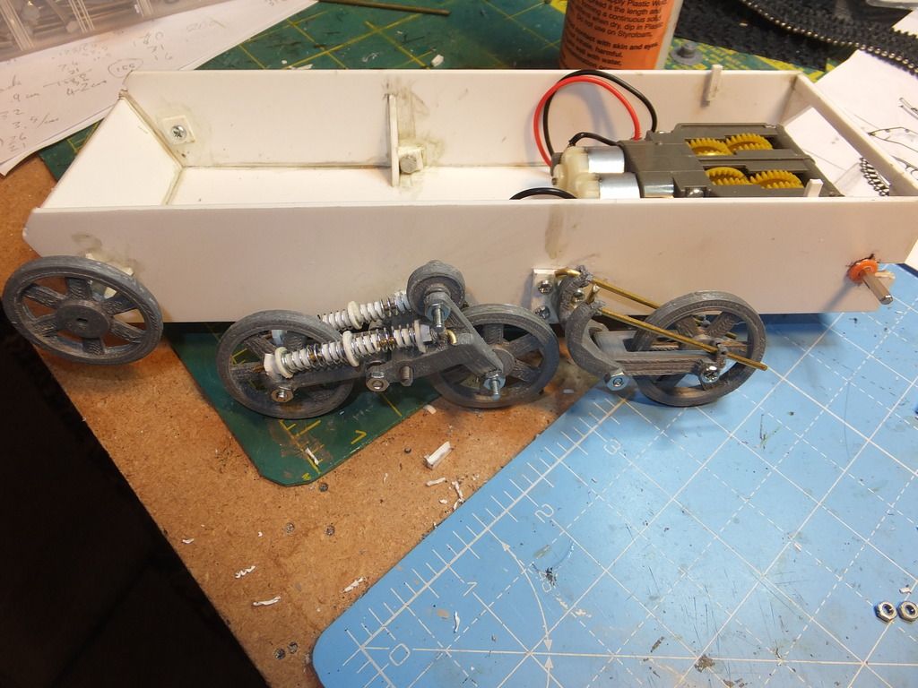

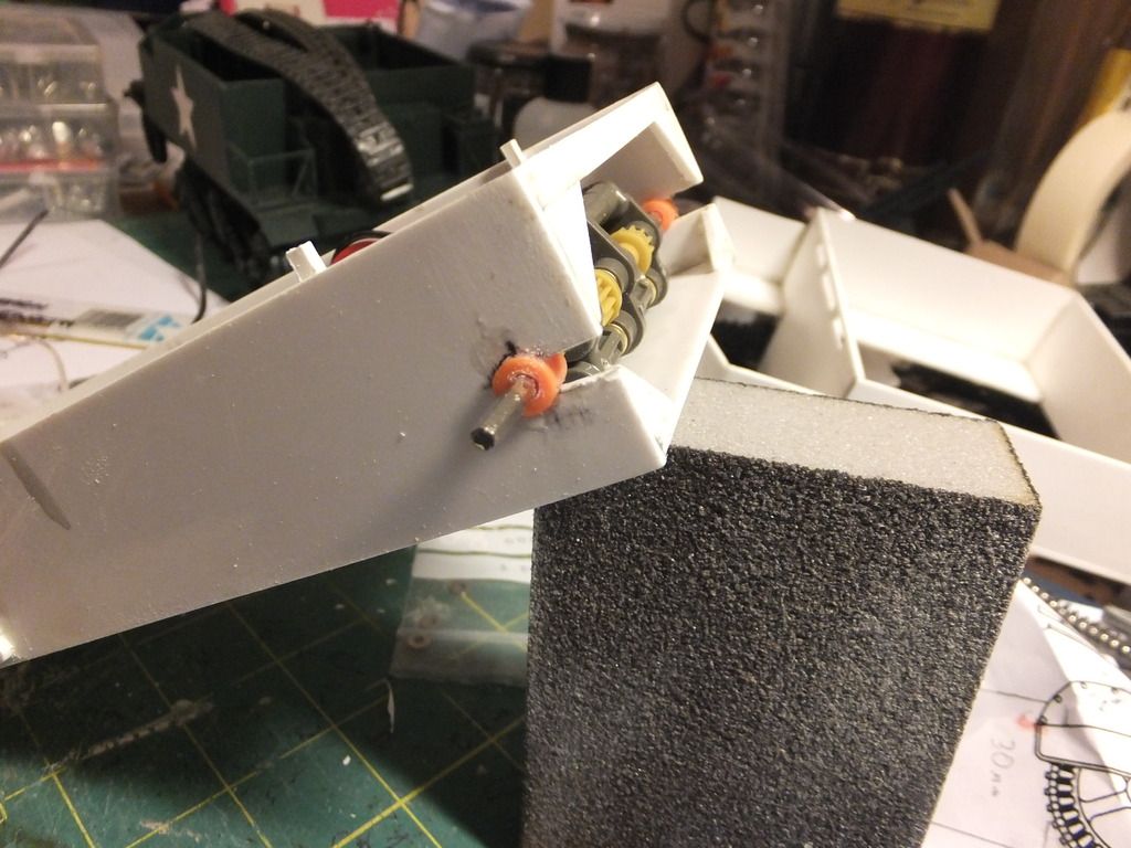

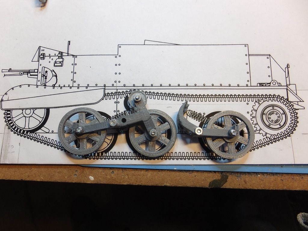

Progress on the suspension, with nylon bushes fitted to the drive shafts as they aren't very sturdy. I also strengthened the rear part of the chassis.
Made front wheel mounts to provide a solid mounts, these will take some stick from driving over rough terrain. I'm awaiting delivery of longer M2.5 bolts.
Fitted the rear suspension and made sure everything lined up
I'm bolting everything together as I don't like using screws as the threads eventually strip and I'm sure there will be a lot of adjustment and maintenance on this model. next is the drive sprocket and springs for the rear suspension.
:wave: Alwyn
